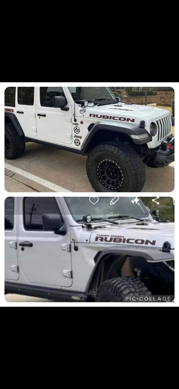

I also don't know if it really makes a notable difference when you have the black Rubicon factory fenders. Because i put a clear lens on the side of my lights so its all clear now,. It realy makes a difference if you have the white fenders it looks so much better. Do yall think it is worth doing it if you have black fenders ? I don't know because i cant do it myself so with the chop and lights and front and rear inner liners its going to cost me $2000 to have it done. Do yall think its worth it or put the $2000 toward new fenders like Metal cloak or Fab tech but they mount lower so it looks like i would loose some wheel well. ? Both of those would cost me around $4000with inner liners and labor but i would have new fenders not just the same fenders spending $2000 what do you think i don't know if i could do it myself i could save about $1000 labor but i cant do it. My Jeep is the top one in the photo see have i have the clear lens. Do really think a chop like below it on that Jeep will make that big of a difference for $2000 ? I don't know if it is worth it. I just wish i could find some white fenders but i do have the black top. Story for the long post
