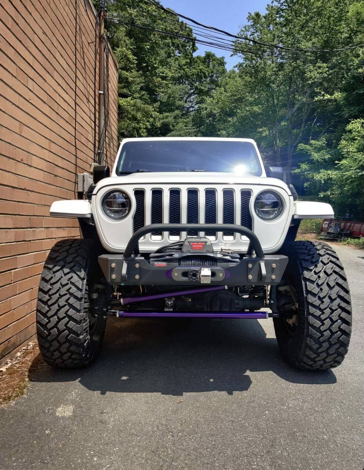

Both the quake kit and AAL kits say for Rubicon fenders only. Quake made a kit at one time for Sahara models. We put them on the wife's JLU. The difference in the fenders are the just the height and width. Her quake lights sit just to the inside of the fender on both sides. Not really noticeable unless you are looking for it. Picture attached.

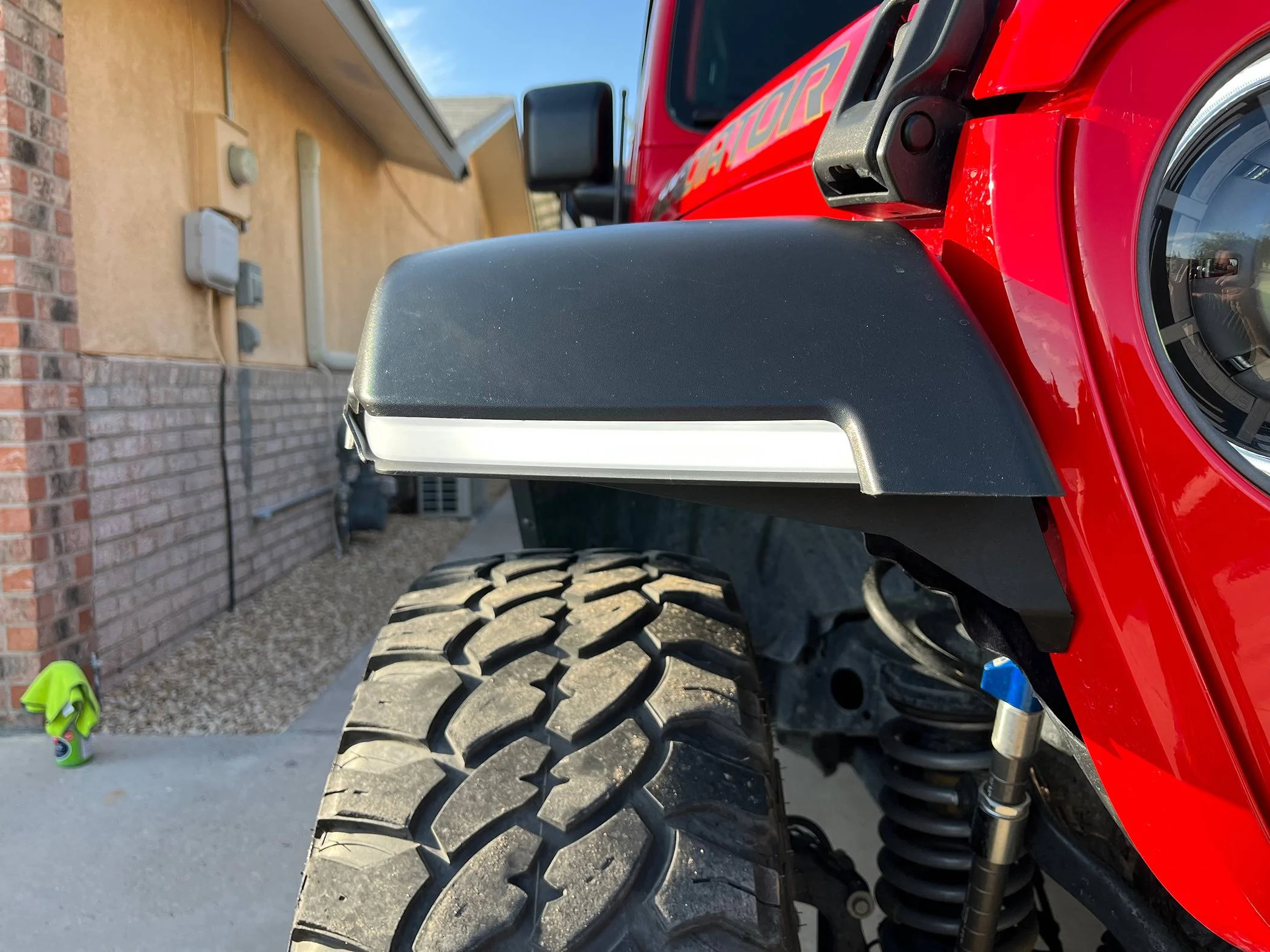

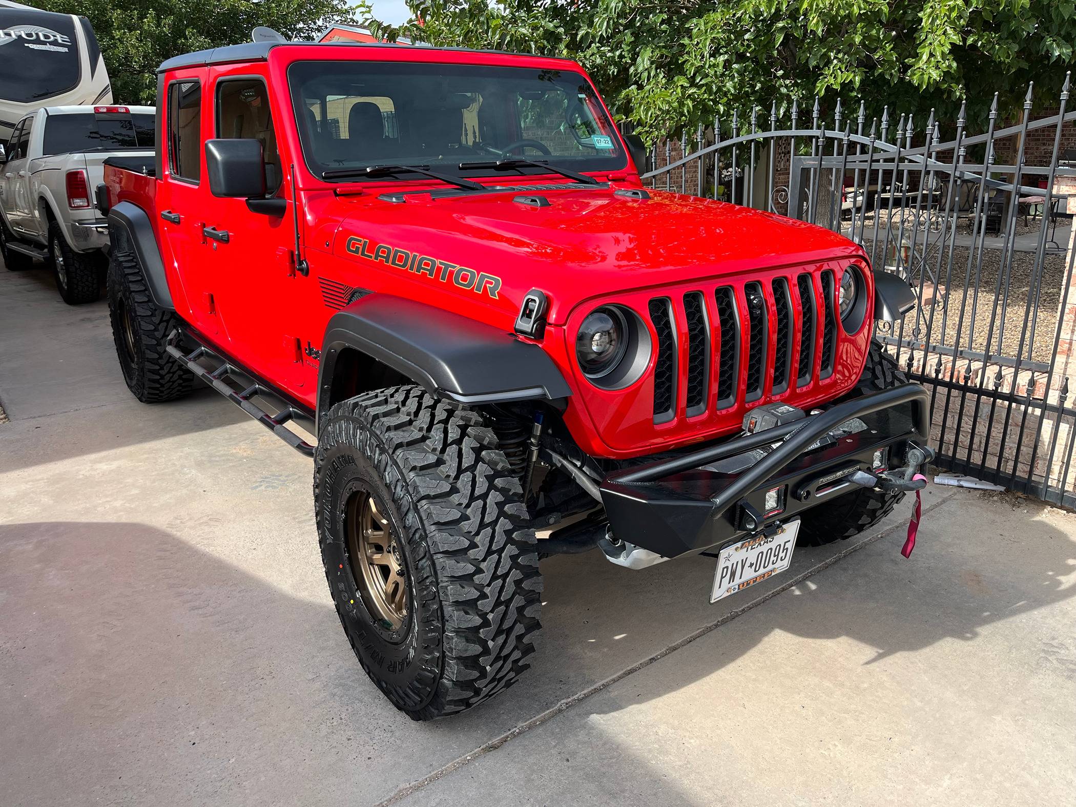

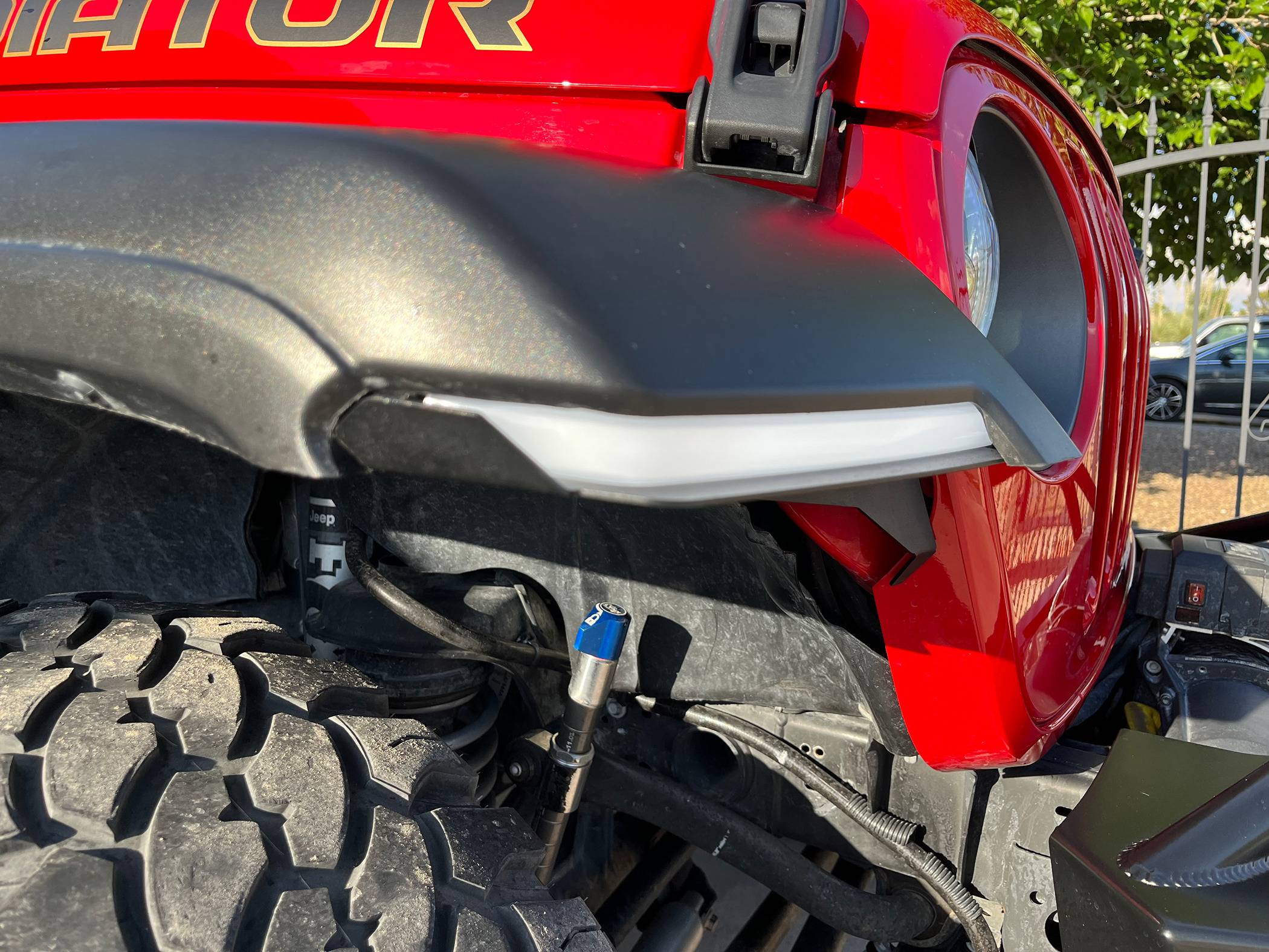

Are your flares 1 piece or 2 piece? On the base Sport models, they're 1 piece, and CANNOT be chopped easily. Looking at some High Altitudes, it looks like they're painted versions of the 1 piece flares.
While there are some fender chop kits for the low mount fenders, they need to be the 2 piece design.
I had a Rugged Ridge chop kit on my 1 piece Sport flares, but I had to cut them up with a Dremel to make it work. And they didn't look right to be honest. Only kept them for 2 months.
