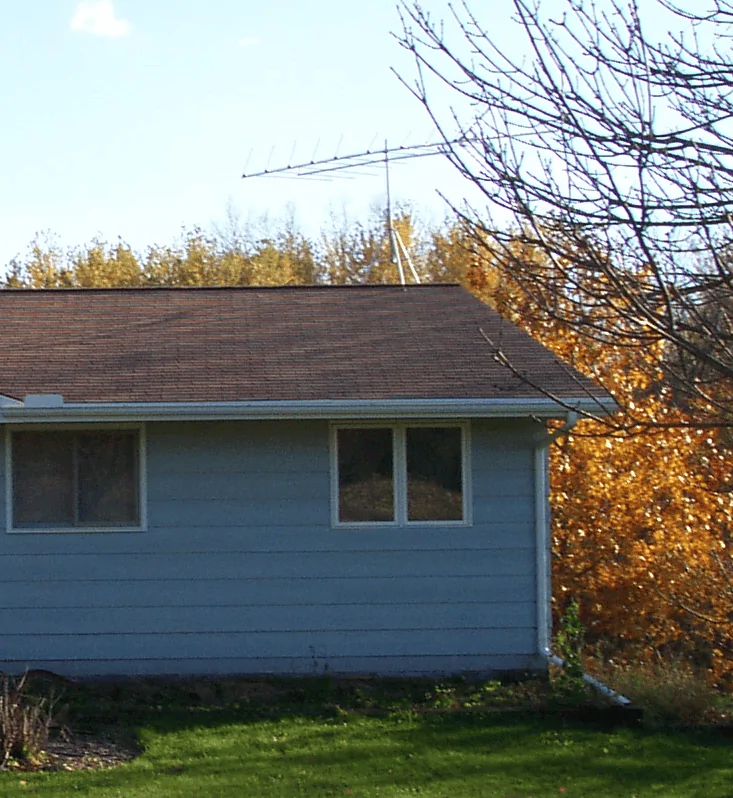

It's already above the peak of the roof by at least 5 feet.
Still doesn't say anything about best antenna, amp/splitters, etc. which is the original question I guess no one knows about.

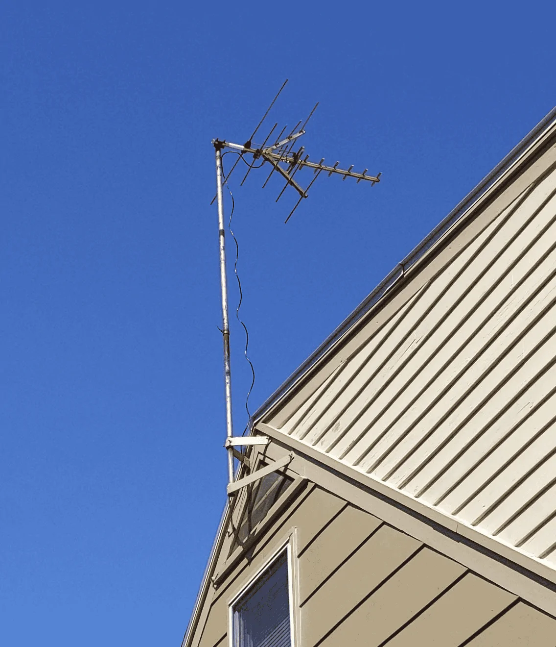

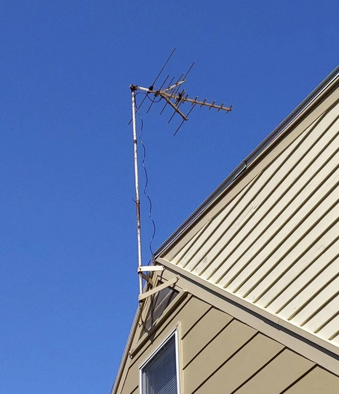

Old pic from about 20 years ago but gives an idea of how high it is already. This is a prior antenna, current one is at least a foot, maybe even more, higher as I used a longer pole.
Jeep Gladiator best rooftop TV antenna? 1680921027757
If you are still using the same type of antenna, you only need half of it now. Mine used to look like that until the switch to digital, then I cut off the half no longer needed. Don't know if that will help your reception or not.
