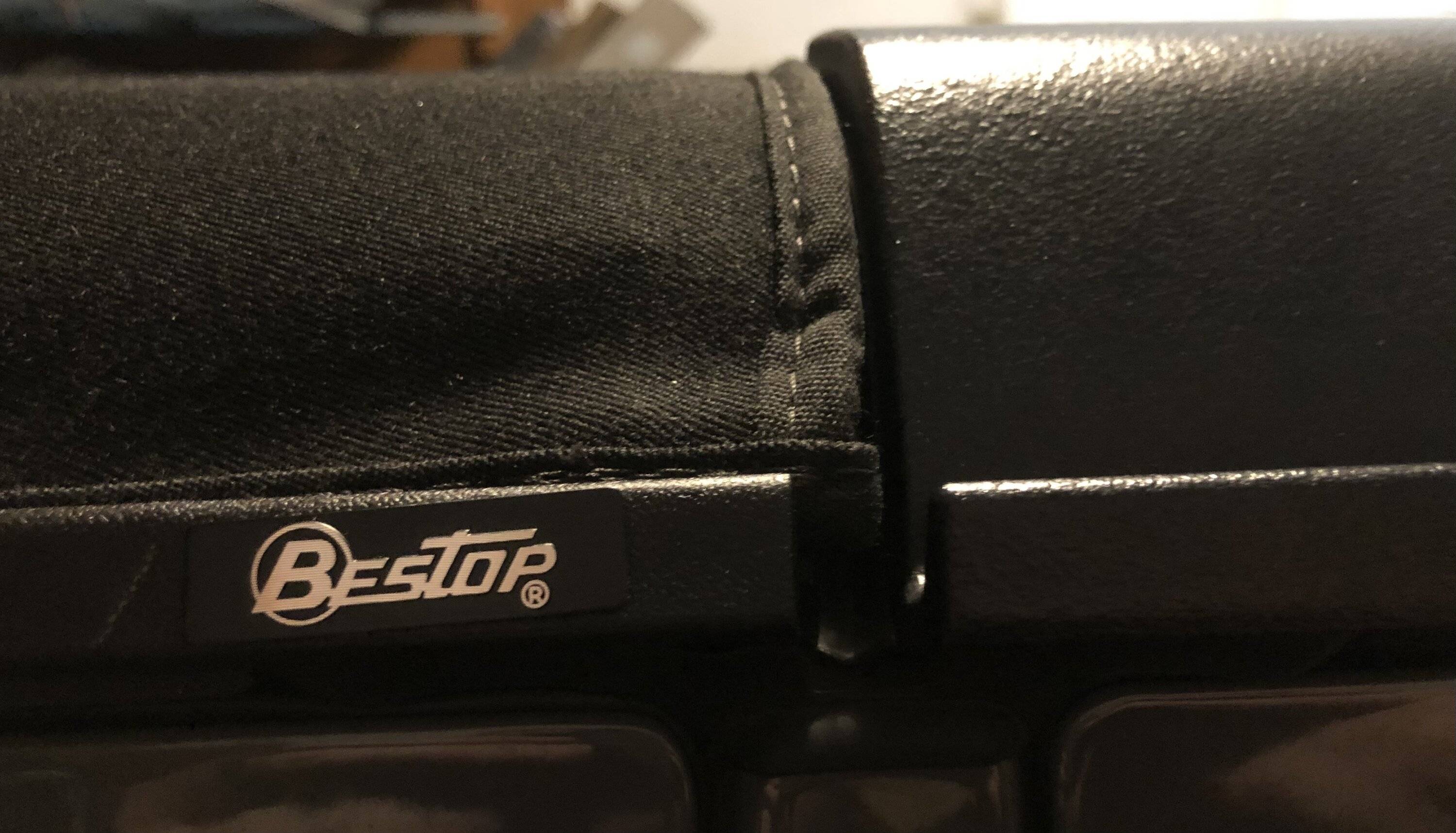

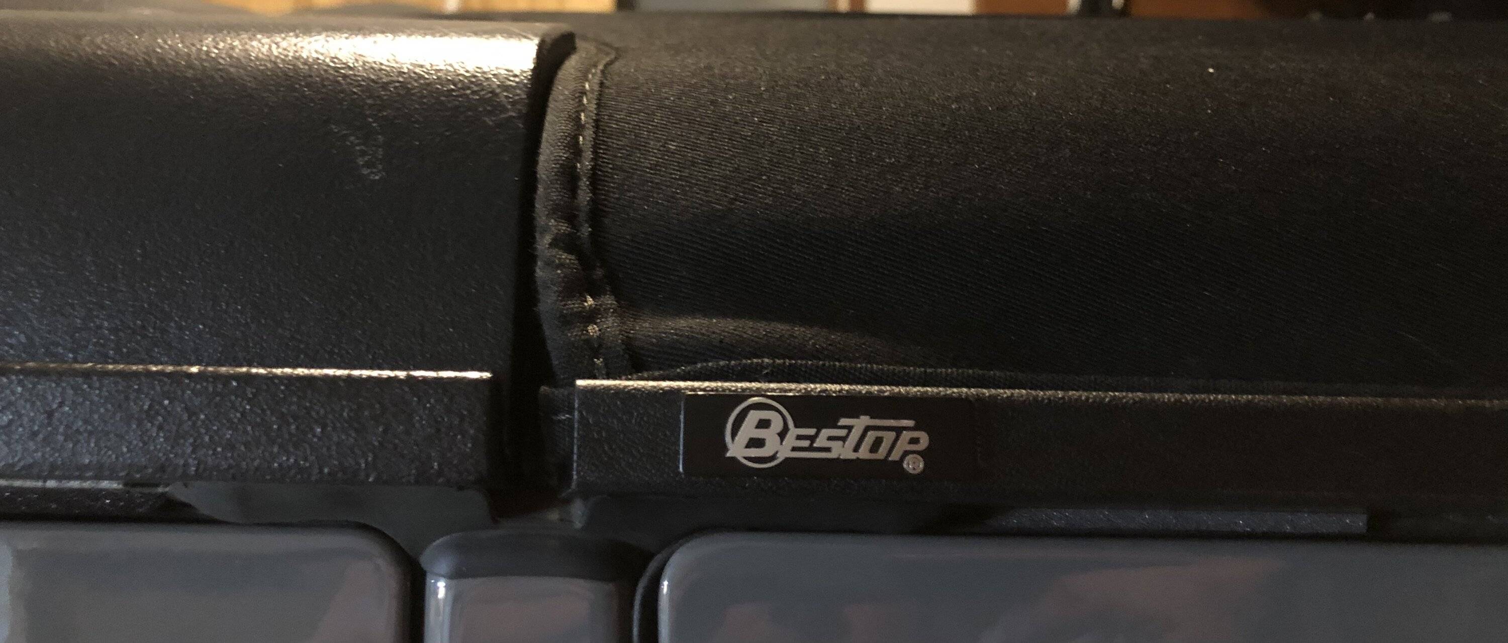

Just installed mine tonight. I’ll just say that I wish I’d found the Quadratec install video first.
Anyways…got it all together, double-checked everything to make sure that the z-clips were set and the rear edge of the deck was tucked.
On that ^ last part…I THINK I got it right. Everything tightened down well, the latches are secure, there are no funky looking seams, and the top is quiet (not hearing any whistling or other possible indicators of a leak).
That being said…I do have a question for those that have installed these. Does the rear portion/deck tuck look right to you here?
If so…I will probably hose it down good this weekend and check for leaks. Thank you.
On that ^ last part…I THINK I got it right. Everything tightened down well, the latches are secure, there are no funky looking seams, and the top is quiet (not hearing any whistling or other possible indicators of a leak.
That’s what mine looks like. I believe you are good
It’s not a huge deal, but it can be adjusted to look better. The idea is to have it assembled on the keep, but with the hardware loose. Then tighten each bolt one at a time, checking for the wrinkle.
Ok, I took my time tightening them up, but I didn’t know to look for that as I went. The next time I’m puttering in the garage, I’ll loosen everything up and see if I can’t work that wrinkle out a bit. Thank you.

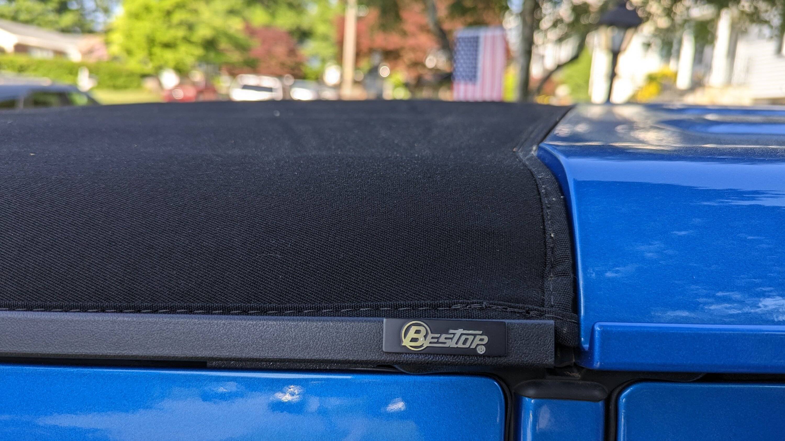

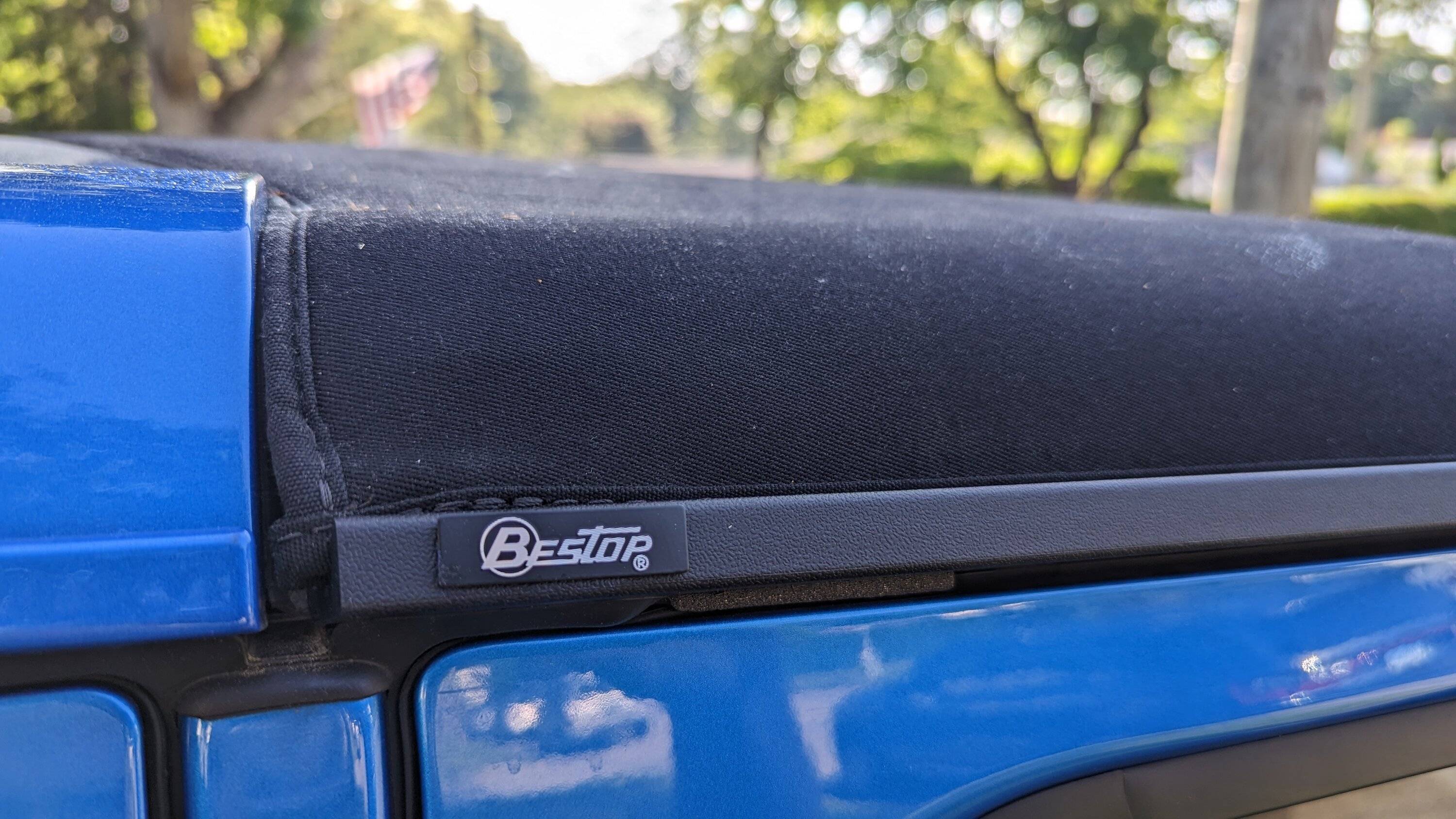

It might even stretch out a bit once it gets wet but looks pretty good to me.
