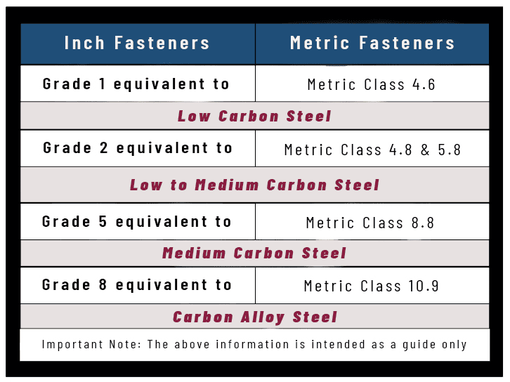

FYI: Grade 8.8 metric is not the same as grade 8 english.
It's actually about the same hardness as your typical hardware store grade 5.

Yeah, there's a lot of confusion on bolts, metric vs. SAE, hardness, some equate that to brittle (mistakenly).
Class 8.8 is similar to grade 5. It's zinc plated for moderate corrosion resistance. A tempered medium carbon steel.
For tensile strength the grade 5 is actually higher than class 8.8
