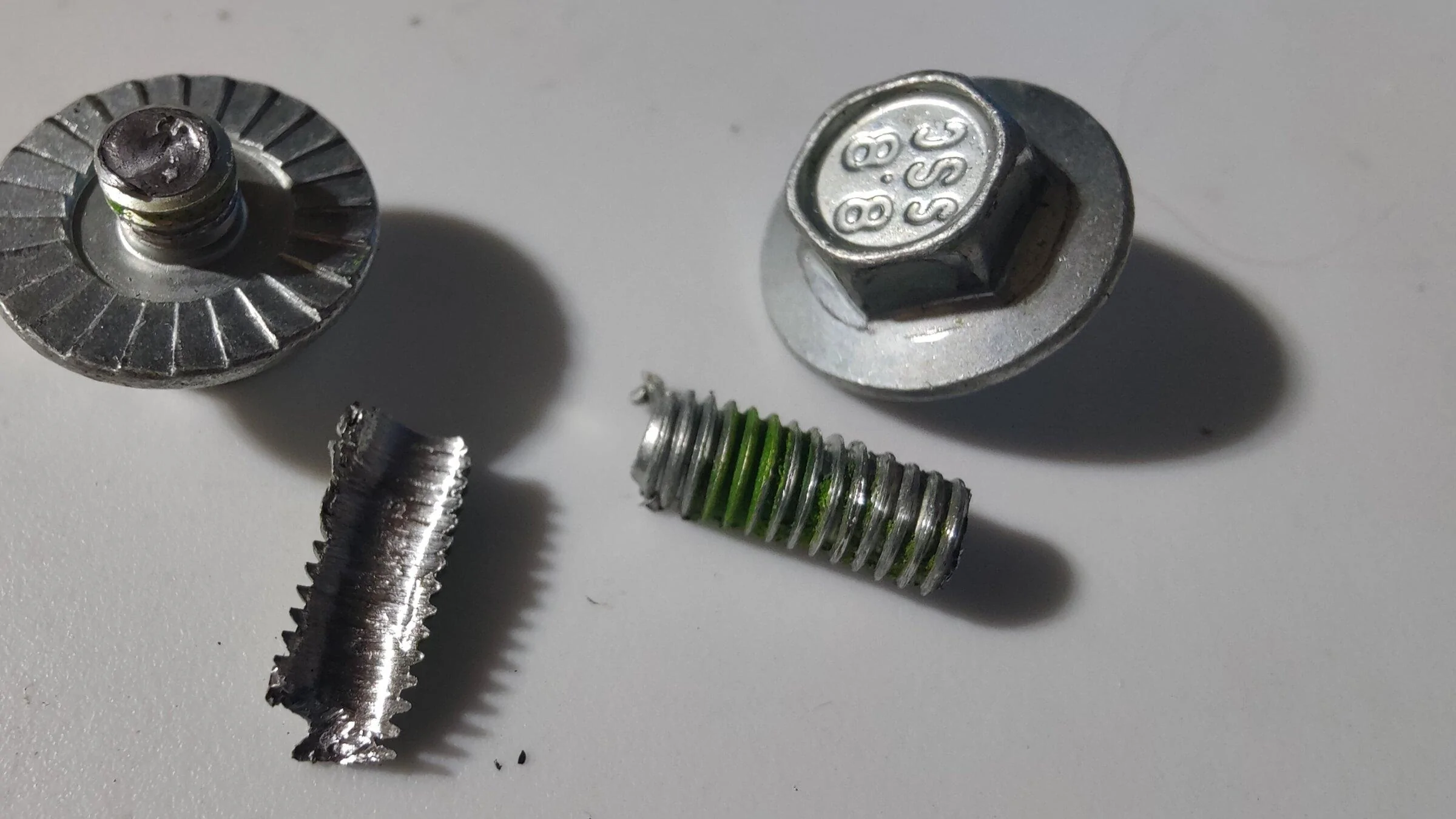

Not sure if it's going to be an issue for other folks but wanted to give folks heads up on removing the windows bolts on a 2021 JTR
Was doing a proximity door sensor install today, not a huge job buy when I can around to removing the 2 10mm window bolts they both snapped right off with my small Ryobi impact driver.
The damn bolts were so damn tight that they were likely glued on... There was some greenish residue.
Best part is that they used grade 8.8 bolts that are inside a $10 plastic bracket... Absolutely no point to do that but making it a total bitch to drill out.
Easy outs didn't work. I managed to get on bolts out, the other drilled larger.
Anyways, a 30min job turned into a 2h pain in the ass.
Green loctite.

Dang! I would have been in a major panic had that happened to me. I did use a short ratchet only, though (if you give me a tool with leverage, I will inevitably use it for harm). I did manage to break the cast metal carrier that holds the door handle cap somehow during the job. I have absolutely no idea how, I just heard the "tink tink tink" of something metal falling in the door when I closed it after finishing the job. That lead to digging back in, and a bunch more headache, and finally paying the dealership to replace that cast metal piece and put it back together.

Ended up taking the door liner out again and just putting a regular bolt with a small nut on the back side... Thing isn't going anywhere...

I had no issues at all. I did mine in a unheated dark garage that was about 28-30 or so degrees, all hand tools. I won't use "impact drivers" on anything like that.
I watched a video on doing the work before I did it mostly to see how things were arranged and what gotchas might be because my garage is dark (and cold - had space heaters running so I could warm my fingers up now and then.
Once I got into it, I found hand tools to be more than adequate and it didn't really take a ton of time other than getting things to come apart after taking those bolts out - it didn't want to let go.
I also seem to recall skipping a step or two on the second door........ didn't take good notes, though.
I had a much worse time working inside other doors and adding power windows and locks to other cars - switching these over was really a snap.
If I had one piece of advice for anyone doing this - keep the power tools in the drawer - at least until the screws are loose enough. They are great for show in a video but honestly, I don't believe they have a place in fasteners with any locking method like Loctite. I'd rather work them slowly back and forth until they are loose then run them out. The kicker is that with hand tools sometimes it goes faster as you don't have to mess with broken stuff.
FYI: Grade 8.8 metric is not the same as grade 8 english.
It's actually about the same hardness as your typical hardware store grade 5.
