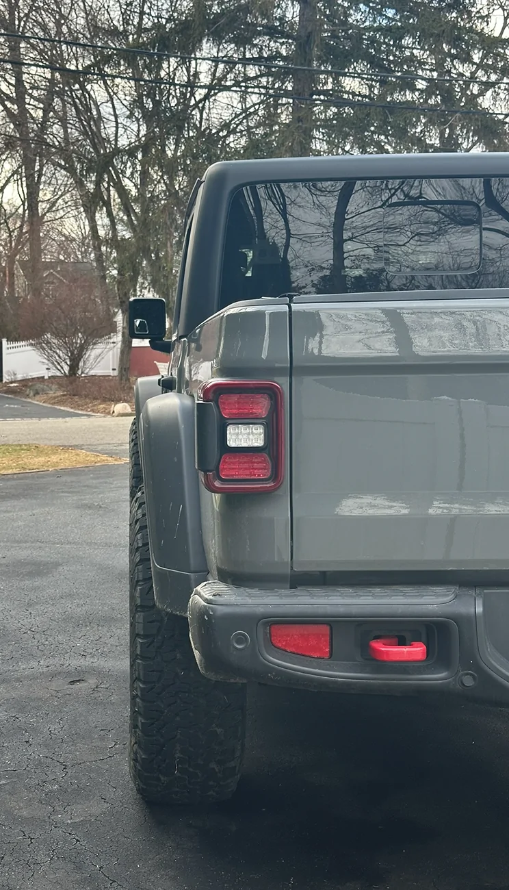

Hi all, long time lurker first time poster. Here's some info on my current setup, I hope it helps someone make an informed decision. This forum is full of great info, hopefully this adds to it.
Vehicle is stock height 21 Rubicon, no lift.
BFG KO2 37x12.5 R17 Load Range C
Method 703 Matte Black 17x8.5 +25/5.78"

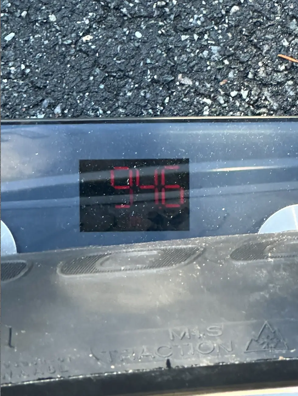

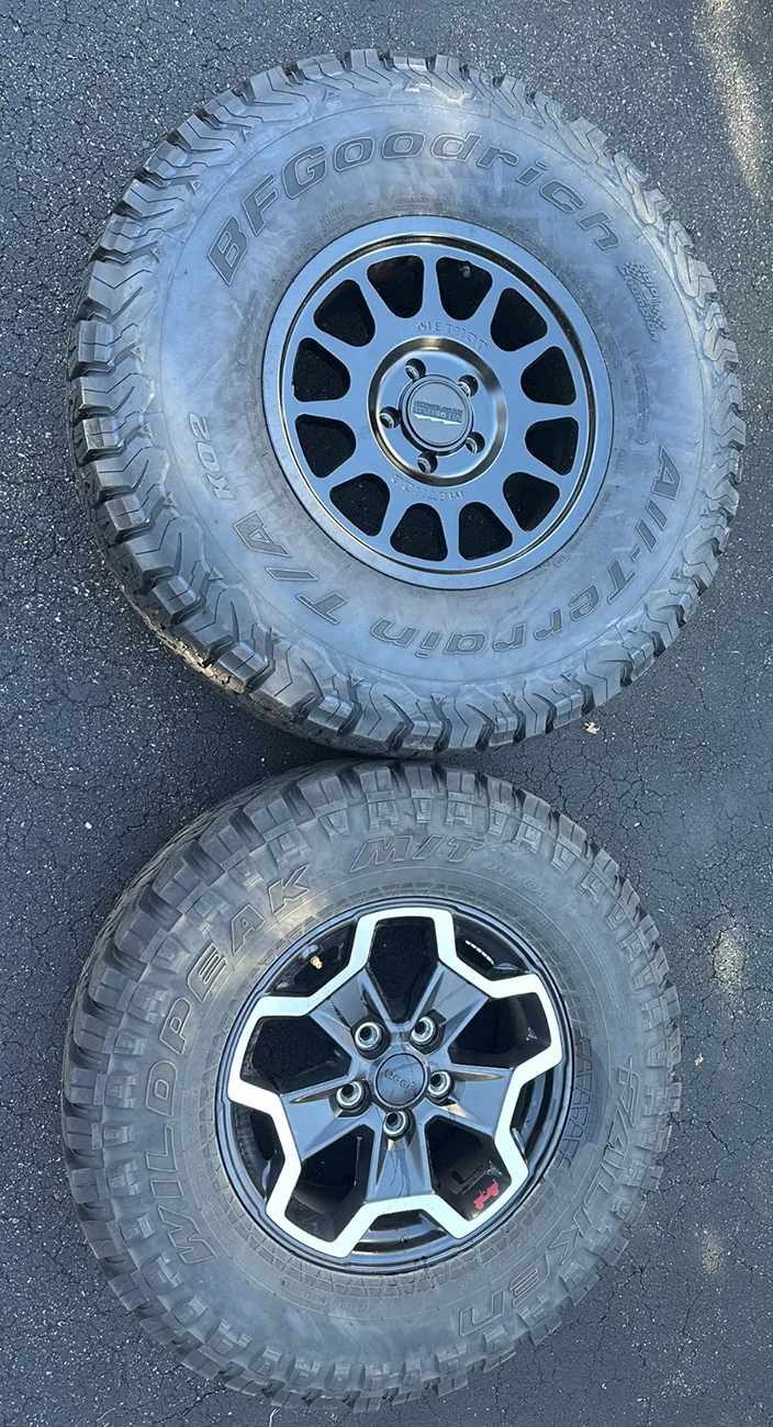

Wheel and tire weigh 94.6lbs according to my bathroom scale. For reference, my stock rims and tires (30,000 miles 11/32 tread) weigh 84.4lbs.

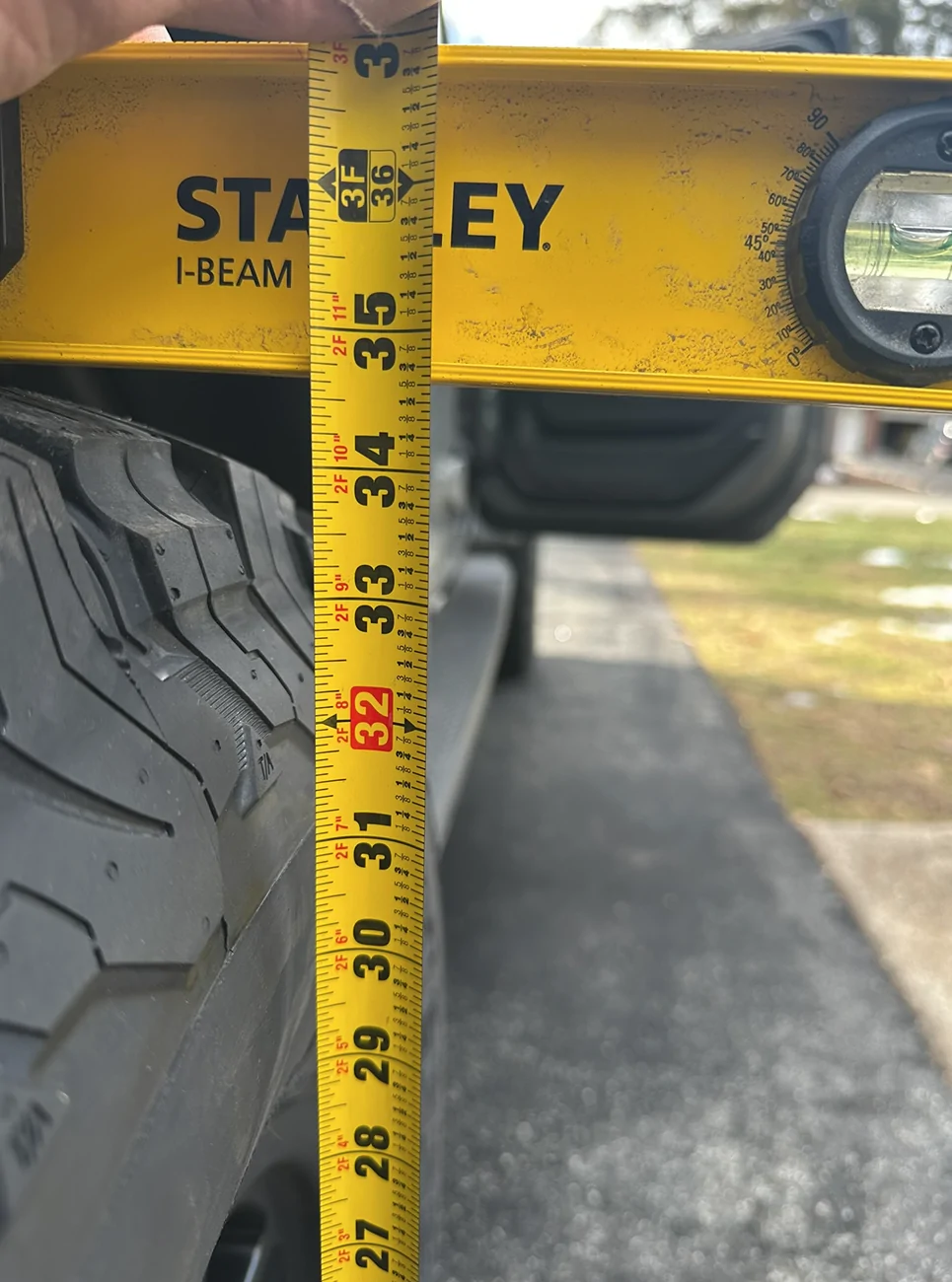

Height of Tires is 34" 5/8th measured at 37psi from center of tire/wheel. (apologies camera was crooked but level was level)

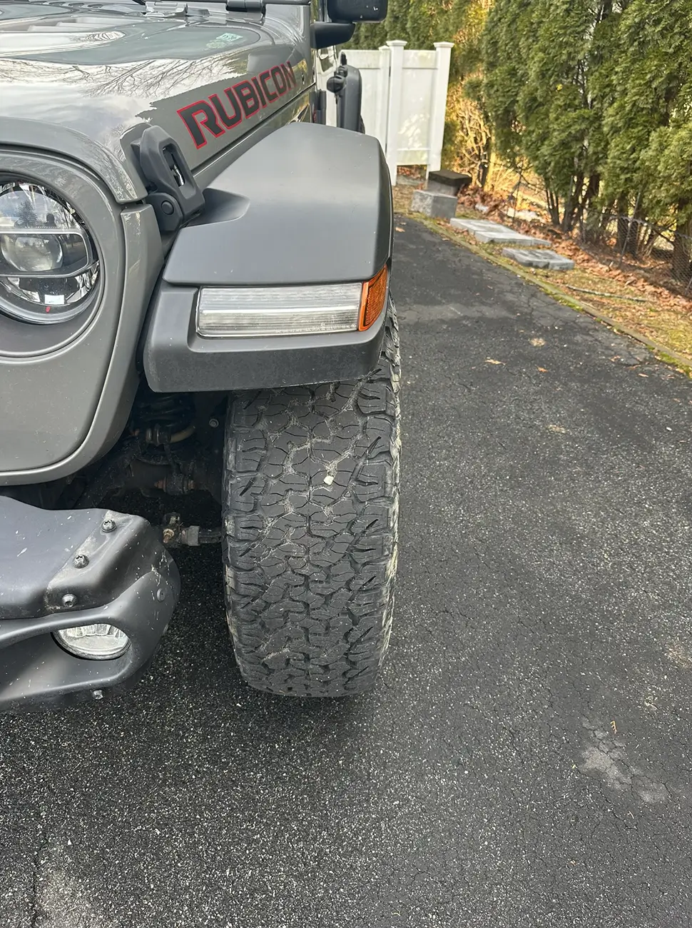

Poke is about 1" all around, stock Rubicon flairs

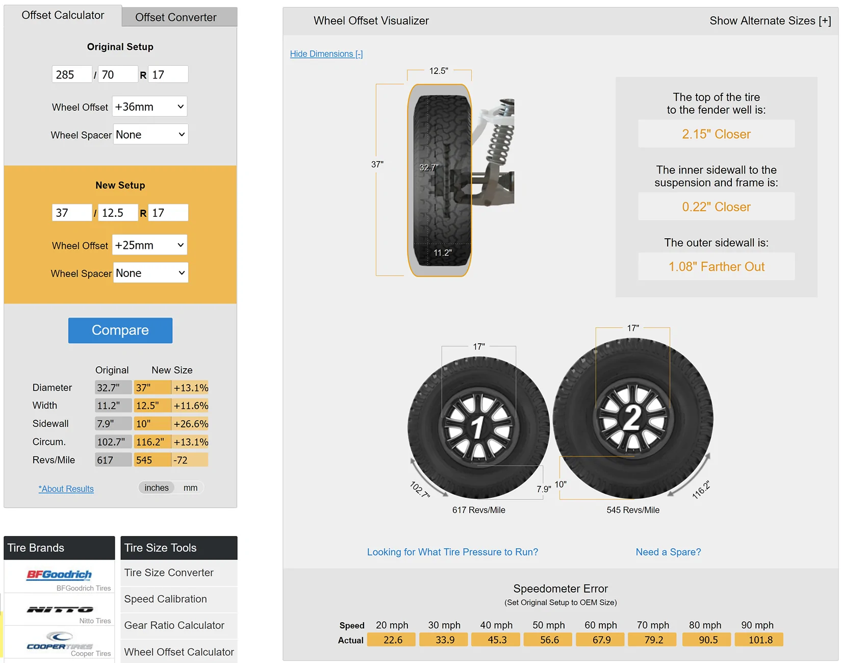

Assuming this info is nearly correct, here's the conversion chart from stock. I'm not 100% on stock wheel offset of +36mm, it's an internet number that I found.

Tazer mini set at 36.54 produces an accurate speed, checked at 50, 60, and 70mph with cruise control and a gps speedometer phone app.
Subjective driving impressions over the last 100 miles have been positive. The vehicle performance matches my preferred driving style, which is slooow. i'm about 50/50 local and highway, avg'd 17.5 mpg the last few days of mixed driving. The steering feels very similar to stock. I actually can't feel a difference. The vehicle was starting to wander a bit on the highway on the stock falken wildpeak MT's, and now the wandering is much less pronounced, almost negligable except for heavily crowned roads. Upon inspection of my stock tires, they show signs of over inflation wear (band right down the middle), which could have contributed to the wandering. They were also starting to get louder. These KO2's are usually quiet when new and the change is very noticable and much quieter. But that's an old M/T compared to a brand new A/T, so YMMV. The increased size of the sidewalls defintely absorb the smaller bumps and potholes much better, making the ride less bumpy and more stable, almost feels like I got new shocks (I'm still on the stock fox shocks).
Transmission finds 8th gear at 60-65mph and cruises comfortably, doesn't hunt around for gears. I do not drive or accelerate aggressively (those days are long gone). I know in the back of my head that there has been a loss of power/performance due to +10lbs more wheel/tire weight, but for daily driving around town and on the highway, I perceive no meaningful impact to my driving style due to the bigger tire size & weight. If you accelerate hard or drive real fast, I'm sure there's a downside to going bigger/heavier that one would have to consider, but for me, it hasn't changed anything about the way I drive or expect the jeep to drive.

Jeep Gladiator BFG KO2 C 37x12.5 R17x8.5 +25 Method 703 Height, Weight, Poke vs Stock 001

Great info, thank you. I have almost the same model (minus the steel bumper and winch, which I'm working on adding). Those rims look great and are on my list for consideration. Can you clarify the tire height? The tape measure reads 34.75" but you said you set Tazer to 36.54". The latter makes sense for a 37 tire. Any issues with rubbing with the 37? Thanks again

Thanks I love the rim too. No rubbing on road, and the mild off roading I’ve done so far I haven’t had rubbing. I anticipate that I will rub on larger rock crawling without a lift/level, so I’m currently just leaving my sway bar connected off-road to limit articulation lol. Probably foolish but it makes sense to me.
The tire height is one of those measurements that can vary depending on the rim width, tire pressure, load index and sidewall stiffness, tire compound, and probably some other factors including marketing gimmickery. The same size KO2 mounted on a different rim might have a different height. I’ve found info of 37” KO2’s with very different heights. So I felt it was info worth sharing on this rim at that pressure.

This appears to be the rear tire. Do you also have the measurements for the front? I would like to compare that to my 35 K02 to see how much additional height I would actually get if I go with the 37s.
Sure, first thing tomorrow (it's dark and cold outside)

So. It measured at 35” at 37psi in the front. Which was confusing since it measured a 1/4” less a month ago. Same tape and level…So I measured the other front tire and same deal, 35” @ 37psi. I normally roll around at 32psi cold, but the tires weren’t cold, they were hot from riding on the highway. I usually see them at 36-38psi on the dashboard. The rears also measured 35” at 37psi. I’ll check them cold to see if they droop, or by how much

Thanks. So I just did some measurements 33 1/8 front and 33 1/2 rear and 11" to the bottom of the front diff. BTW PSI is 34. I am heavier than you with lots of MC parts and a winch. So give or take I would get about 1.5 inches clearance with the upgrade to the 37s. Are your tired C or D rated?
C load range, curb weight is 5660lbs currently with myself (190lb) and 3/4 tank fuel, just weighed in the CAT scale a few days ago.
