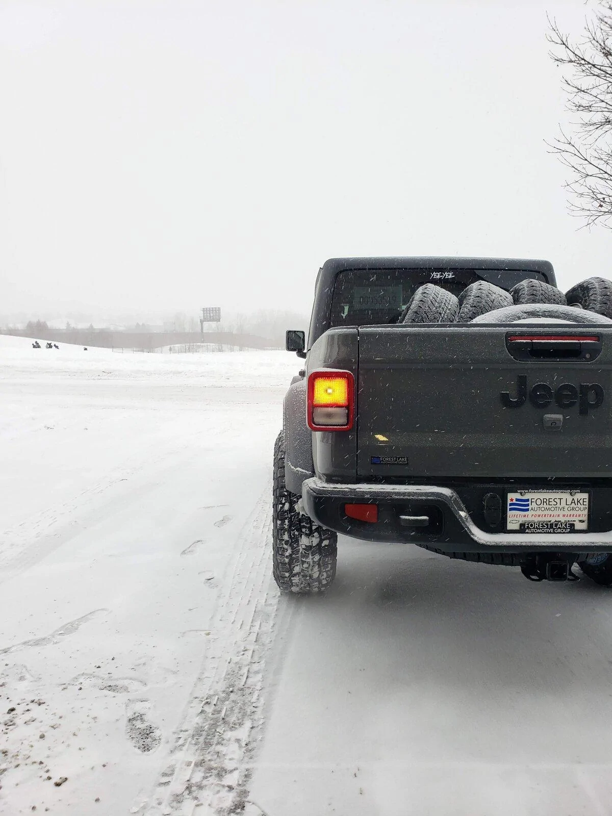

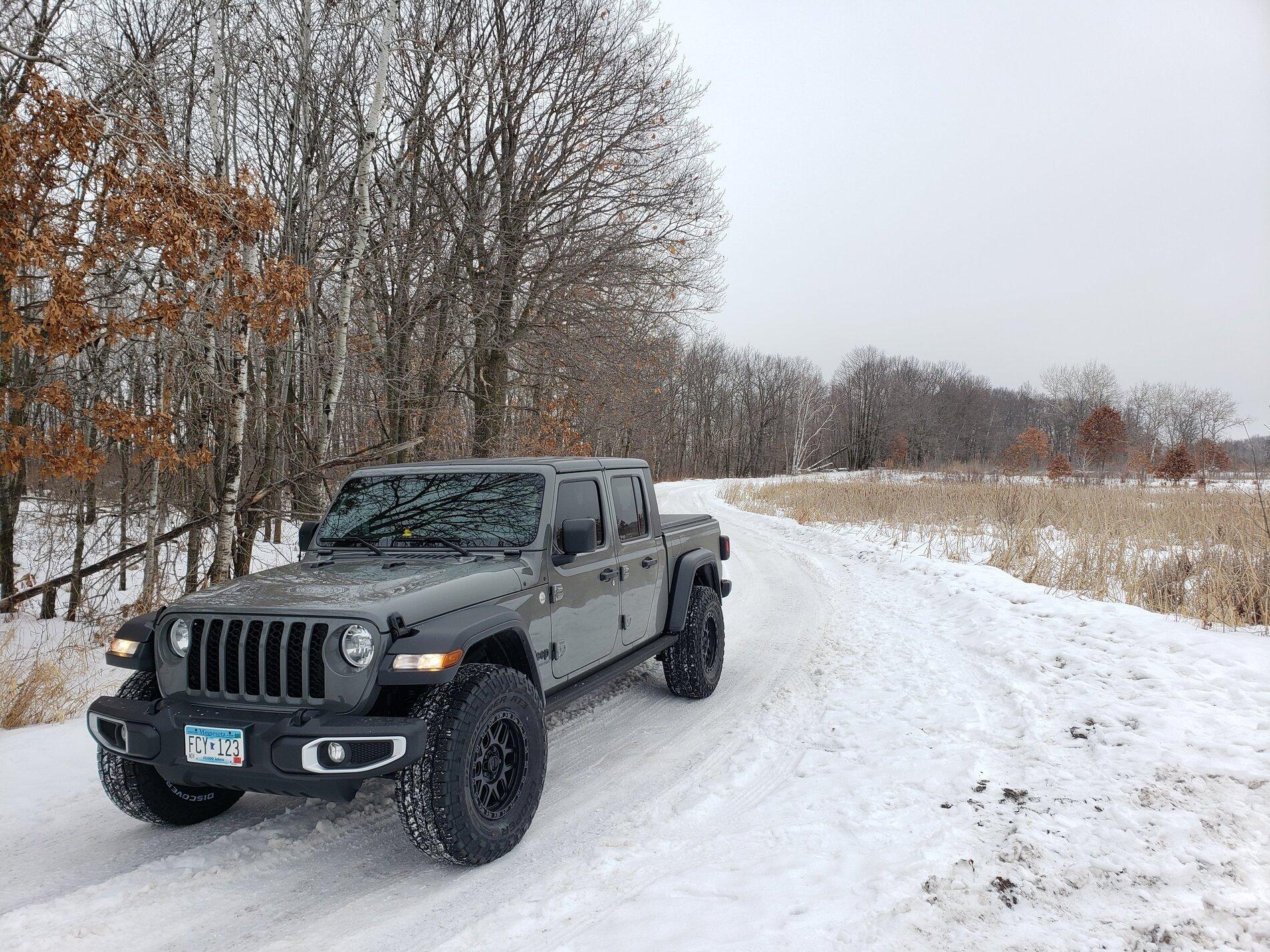

It's a bummer there aren't more options with a positive offset like that. I was looking at AEV and Method to get the +25, but ultimately ended up with a KMC 544 Mesa with a +18mm offset. (since it's only 1/4 inch different)
Sounds like the AEV wheels could have some wheel weight clearance issues with the caliper. If I remember right, the Method's bore was larger and required a hub ring to fit the Gladiator. Both not big issues, but something to consider.
I'm satisfied with the way the +18 looks and performs, but I think that +25 is probably the perfect setup.
Jeep Gladiator Method 703s with +25 offset. 20201229_154010
Jeep Gladiator Method 703s with +25 offset. 20210117_141914
