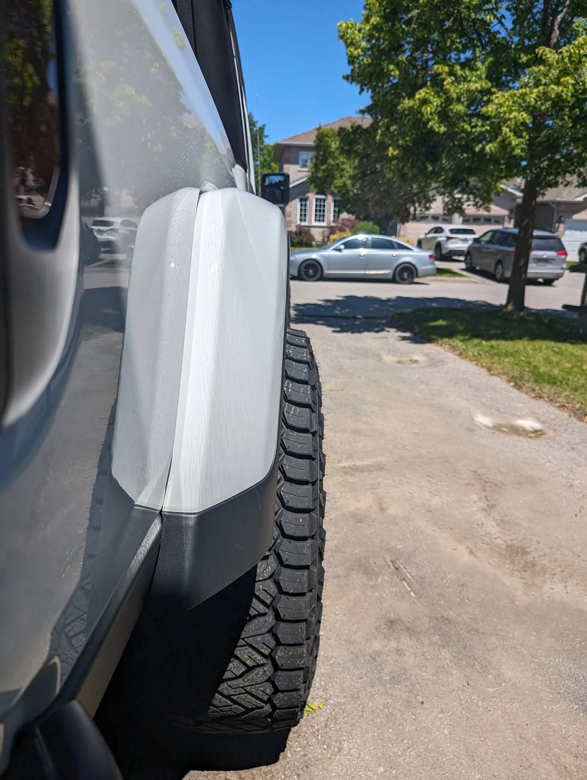

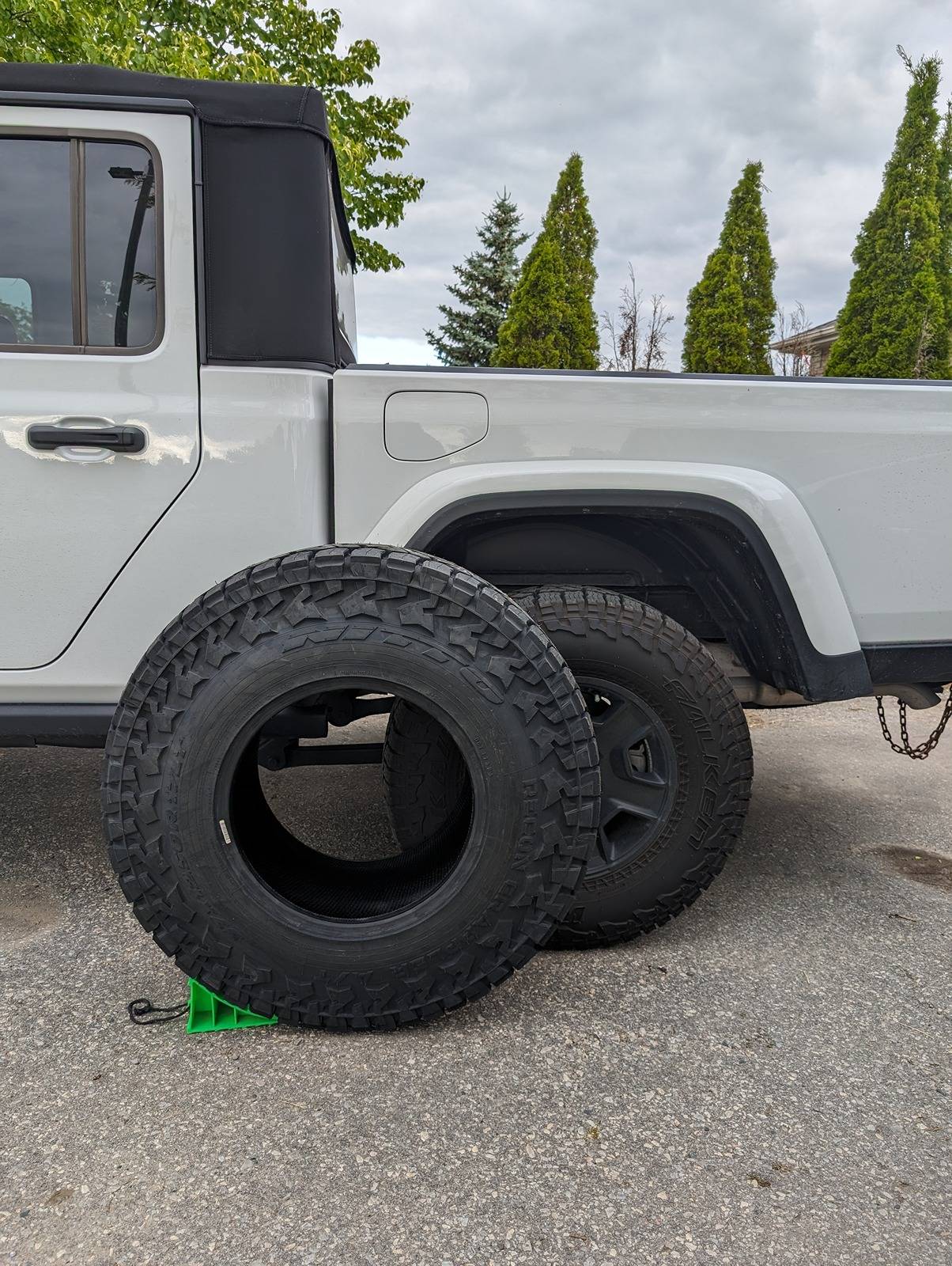

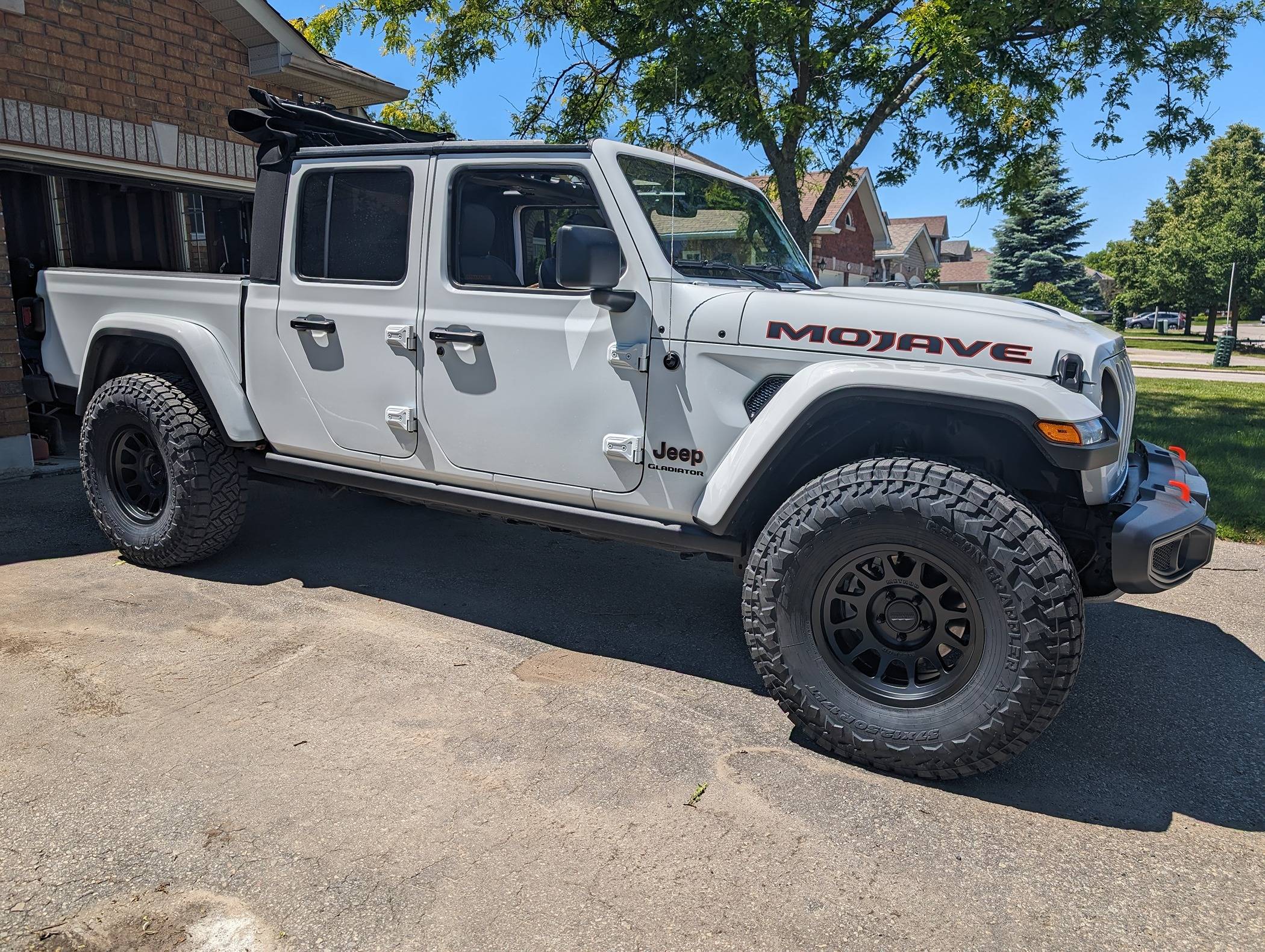

Is the poke illegal in Ontario or other concerns? Otherwise I just switch to -12 offset but on mickey thompson wheels. Bounced offroad with them a bit last weekend they're fine, not your size running 285/70 on them.
Just wanted to see what it looked like and if I liked how much poke there was. Also maybe ball joint issues down the line and my paint. If I keep them I'll probably put the recon fender extensions on to help out. I don't think there is an issue in Ontario with tire poke, every other redneck has about -3ft offset on their diesels up here 😁

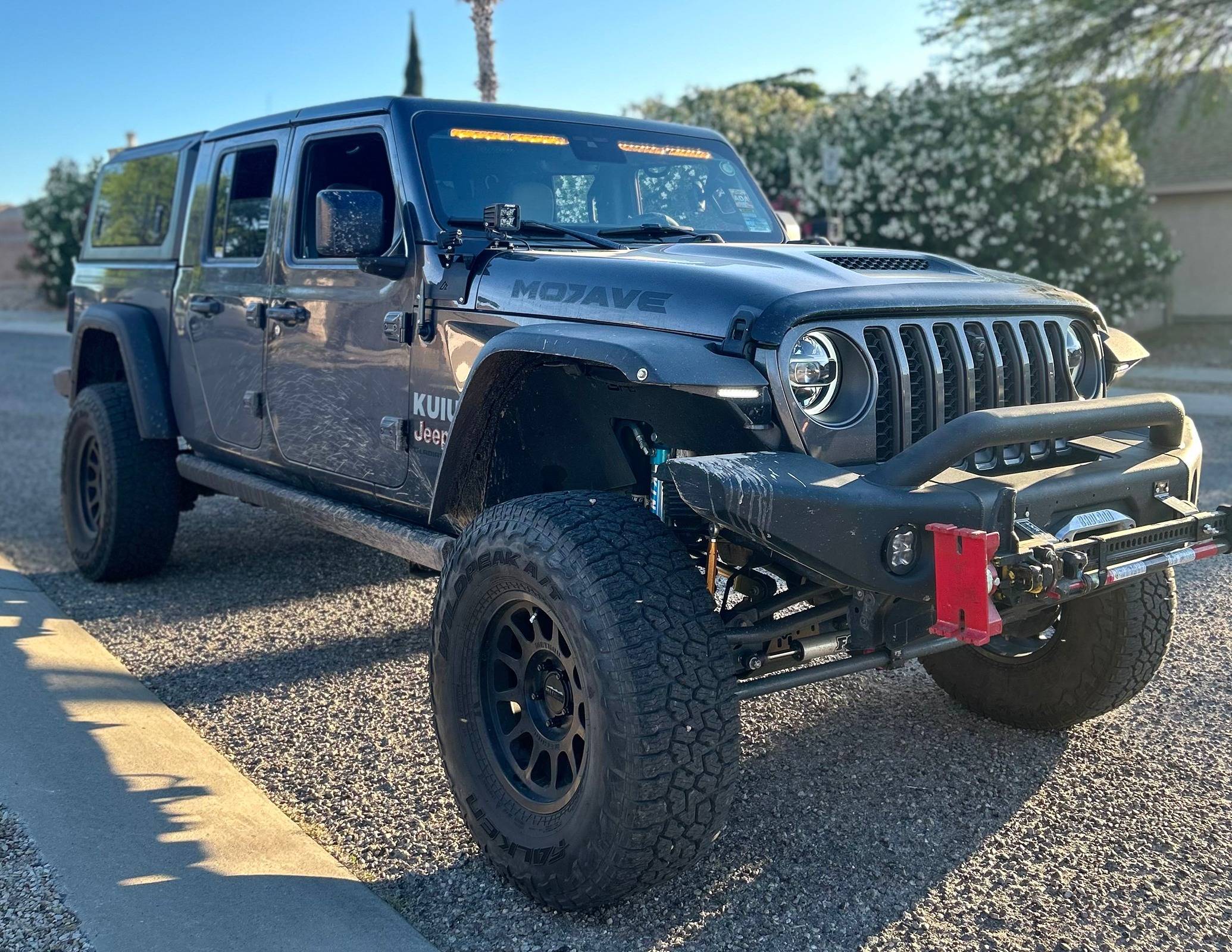

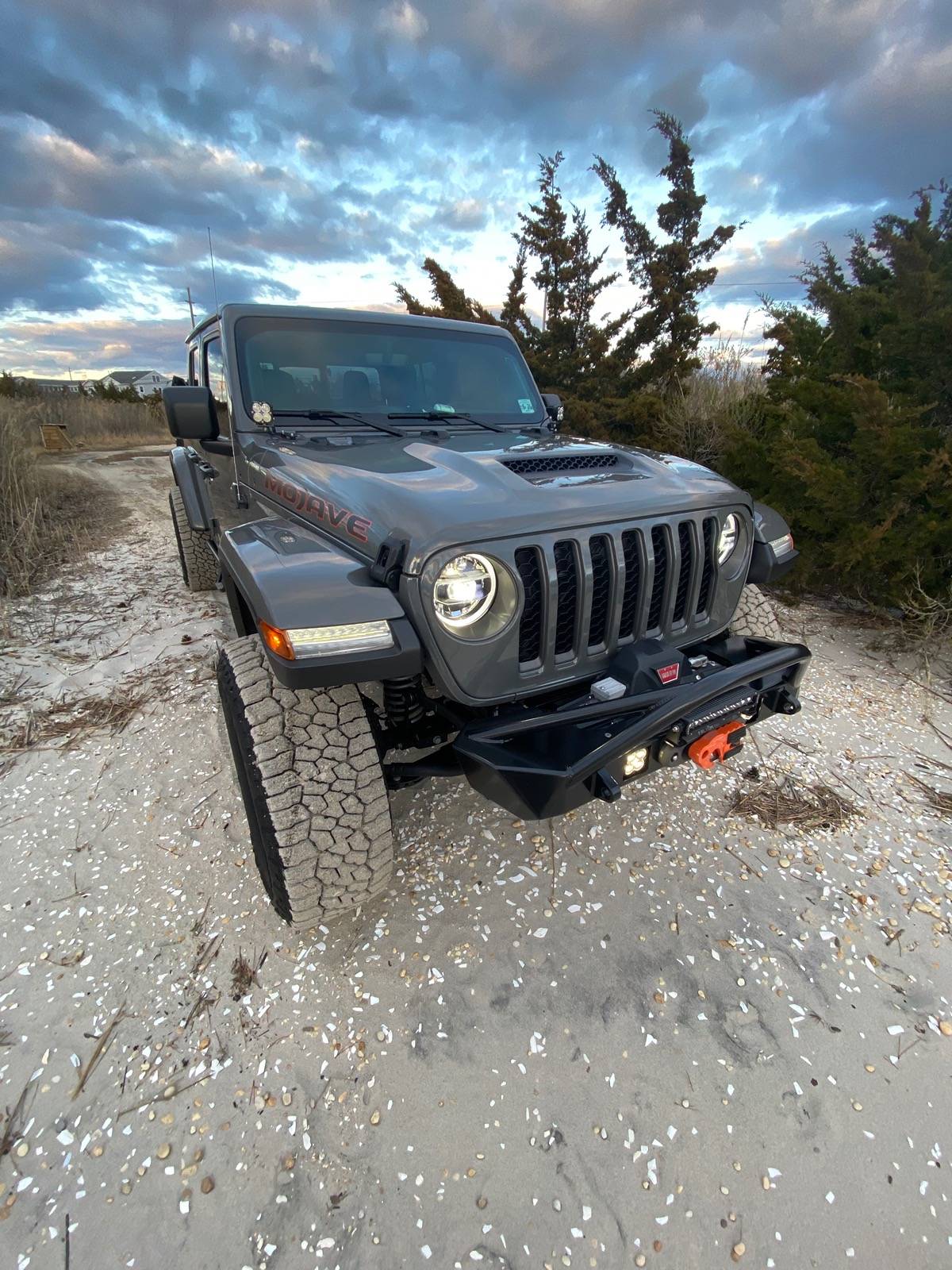

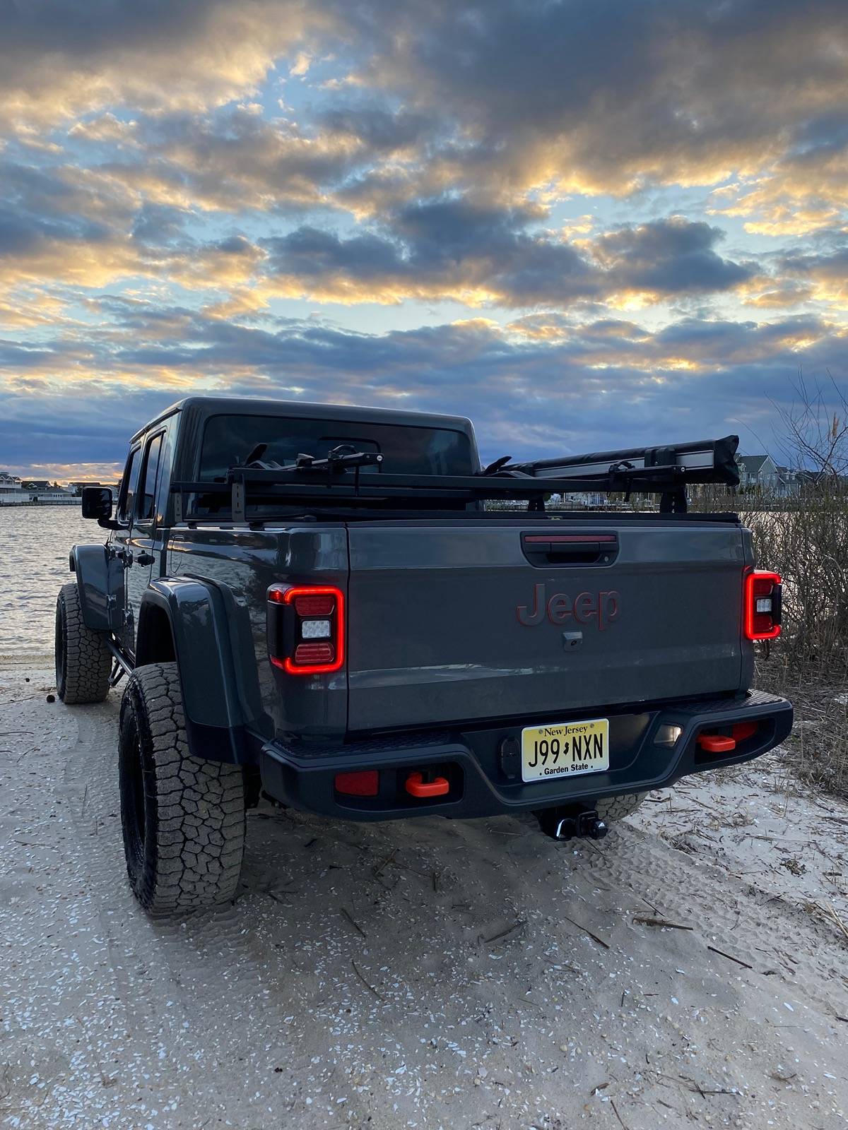

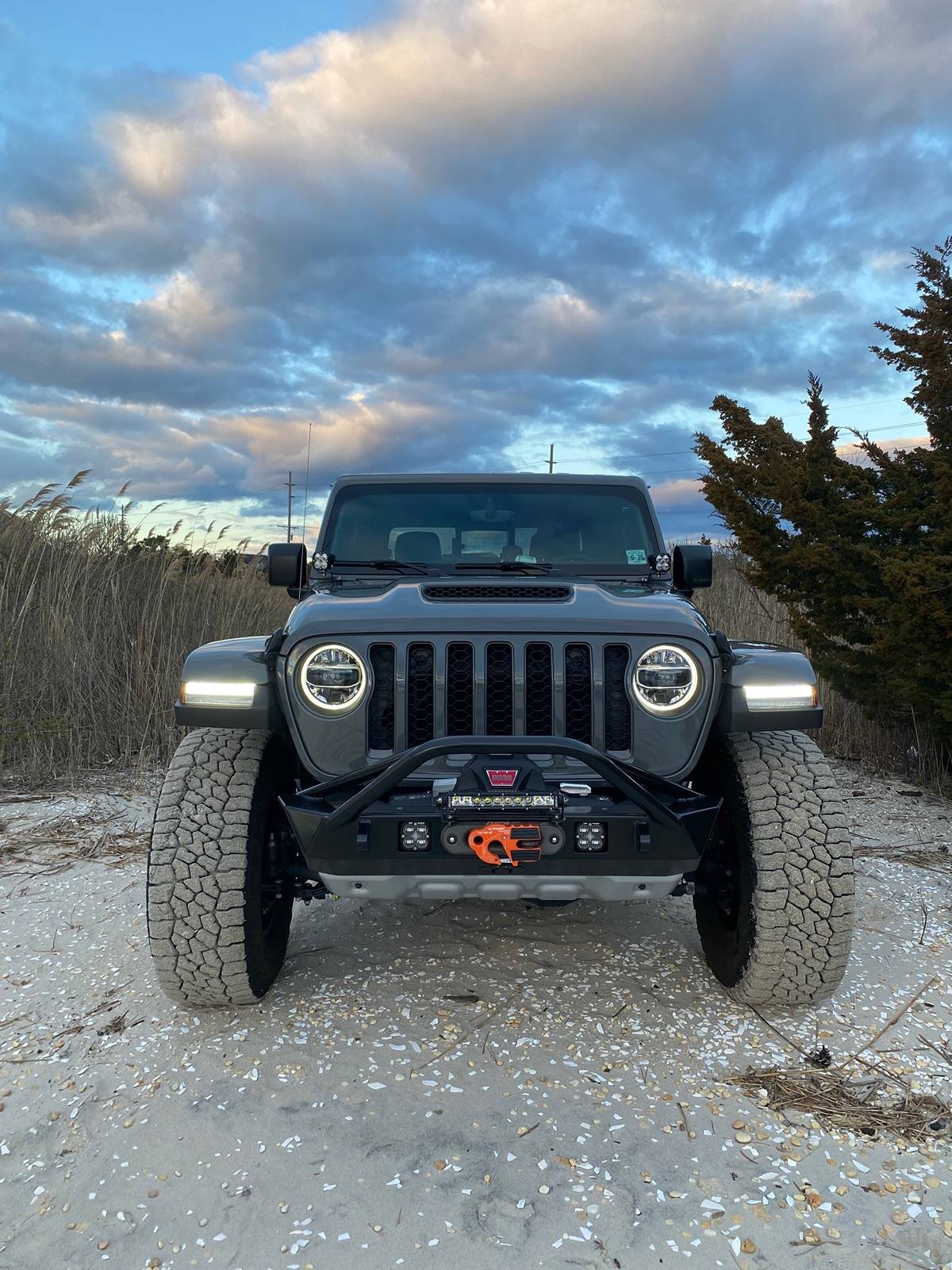

Not 703’s, but here is a couple pictures with my methods that had -12mm offset.
Great looking Glad! I’m digging that front bumper. Which brand is it?

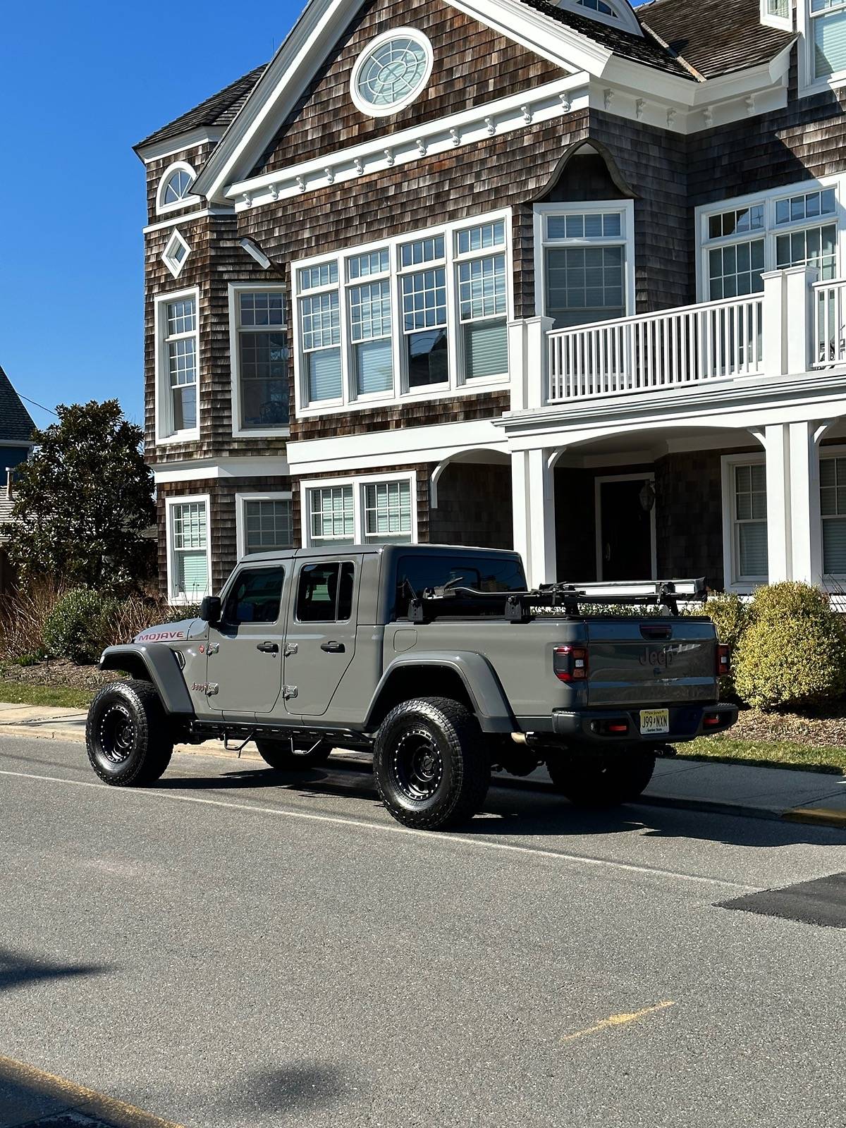

I have herd that the ideal is +12 or so. Factory is about+44.
On the wide axles (diesel, HA, rubicon, mojave, maxtow) i really like the look of +25. Sits very flush with a 315 or 12.5.
They didn't make the wheels I wanted at +25 so i had to suck it up and go +6 and then cover my mistakes with XR fender flare extensions (i don't like poke)

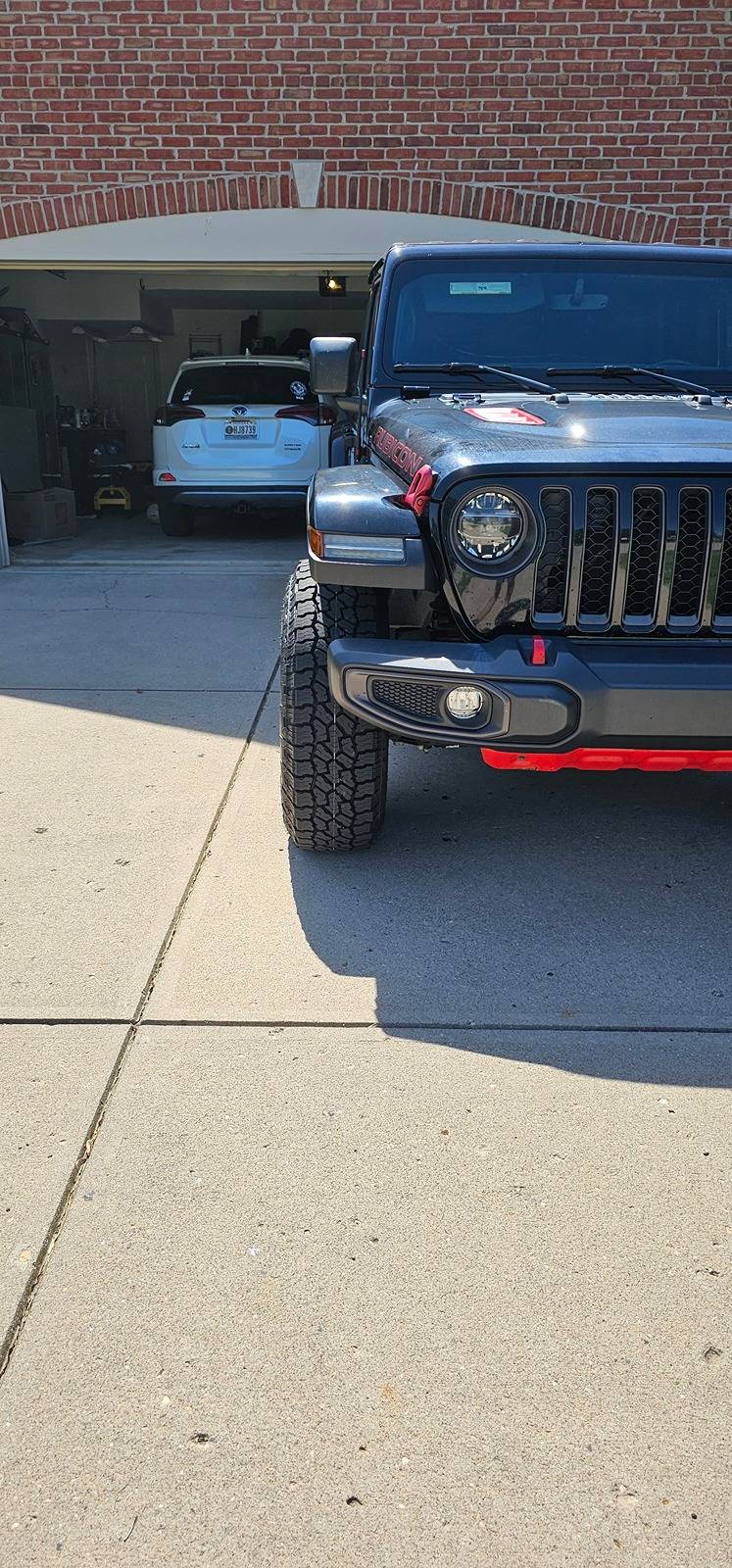

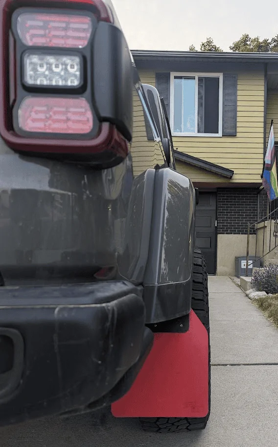

Did you get 'em yet? Mine arrived today, so I had to get them fitted onto my Rubicon. Method 703 -12, Falken AT/4W's in 35x11.50. Definitely love that little bit of poke.

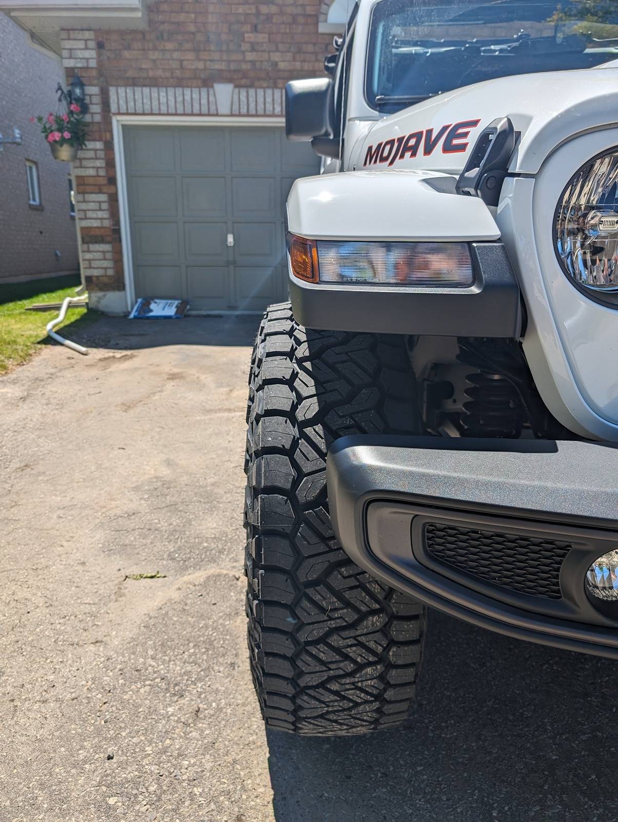

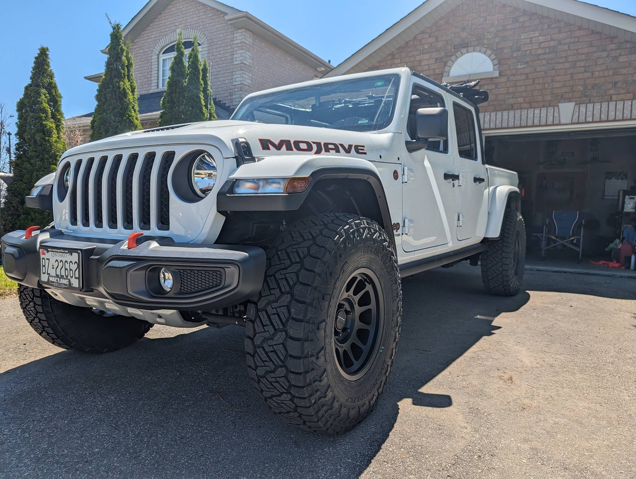

It's funny you should ask. My tires just showed up this afternoon. 703s come tomorrow. Yours looks awesome. I think I f'd up and should of gotten the 11.5 and not the 12.5. Oh well who doesn't like a little more poke, I know the wife has never complained lol

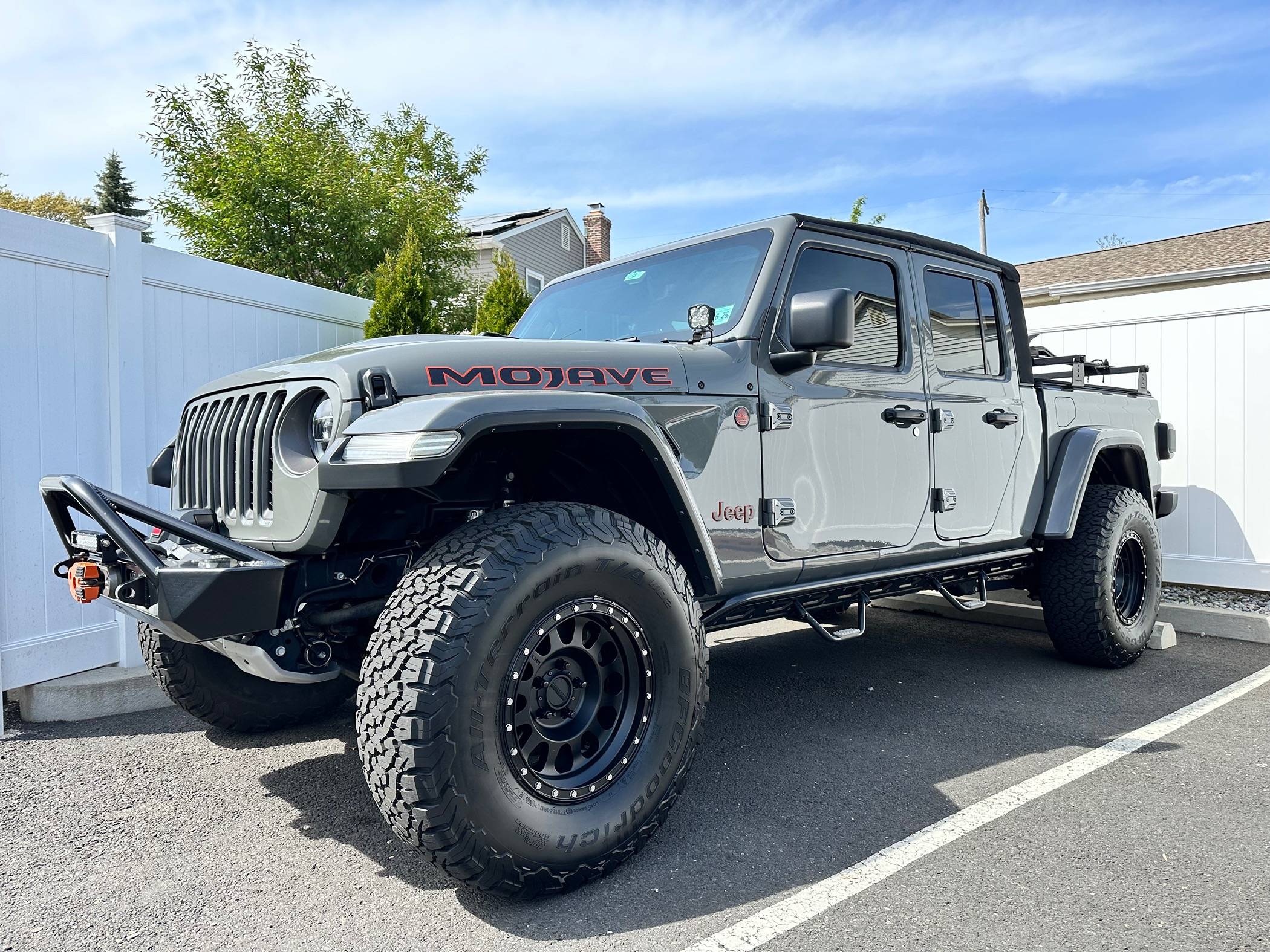

Method 703s, (-12 & 35/12.5/17); Metalcloak 3.5 Gamechanger

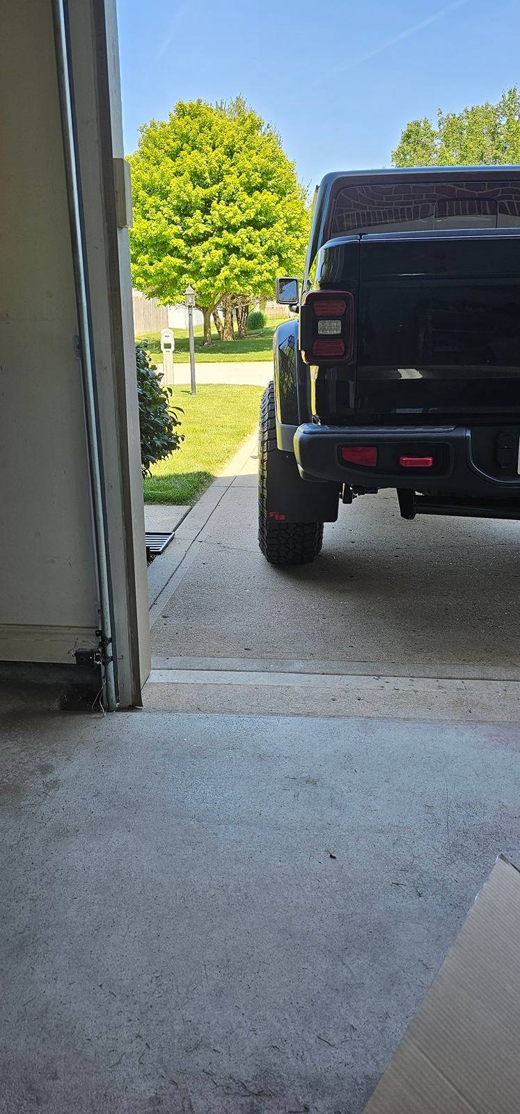

I just ordered Method 703s in a -12 offset but I think I made a mistake and need 0 offset. Does anyone have pics of the 703s in a -12 offset. I've seen pics of the 0 offset. This is going to be a pain in the ass if I have to ship them back when they get here.....
I just put on the 701 with 0 offset (4.75" backspacing). Here is the amount of "poke" I have with stock Falken Wildpeak tires and no lift.
Method 701 -- 17x8.5 | 5x5 | 0/4.75"
Jeep Gladiator Method 703 -12 offset. Need pics! 1719258291812-95
The -12mm offset will mean a backspacing of 4.28, so you will have .47 inches more "poke" than this.
I emailed MetalCloak prior to buying my 2.5" Gamechanger lift and Will said these wheels will work fine. I've since installed the lift and there were no fitment issues.
