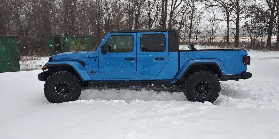

I have a 2022 Jeep Gladiator Sport. I had my first oil changed at approximately 4600 miles. I had it done at the Dealership and they asked me if I wanted BG boa oil treatment. They said it would cover the engine for life if used at every oil change. I have 2 questions 1) My engine seems louder and more mechanical then before, has anyone had a similar experience? 2) Has any one had to utilize the warranty? Thanks
