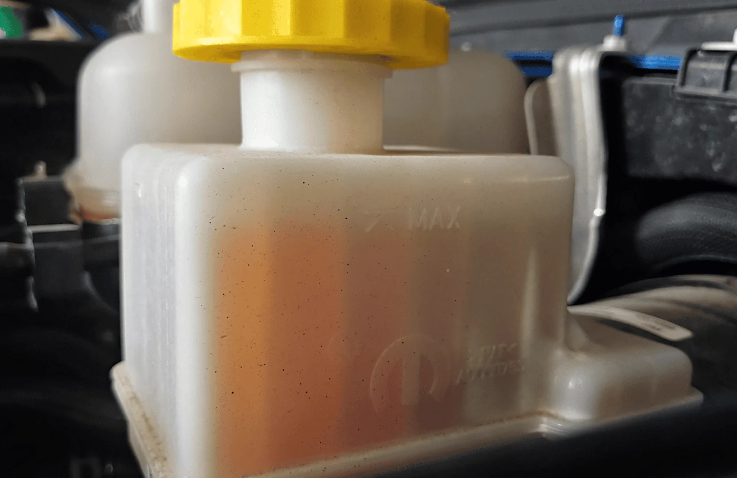

I'll have to check. I honestly hadn't as I literally have a mostly gentle 6,500 miles on it, but I suppose it's possible that it didn't come filled adequately from the factory.
40,445
53,880
I'd expect air in the lines and the brakes not coming back if that happened. You run low on fluid, it takes in air. Air compresses and gives a spongy pedal.
Are we sure it's not loss of power in the power brakes? These are electric vacuum pumps, are they not? Or is this different on these?
It would have to be awfully low - and an extreme angle to get air into the system.
This is how mine came -

The OP states pedal to the floor - lack of boost does NOT make the pedal go down farther, it does not impact the pedal travel/distance - it means you have to stand on the pedal with both feet to stop, but doesn't change how far down the pedal travels.
Only the hydraulics can impact how FAR the pedal travels.
The booster impacts how big of a guy is needed to push the pedal to stop - but the pedal distance won't change.
If the thing ran low on fluid - it won't be better later that day. Once air is in, it's in. It's compressible so pumping the pedal will compress the air and bring the pedal back up. But 5 minutes later when you press that pedal, you will be recompressing that air and have to pump the pedal again. The air does not go away. It's there until bled out of the system.
If there was an extreme steep angle and the master cylinder ports were exposed to air because of really really low fluid in the reservoir, it won't do a thing until or unless the pedal is pushed or the ABS kicks in. The master doesn't suck air in unless used.
So if you hit a huge hill, your reservoir was all but empty and the ports were exposed to air, once back on level ground all would be fine because the brakes were not used, ABS didn't kick in.
But if you used the brakes while the ports were exposed, then you got air into the system. That issue won't just go away.
But look at that reservoir - unless there was only 1" of fluid in there, that truck had to be at a good 45 to exposed the master cylinder ports to air.
