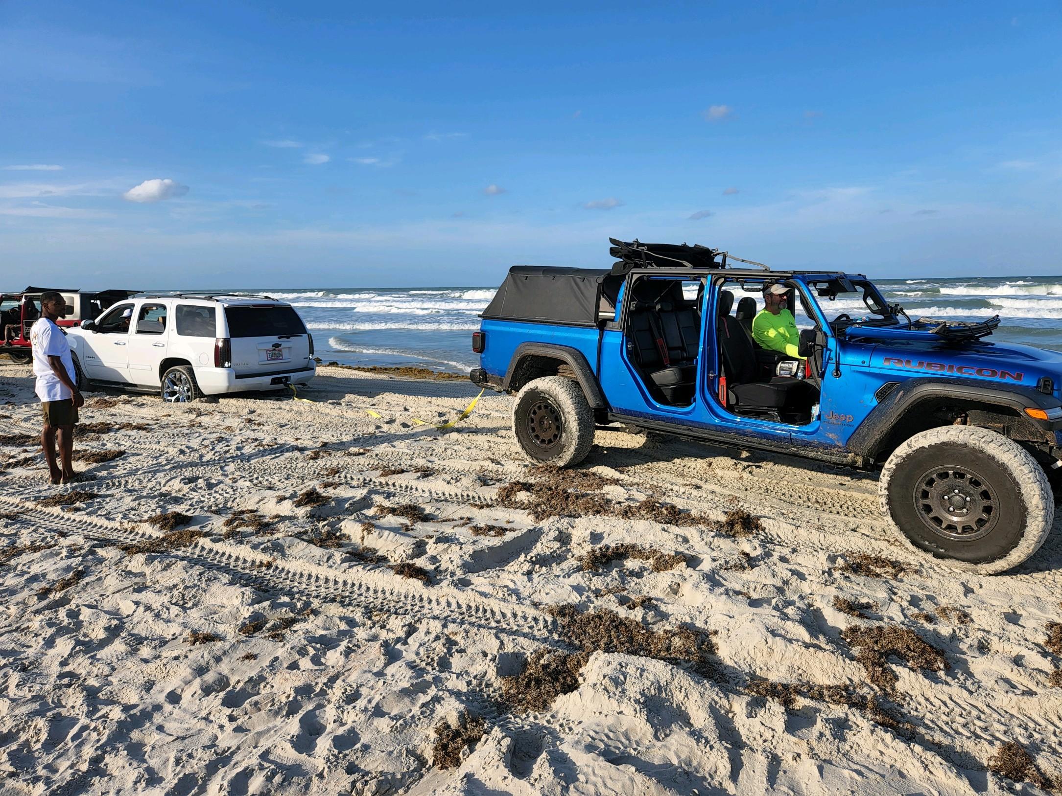

This happened to me when pulling out a stuck suburban at the beach: my truck dug down in the sand and there was a lot of tension on the strap and the Jeep wouldn't let me back up. Had to turn it off. Don't recall if I had to take it out of 4WD but might've.
I'm sure someone in here knows what and why.
I thought maybe the wheels were spinning….. they definitely weren’t. lol. I pushed the pedal and it just sat there.
