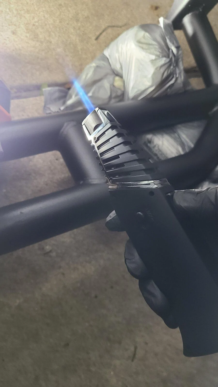

The most work and worry I've ever put into 6 bolts EVER!
I watched the Ace videos, and the first bold (driver's side middle body mount) went slowly - the pull down on the washer advice was golden.
The driver's side rear scared me - it was freewheeling at a point, came to the forum and started reading about broken welds. Yikes! But then tried to put it back in, and it seemed to bite - so I needed to pull down. Once I did that, it came out.
While on the forum, I read about the heat, and was going to get my propane torch when I remembered my daughter gave my wife a butane chef's torch for Christmas. Heated directly on the bolt for about 30 seconds, and while still slow, helped greatly.
I think the back and forth advice is good - help break up the Loctite. The residue I saw looked blue, not red (2020 Rubicon) so maybe they switched.
Getting them on and torqued to 80 ft-lb was no problem.
