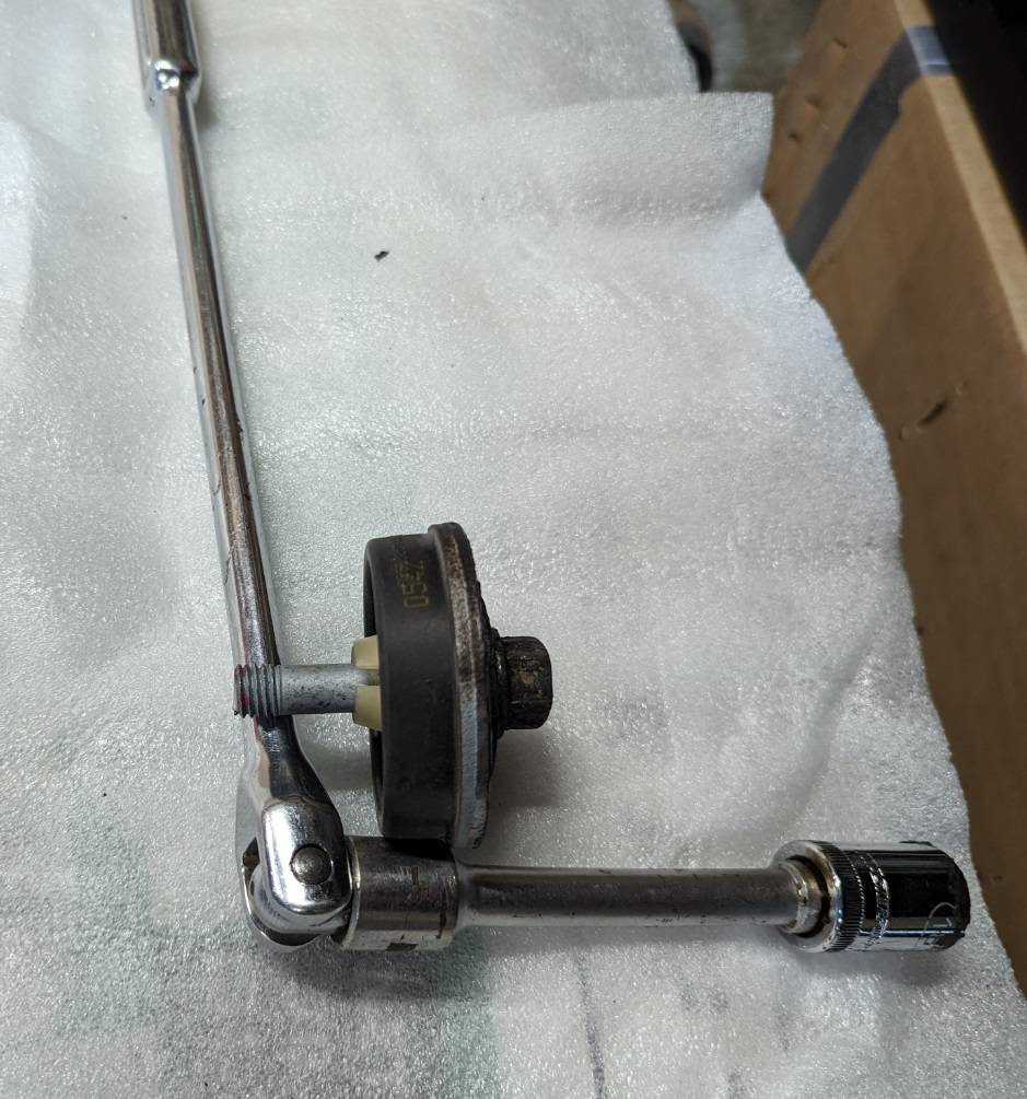

So my question is does heating the bolt up hot enough to glow red. Is that taking some temper out of the bolts? Should you just replace them?
I never get to that point. All you need to do is heat the bolt head and the heat will move to the shank and up to the threads. Doesn't take red or orange, you only need to break a Loctite bond.
Generally you rarely have to get the hardware that hot to have things come apart.
if your fighting loctite, 500f is more than enough.
Things like a nut, the beauty of induction heating is it happens fast and the nut heats way before the stud does. That temp diff is to your benifit.
Critical hardware should be replaced. Heat treatment does change if you go red hot.
Sadly, these are not nuts. They are huge very long bolts.

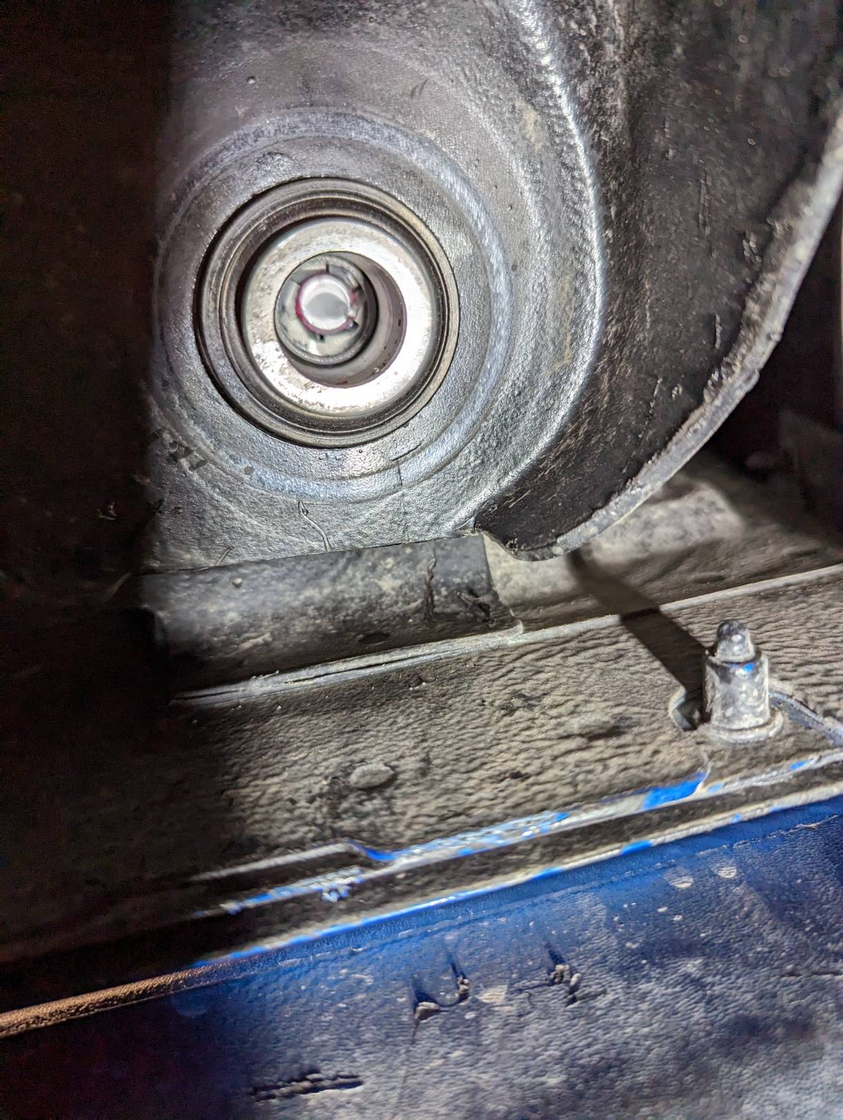

This is the left front just behind the front wheel - it's one of the shortest of the bolts. The rears are longer as I recall.
Making it more difficult is the fact the bolts are long, large, and that big washer dissipates much of the heat while you try to heat the bolt. It acts like a heat sink.
Jeep Gladiator Induction heater for body bolts PXL_20230324_010126315.MP
In this pic you can see the toothed washer that holds the bolt captive if you do totally unthread it. You can't unscrew it and have it simply fall out. Doesn't normally work that way unless you get lucky and that washer is not there, or is stuck and allows the bolt to unscrew from it.
Jeep Gladiator Induction heater for body bolts PXL_20230323_204226188
That retainer is very similar to this - it grips the threads and the harder you try to pull, the more it grips like those Chinese finger things.

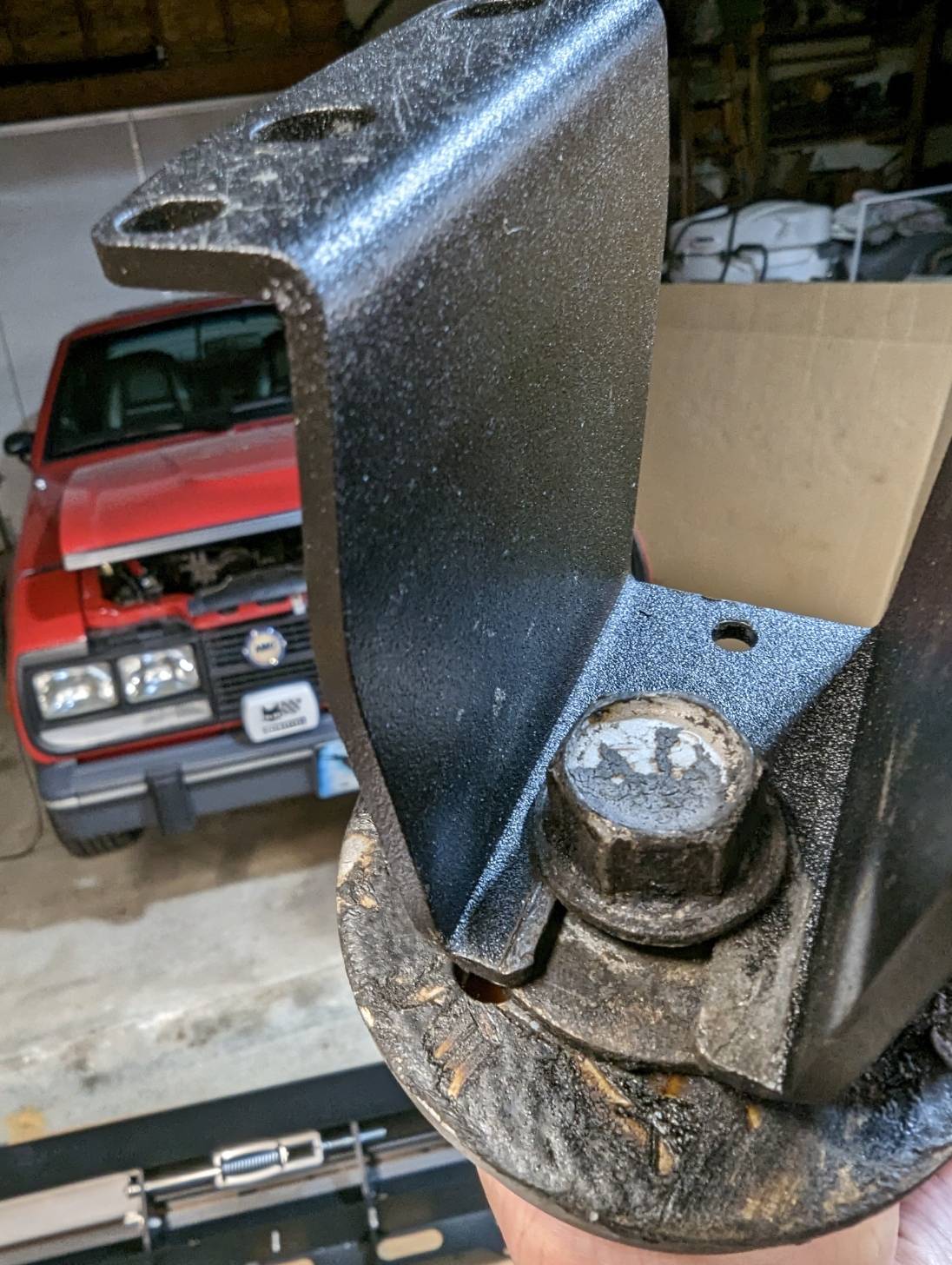

The RSE brackets you do NOT need to remove the bolts - just loosen them.
The bracket is notched to slip around the bolt - between the bolt head and the big heavy washer. Make sure it goes between head and washer for things to work properly and the steps to sit correctly.
Sometimes you have to loosen the bolts enough to file the knurling that is just under the bolt head for the bracket to slip over. Get a good sharp narrow or tapered file and it goes fine. I didn't have to file many of the bolts, just 3 or 4 between both Jeeps I did.
This is how they need to go. I had undercoating to deal with and scrape off the washers to make sure the bracket sat against the washer and not undercoating. Likely not many will have that.
So why is that bolt out of they don't need to come out? It's the one I BROKE and decided to use it to take pictures of how the bracket should go when properly installed.

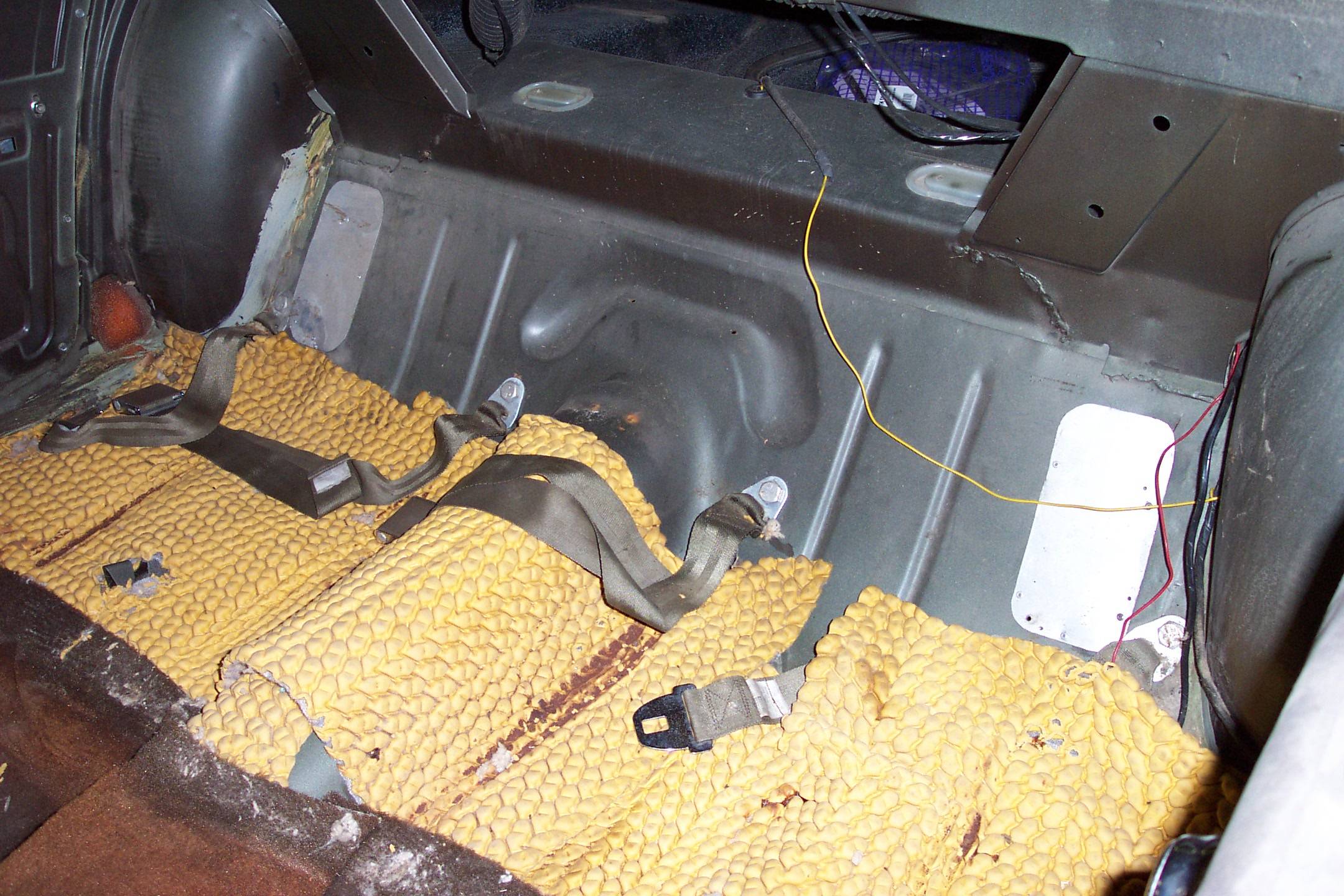

Shhhhhh- don't tell anyone - torque link install on 1970 Javelin. Factory install was done with the nut bracket installed in the frame rails before attachment to the body. Once together, there's no way into the frame rails - except this ->
Jeep Gladiator Induction heater for body bolts pre-paint 050
Unless you pull out the seat bottom, then remove the bolts holding the seat back in place, you can't tell. But it's ok - the dealer torque link install kit instructions said to do it this way.
