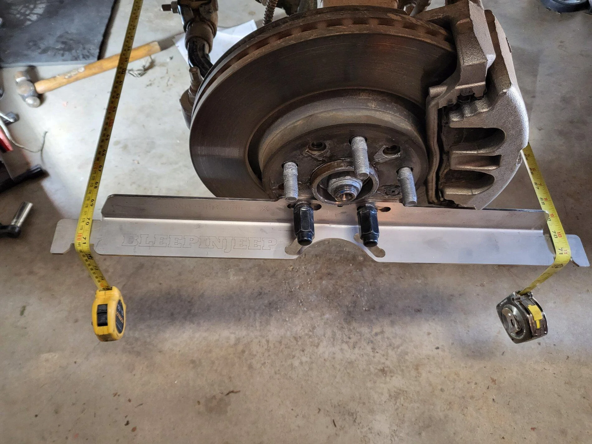

Seems fine, but I definitely can't wheel it. There are shredded threads coming out of the adjuster housing.
Jeep Gladiator Broken Drag Link, Neutral Pitman Arm Position? 20211122_111439
Toe was perfect.
