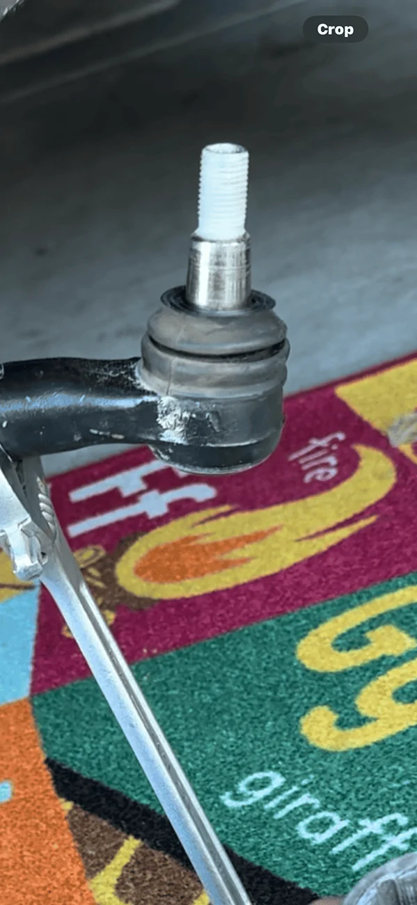

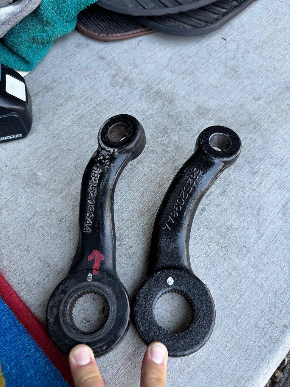

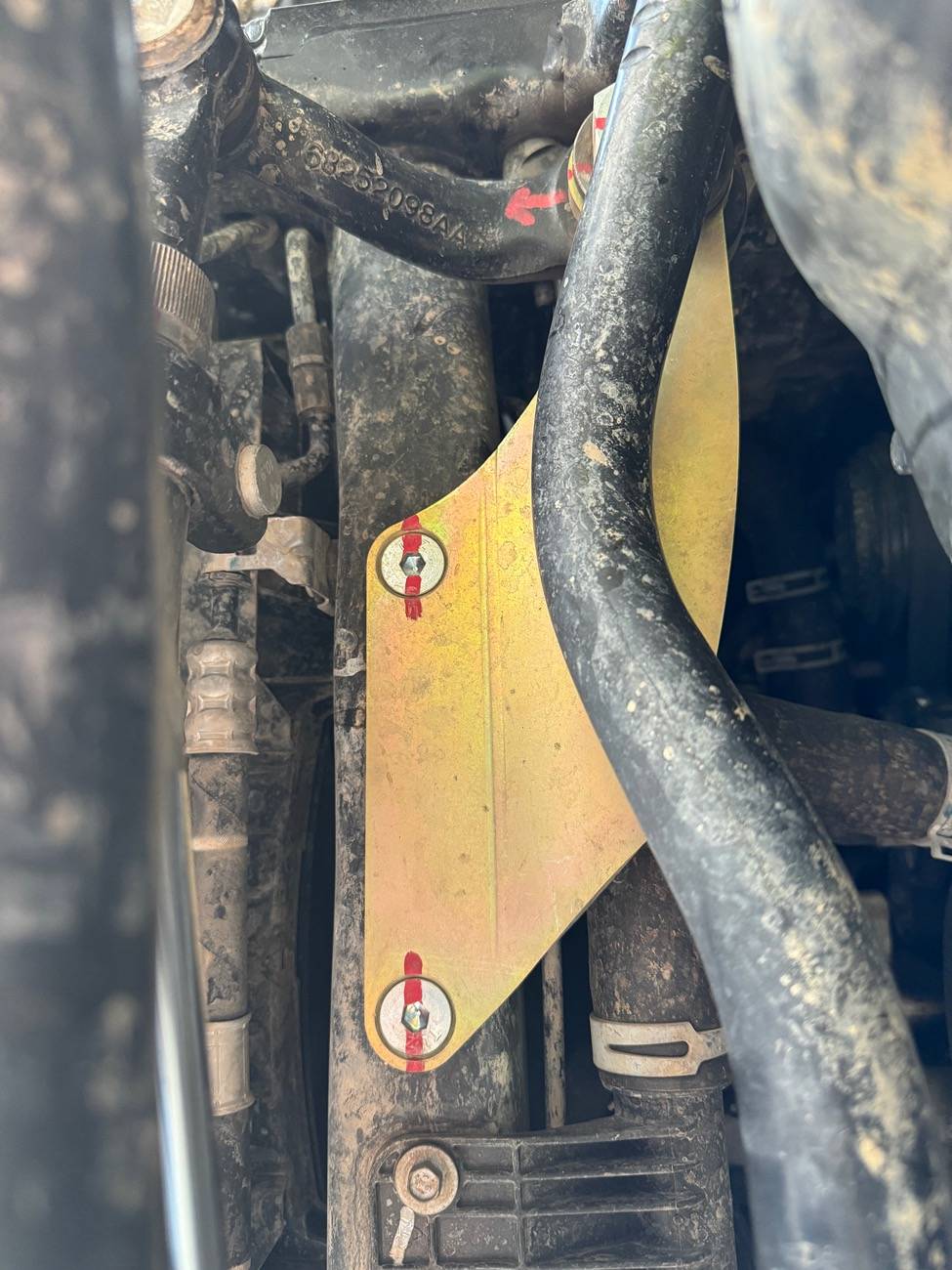

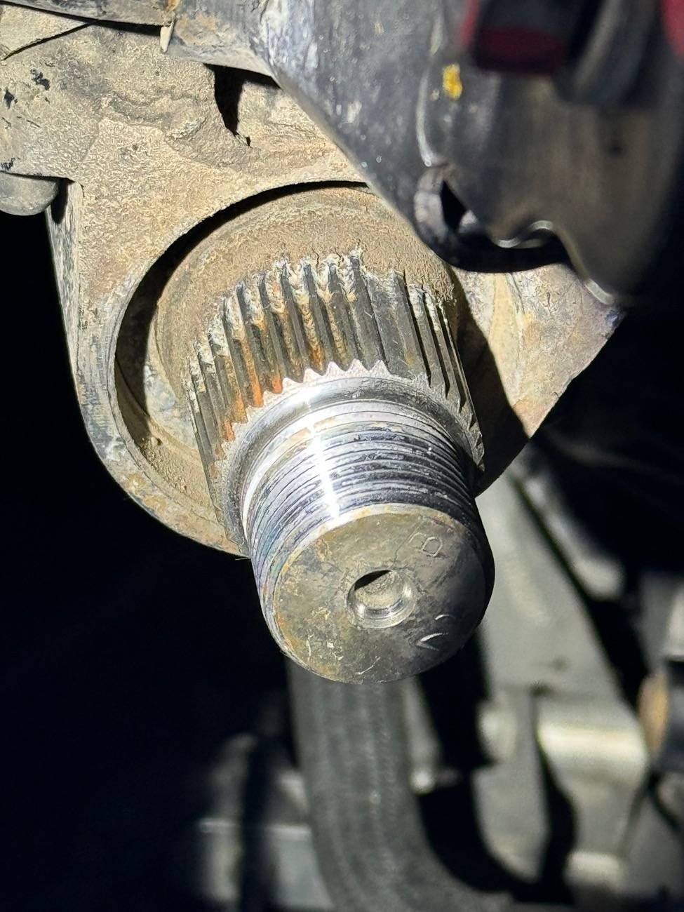

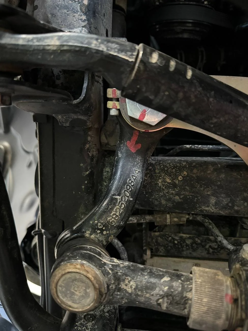

So far looking at it before I take off the pitman arm, it looks bent to the left. Which is weirdbecause the impact forced it right. Hard to tell tho. These are pics with the wheels pointing straight. I drew the arrow mark when I installed the sector shaft brace. So that tells me it’s not the splines just by looking at it. The nut is still lined up with the pitman arm. If it had slipped it wouldn’t be lined up. So it must’ve slipped internally? and possibly bent the arm?

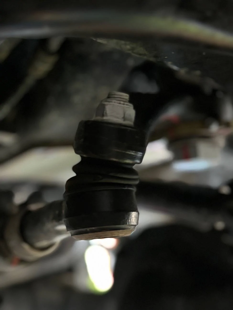

@kevman65 draglink is fine; still in it’s position at the adjustment threads.

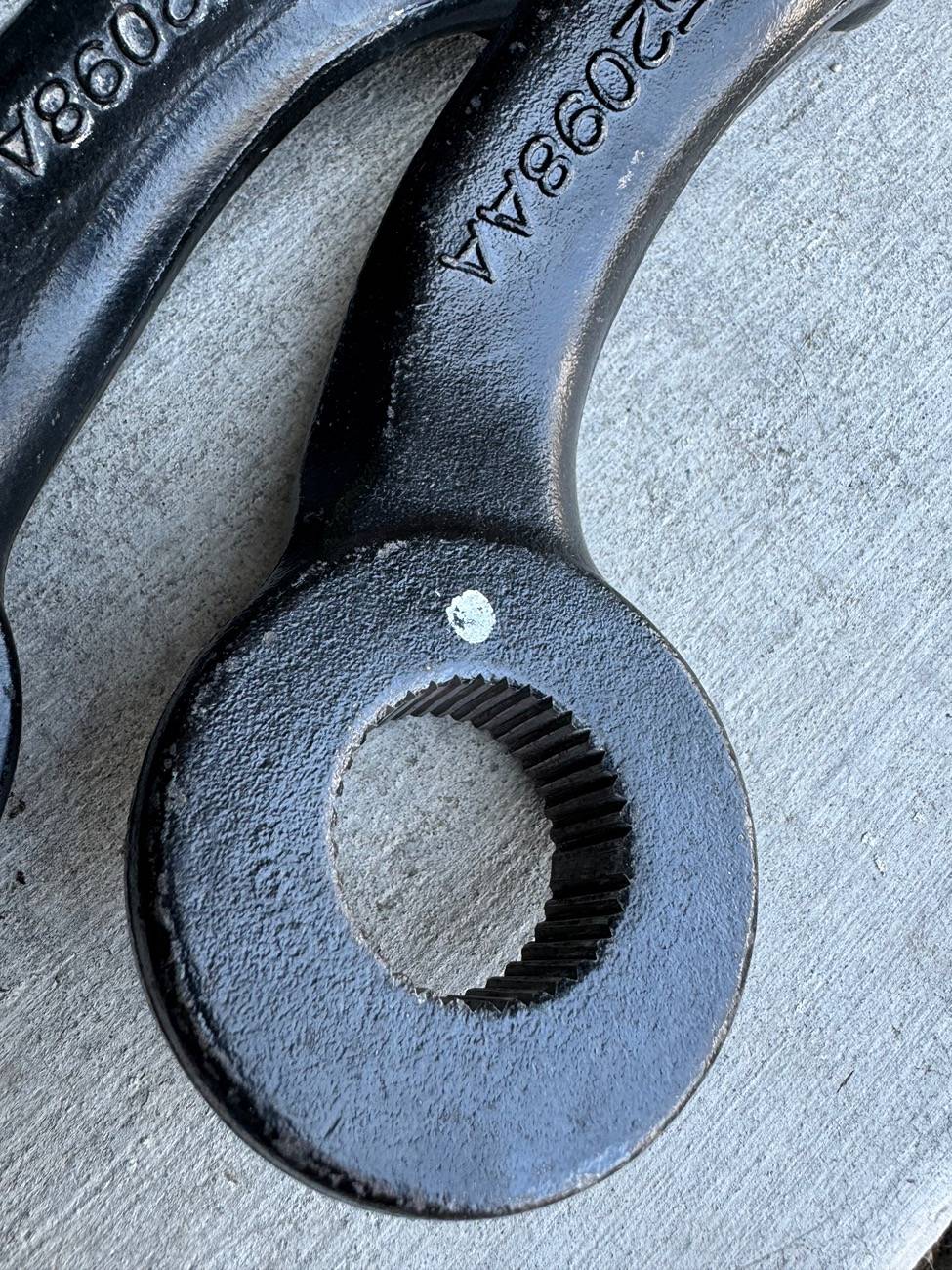

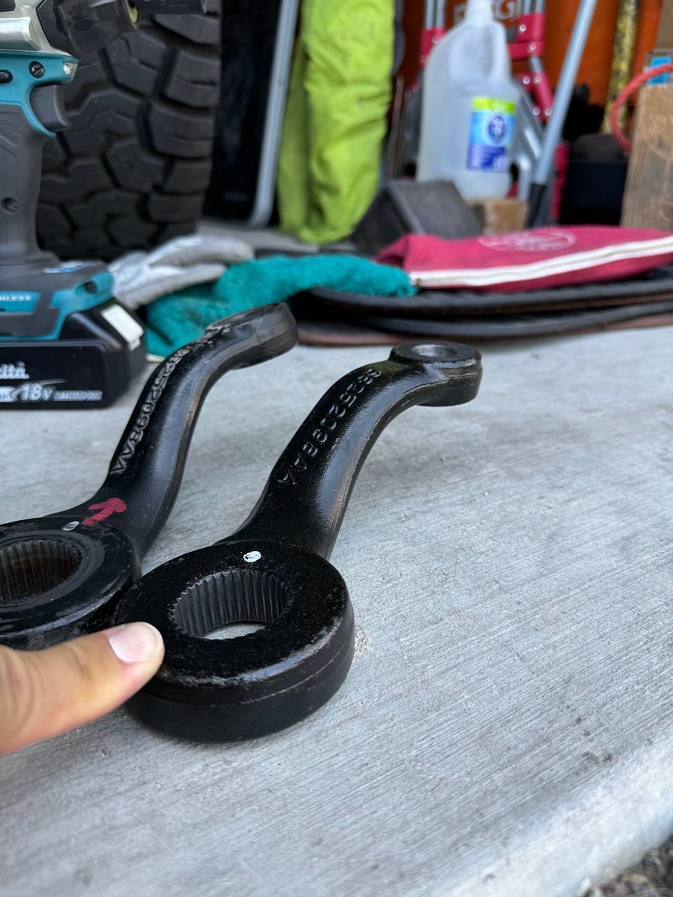

arm was definitely bent. Drag link end is fine. Splines are fine. In case anyone cares, there is 1 fat spline, so the pitman arm can only go on one way. Can’t adjust it. Which is cool, no guess work or marking where center is. Putting it all back together now I’ll get back with an update once I drive it.

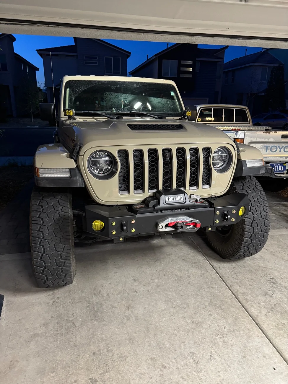

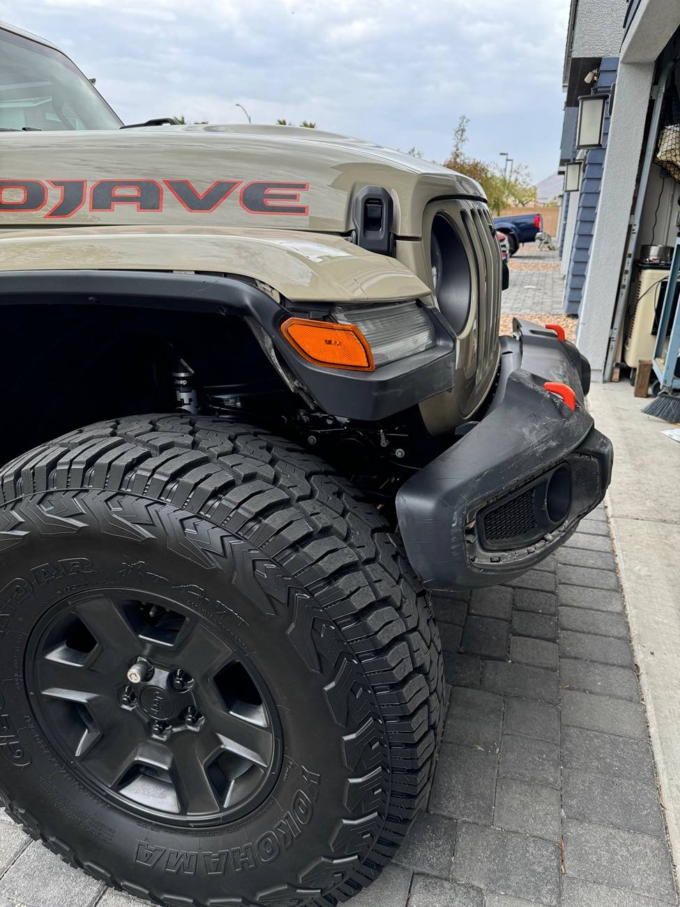

Yup new pitman arm fixed my issue. Impact bent it. Luckily it was the only thing that bent. My sector shaft brace from metalcloak saved my gearbox. Spent like $110 on pitman arm from rockauto and then I bought a new bumper from metalcloak for almost $1000. Did this instead of paying deductible lol on top of that, harbor freight had a sale on their badlands winch, got it for $369 after tax.

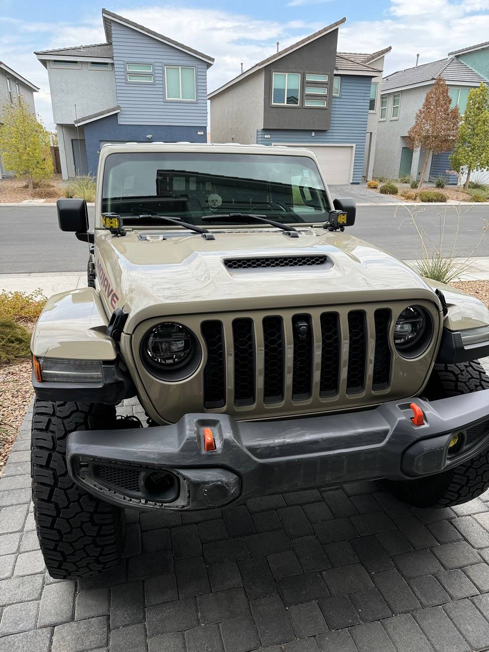

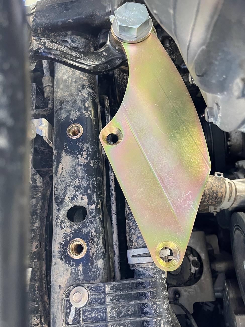

Smacked a car that ran a red light last night. My girl was driving and didn’t have time to stop. Long story short I need a new bumper and my alignment is off. Nothing looks bent but I can only turn left a tiny bit and I can turn right a lot. I can see that the steering gearbox pitman arm is favoring the left side now. It maxes out to the left fairly quickly because it moved. Can turn to the right a lot, more than normal It seems. Still drives straight for the most part but I will still get an alignment asap.
Obviously the impact caused it, I’m just wondering if the spines strip on the sector shaft, or is it internal that would cause the pitman arm to move left from 12 o clock with the wheels straight. Haven’t had time to inspect it further, just looking for info from others that have had this happen. Thanks in advance.
