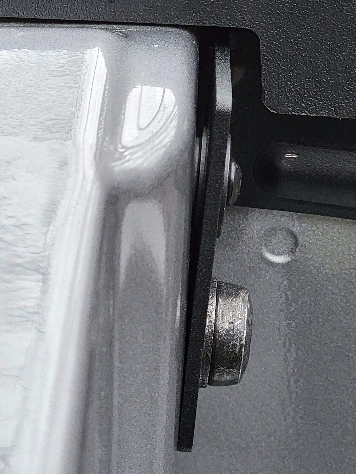

I'm wondering from any of you who put this same rugged ridge soft folding bed cover on... Does your bracket sit flush on the bulk head or does it lean forward at the top?
Jeep Gladiator Bulkhead (top left and right side) threading missing?!! Screenshot_20210401-105931_Samsung Notes
I hope you can see the well nut (4) and washer (2) behind the plate (3) in my photo. I would describe the well nut as a top hat. When I pushed it 100% through the bulk head then when trying to put bolt (1) in, it kept turning and turning and it wasn't screwing in (probably not the correct term).
I end up pulling the well nut back out so only the brim of the top hat is in the bed with the washer on top. But this makes this bracket lean forward a bit.

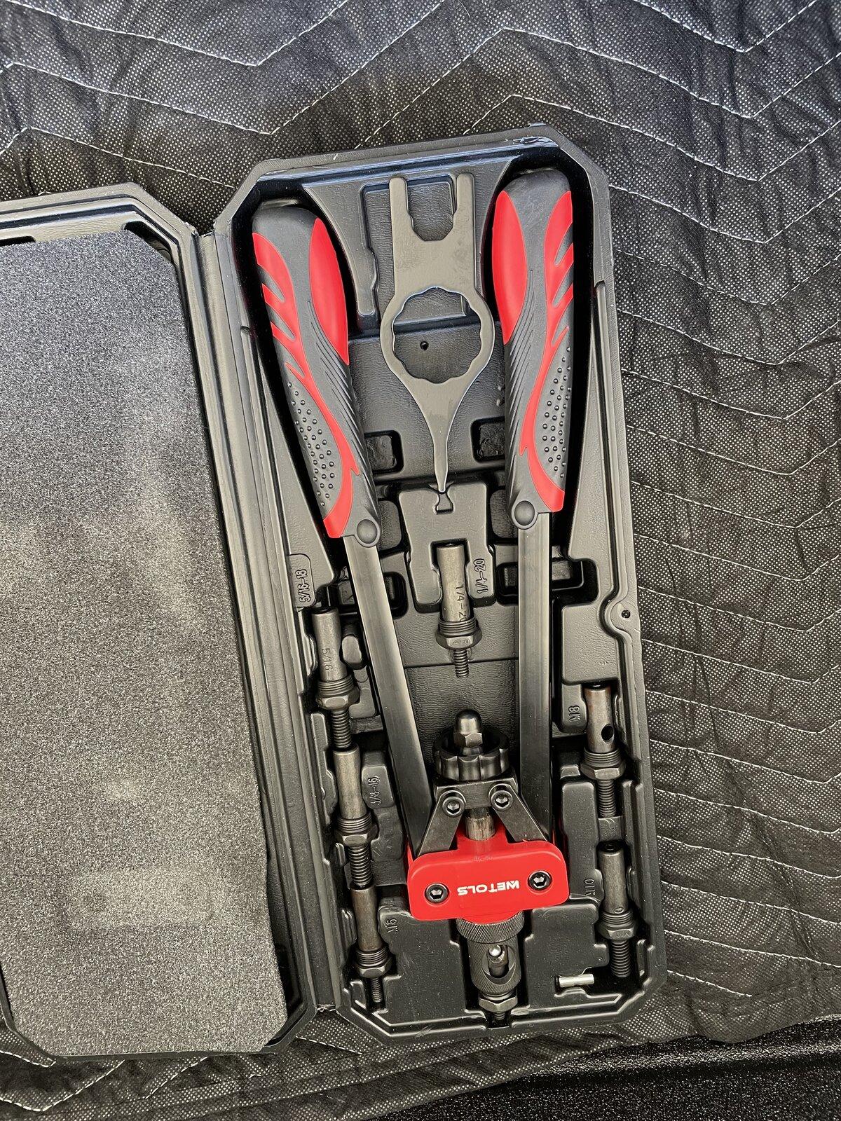

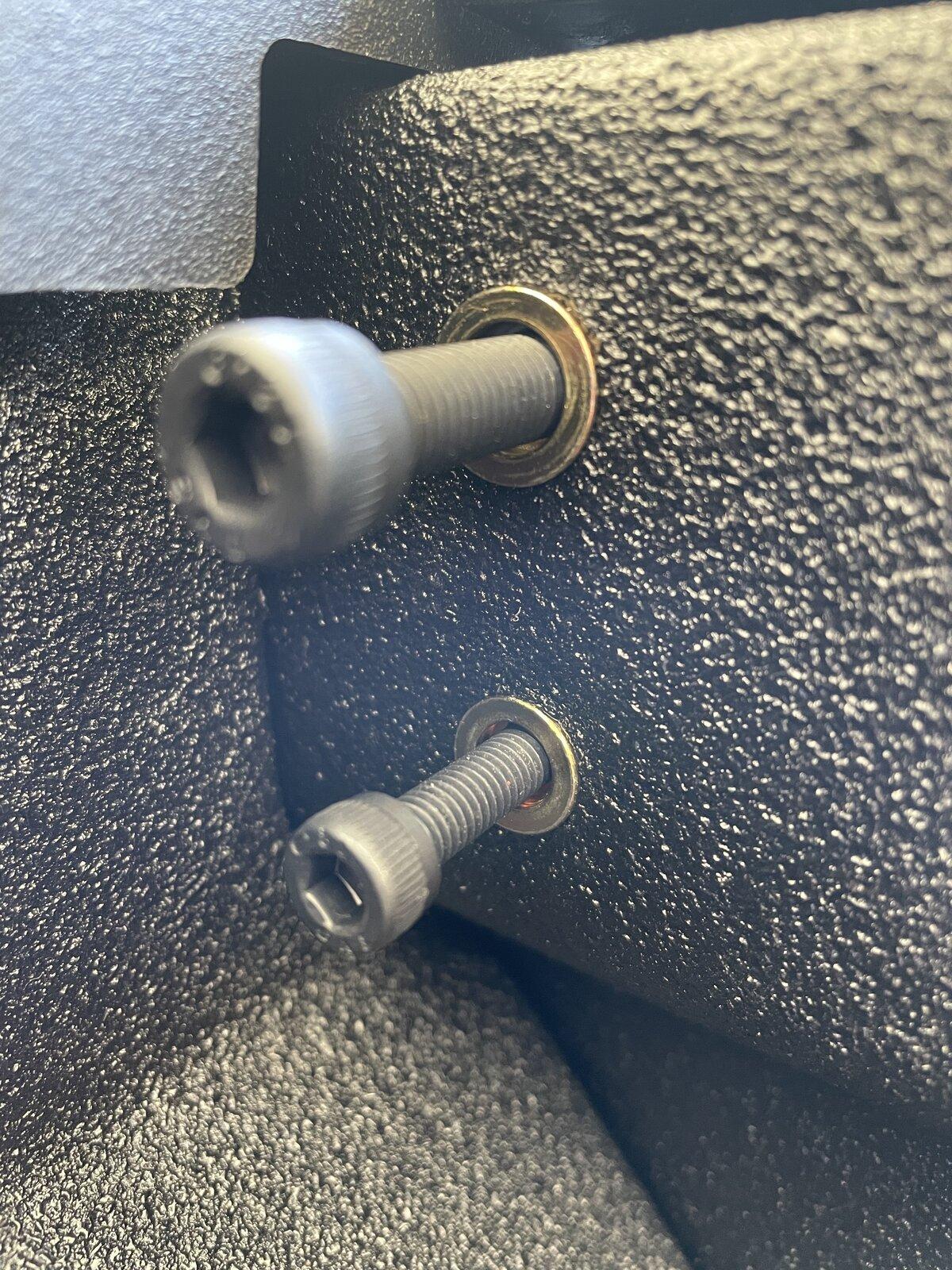

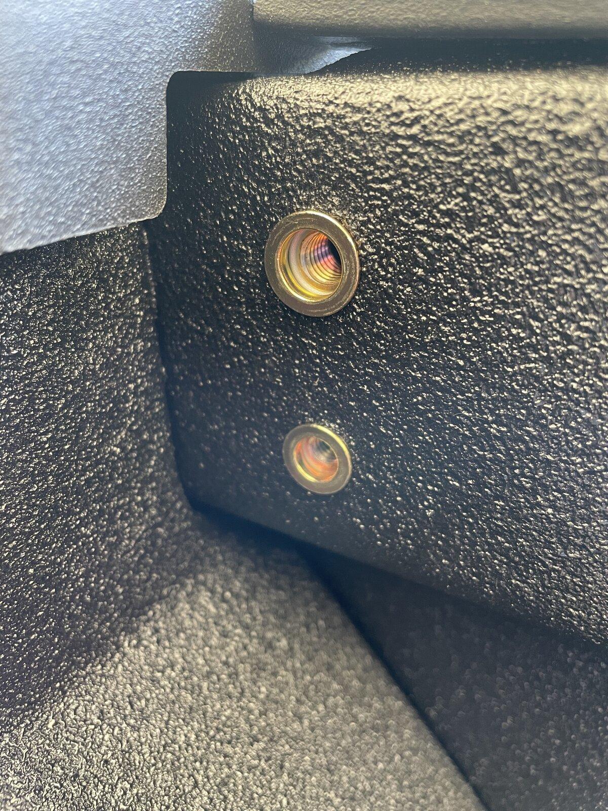

I had the same issue with no threads in the front of the bed when I went to install my rugged ridge hard rolling cover. After reading through some othe replies I bought the Wetol rivet nut tool on Amazon for $39 and it worked great. I used an 8mm insert in the upper hole after I used a 7/16 drill bit on the hole. The lower hole fit the 6mm insert. It was the best solution I could find. I didn’t want to spend the additional money for the trail rail system.
