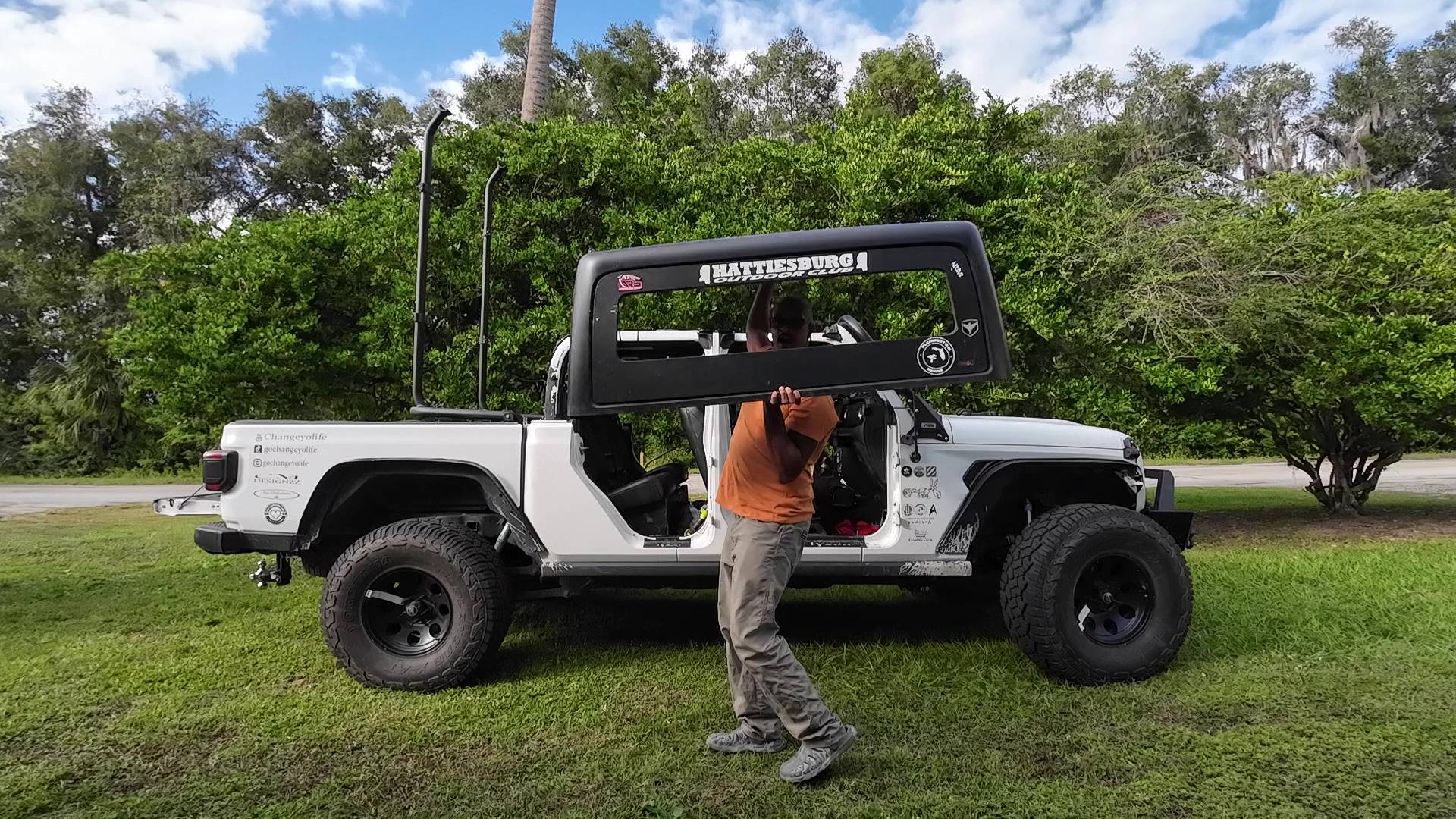

You can get the surround in either transparent (Looks like factory) or textured like I have to match the top. There is a tray at the bottom with four clips at top (inside) to keep it in. The rubber seal is very thick. So, if the shop does a good job with the install, it won't leak.
Here is a pic of me putting my top back on today. You can see what it looks like with the window removed.
And BTW, I only put four bolts back in the top. I don't even know where the other ones are now.???
