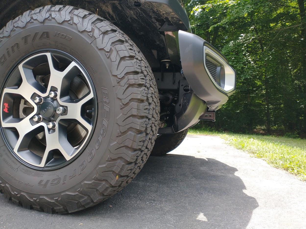

Well I went down this same path and sort of gave up. The closest I got was the link below, and I was planning to just take the 30 minutes or so to install the plate before each wheeling trip.
https://www.rockhard4x4.com/product_p/rh-90205.htm
I was looking for aftermarket front bumpers that had an integrated receiver hitch so that I could use one of the removable winch plates directly into the bumper. There were only a small number of options out there, and some of them still included the large "cutout" for a permanent winch install. It also started to really stretch my budget if it was going to be a $600+ bumper just to install a winch. I decided to go with the front receiver hitch (actually just installed it yesterday), and while it does remove a very small amount of approach angle I can't see it every causing me a problem as I am not a rock crawler. If I find that it is hitting (without the winch mounted) I may add one of those little angled hitch skid plates. I sort of view it as providing me a little early warnign that I am getting close to hitting other critical steering components underneath. I also really like the ability to use the winch in the rear as well. For the wheeling I do, I could actually see the need to pull myself backwards out of a situation I got into as more likely than the need for a front mount.

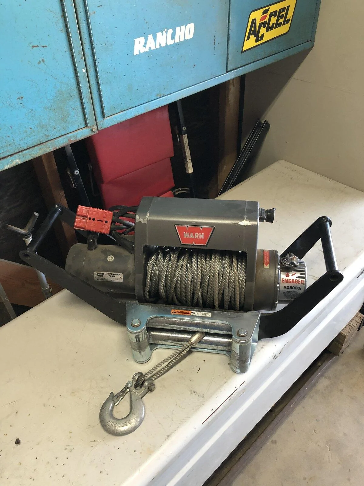

I have the Wyeth-Scott hand winch. I also have a front hitch, which hides behind the plastic front air dam with only the snout sticking out. Harbor Freight makes a mounting plate with hitch insert for a winch, which I also have if I decide to carry my electric winch along. Out here, trees are in short supply so winches are of limited utility.

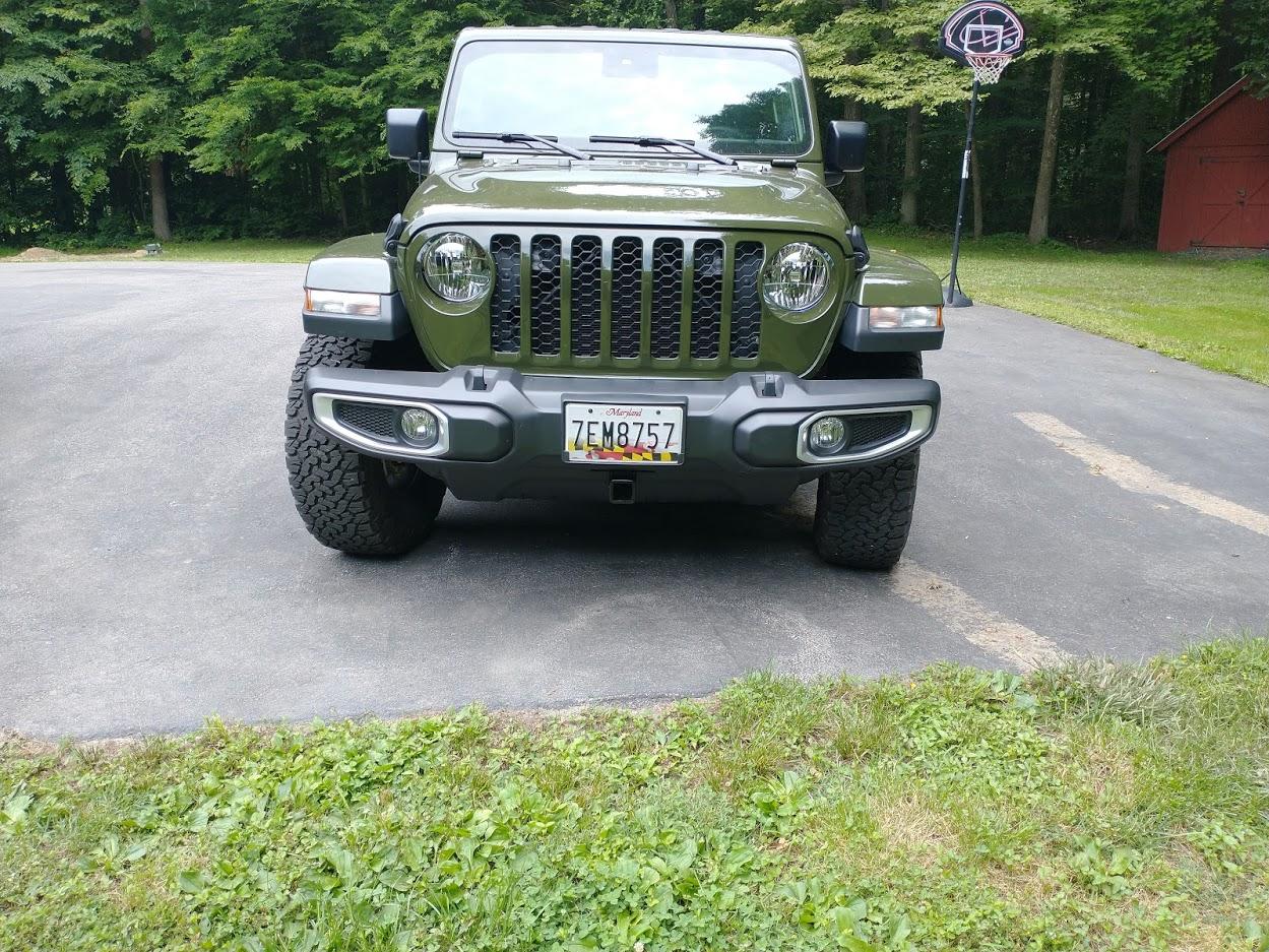

Right...if you want "quick attach" I have not come across anything better than that Rock Hard 4x4 plate above...and they really don't market it as "quick" attach but after the initial bracket install it would not take too long to put it on/take it off. Here is one more side shot of the draw tite front mount hitch incase it helps. I just don't do any wheeling that would have this limiting me in any way...but to each their own.

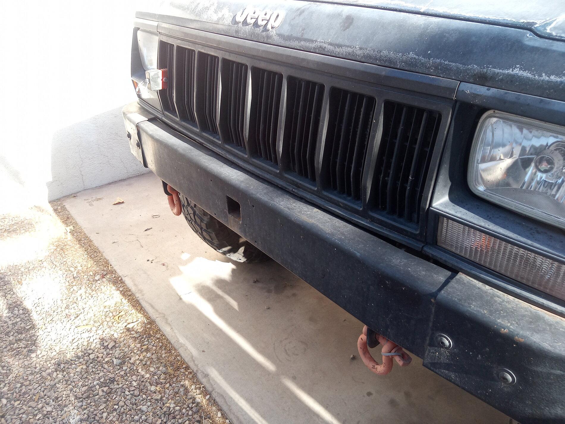

This is my setup on the xj, which has a 8" lift so approach angel is not a issue.
I suggest you buy a aftermarket bumper, unfinished take it to a fab shop and have them cut and weld in a receiver, and do some bracing. FYI you can buy receiver stock by the foot at lots of metal supply places like industrial metal supply co.
Alternatively call up some bumper places and see if they can do a custom side order. It's not a very hard job for someone with a plasma cutter and welder.
This a receiver tube welded into a 3x6x1/4 tube bumper with about 2" sticking out the back where I push my pin through.
If you can do a hidden pin style aka pin back of bumper then the winch won't stick as far out. You may have to a little customizing of your winch carrier to get it all to work.
