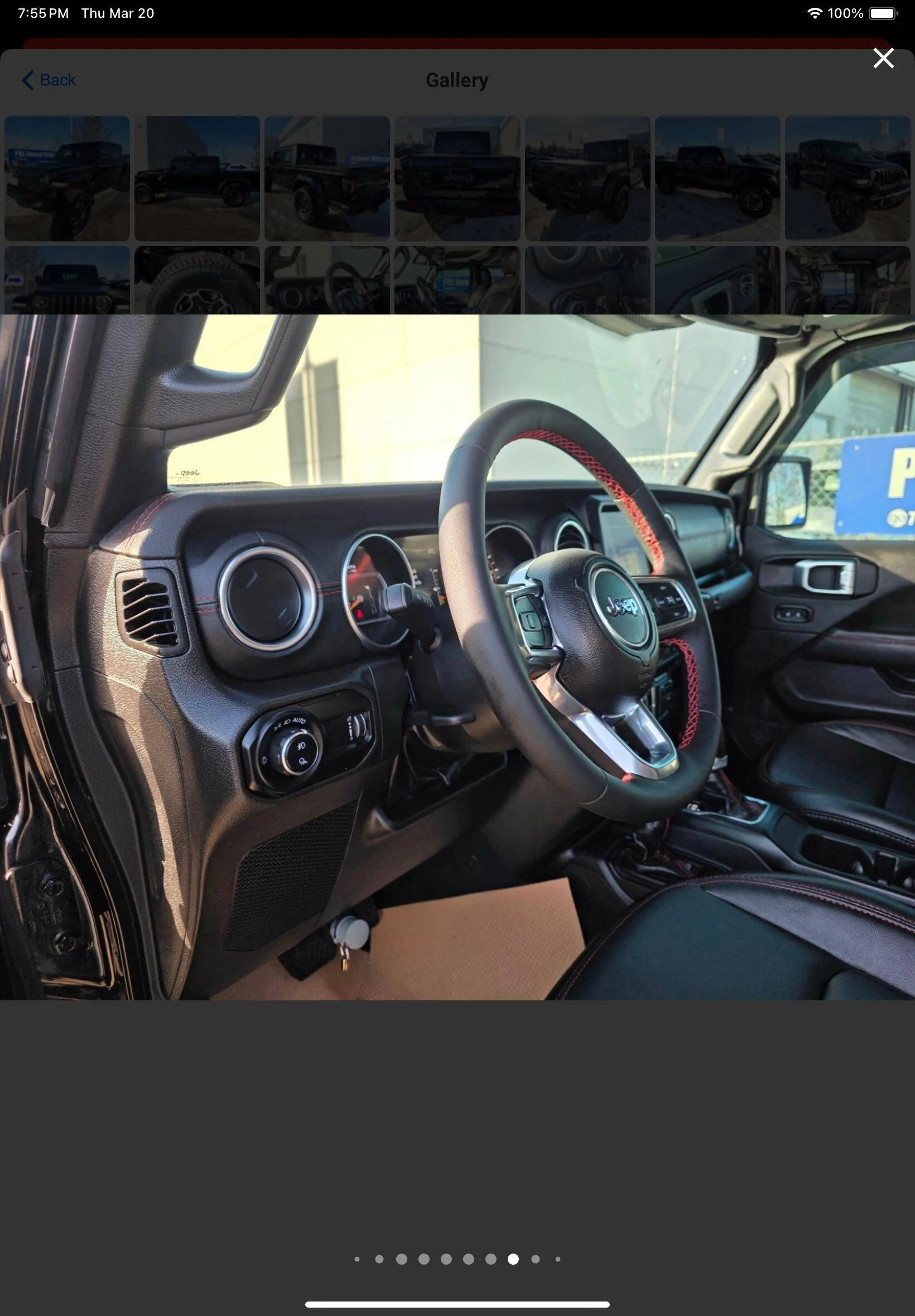

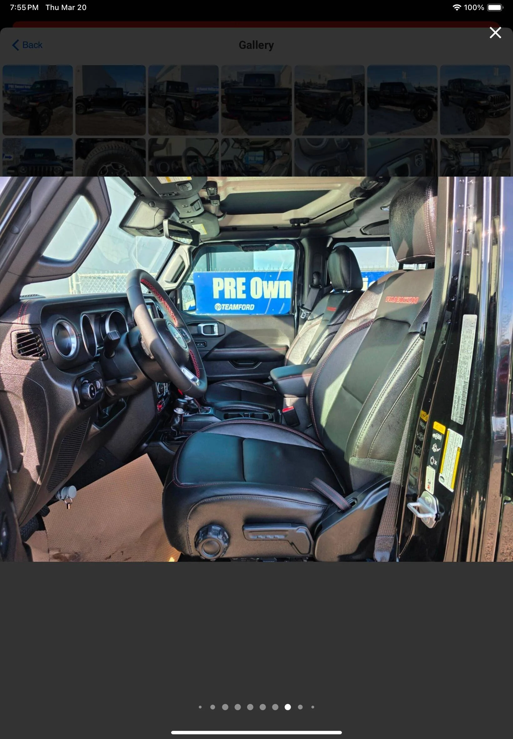

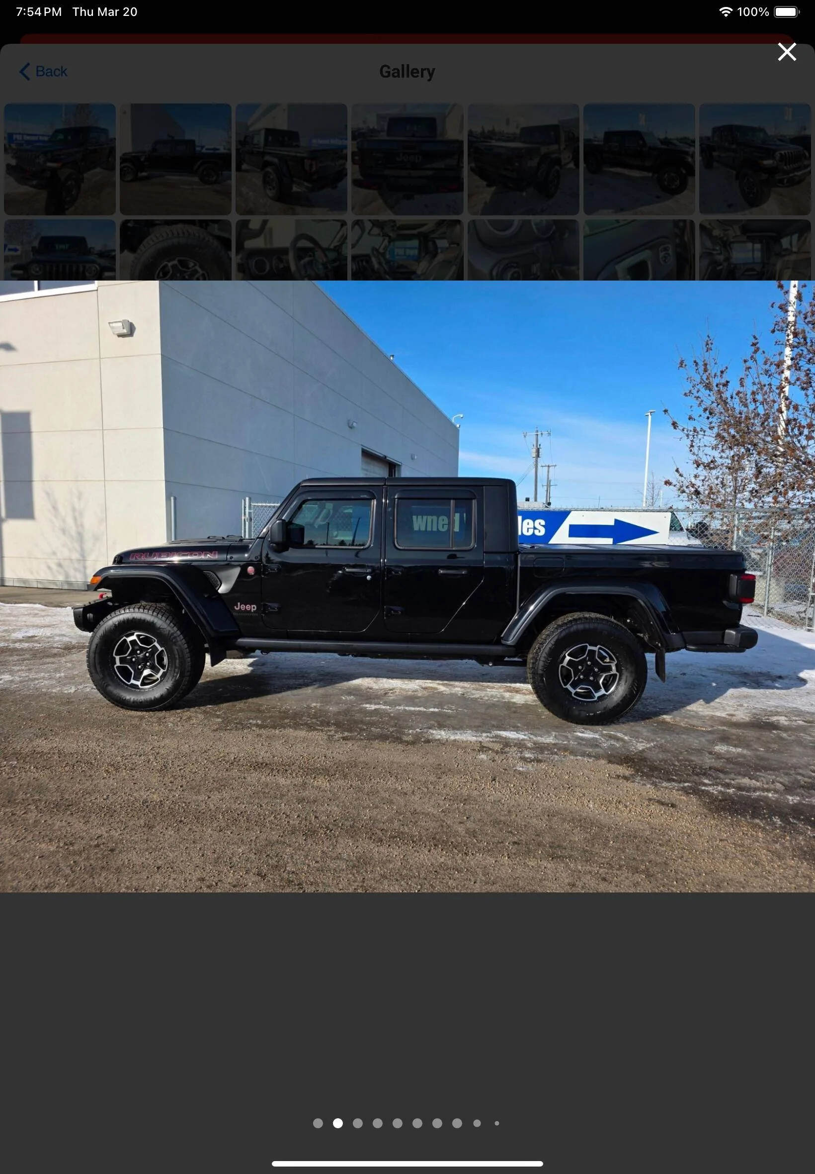

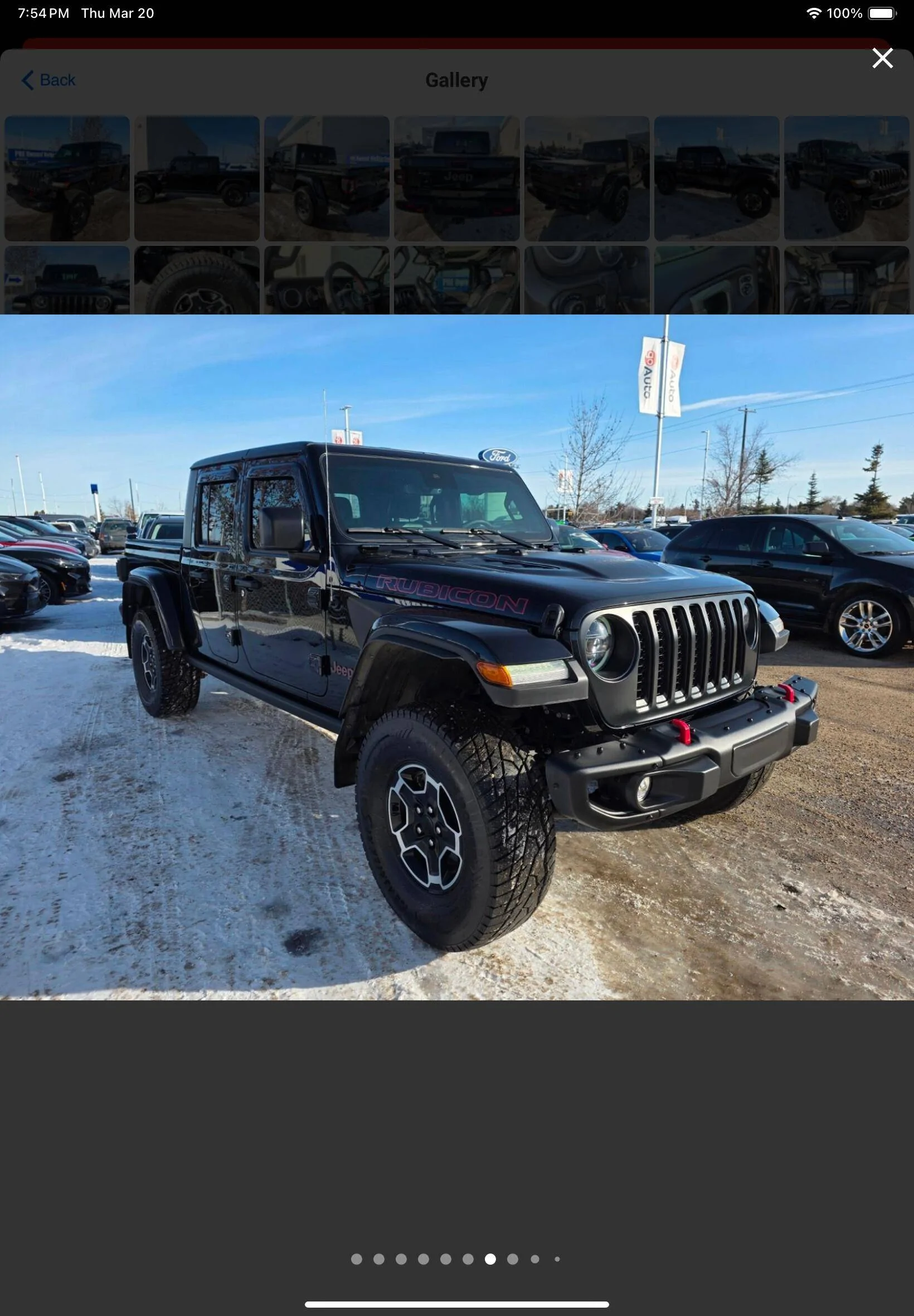

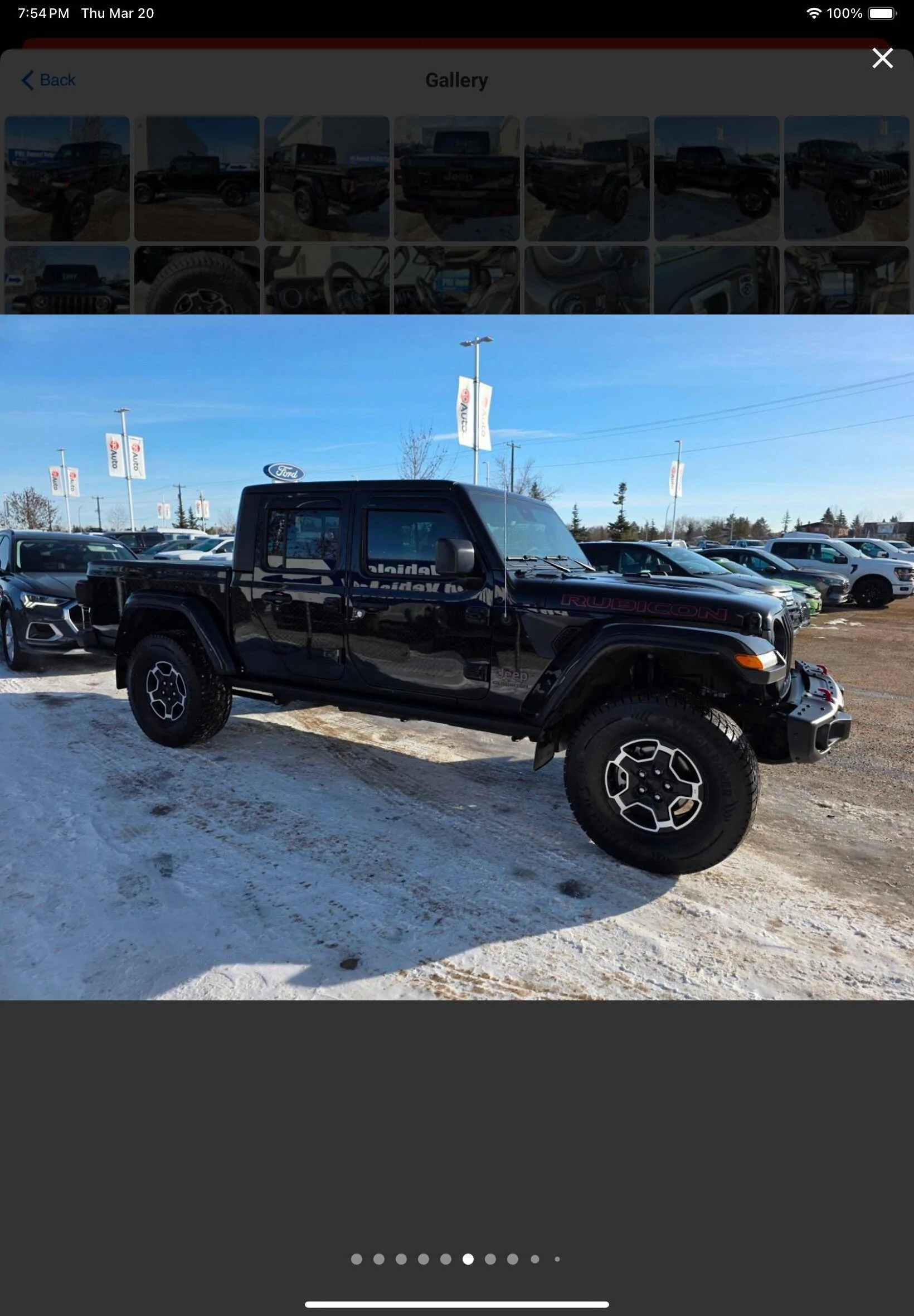

I’ve found a 23 Jeep farout diesel with under 9000kms (5400 miles) . I noticed the Jeep has 35” snow tires, does It look like the previous owner put a lift on it? Also, I noticed a round knob in the area of the OBD2 port. Any idea what that is for? (Its at a ford dealer)

Did some googling. I thing the round knob is a ravelco security system.

I don't believe it's been lifted based on the rear fender gap, but pretty sure it has spacers up front. The nose sits too high for stock suspension.

Since delete's are legal in Canuckia, the knob could be any number of things.
I agree, doesn't appear to be a lift, but a possible level.

Ejector seat button ! No lift but sure would help to see suspension pics.

Yes...gray device is Ravelco. I just put one on mine. Pull the cap...it wont start. DONT LOOSE THE CAP...and you should have two and a registration doc/serial number for replacements if needed.
BTW...$800 add on! Nice!

Bang on. The truck had a rough country 2.5” spacer kit up front. Took it out today, as it was nose high.
Security system is a ravelco, but it only has one cap. The instructions to order replacement caps from the website seems sketchy AF, so I pinned out the one cap I have and made a diagram in case it gets lost.
