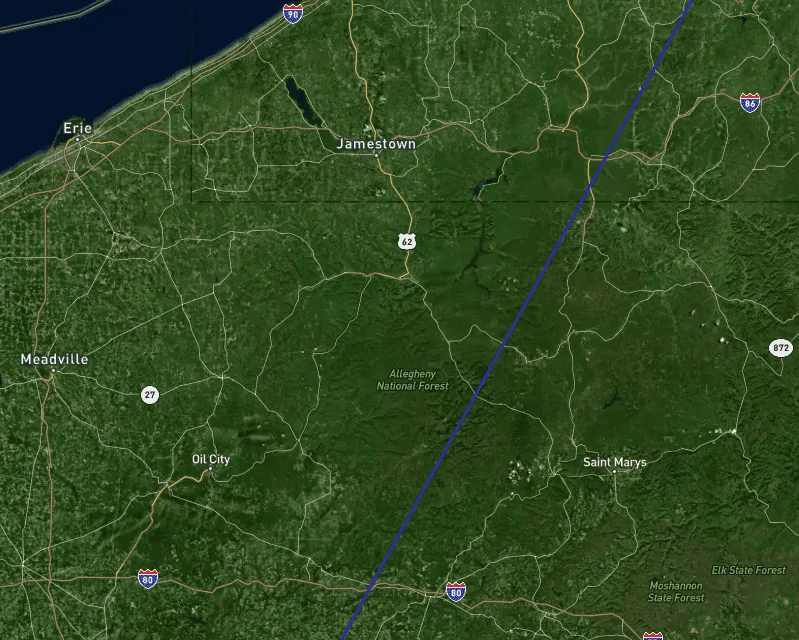

OK, I'm 100% I'm not hitting repeaters. I've purposely not touched repeater settings and I'm 99% sure I've got no repeaters within range of my ghost antenna. (besides tall hills limiting signal, I'm also pretty sure 15 watts won't hit the nearest repeater which is southwest of Buffalo, NY.)
heres a screenshot of my area: (from mygmrs.com)
Jeep Gladiator Can somebody help me understand Antennas? 1696262657988
SO.. The last remaining question is my tone settings. And is there a way to detect what codes other people are running around me?

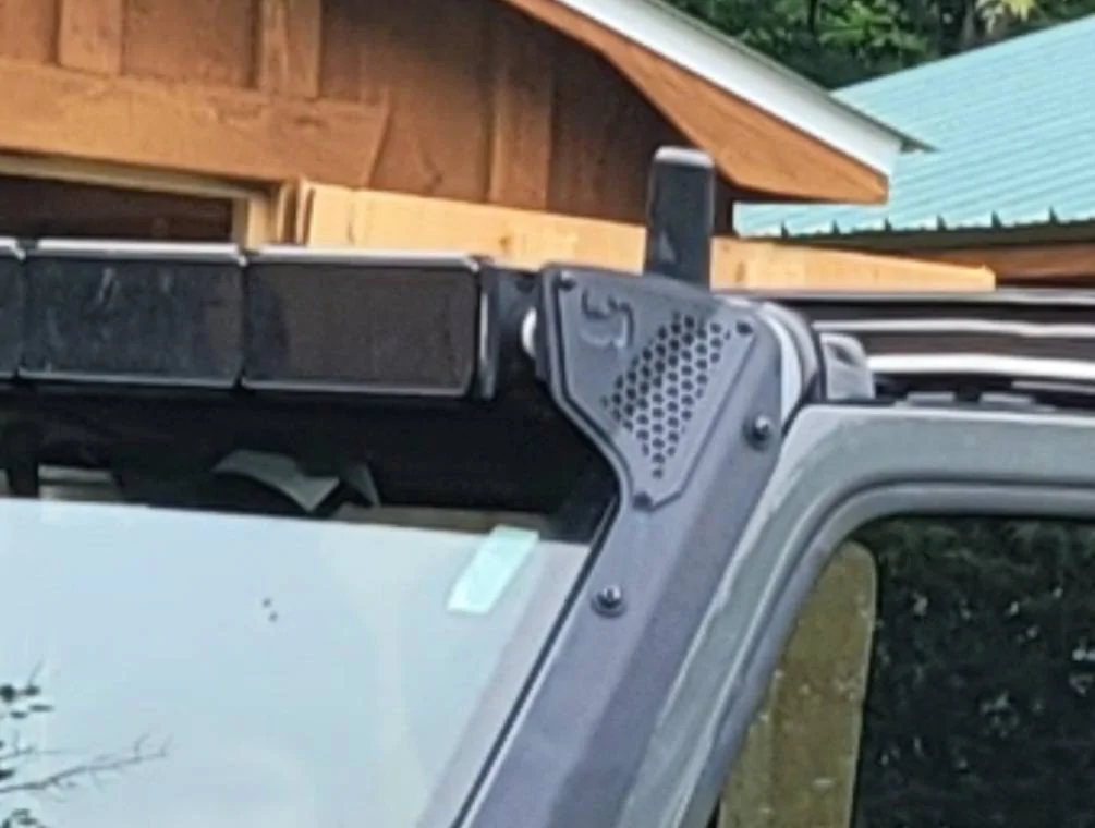

OK, Brief recap:
Midland MXT275 (15 watt) with a Midland 3dB Ghost ant.
It started with what I was fairly confident install with a mount location on TOP of the A Pillar and a light bar. I got decent range testing out with a little FRS in a city area (3/4-1 mile range) then I went on a jeep run and got ignored and/or wasn't heard. So my confidence in my install took a body blow.
The conversation (here) has covered lots of things like repeaters and tones. (I still have to check out my tone settings) Running around town, I hear lots of conversations with the radio on scan. From little kids playing with FRS on channels 1-8 to road crews and an elementary school too. I try to radio check any of them gets zero response. The lack of response can be for a couple different reasons from "who's this moron trying to talk to us" or I'm not being heard.
SO bottom line, I want the best placement for a limited range antenna. I've removed the light bar from the windshield and that leaves the camper shell or a cowl for placement. I've got a cowl mount arriving today but I was also considering mounting it on the fiberglass roof with a metal disk mounted on the underside of the camper shell roof directly beneath the ghost antenna.

For the use your explaining the cowl mount like everyone else is using will be fine. Make sure radio is on CSQ and enjoy. If your in a group of jeeps you don't need a crazy antenna. I run the 275 in my jeeps and as long as everyone is on simplex and no tones it should work fine.
