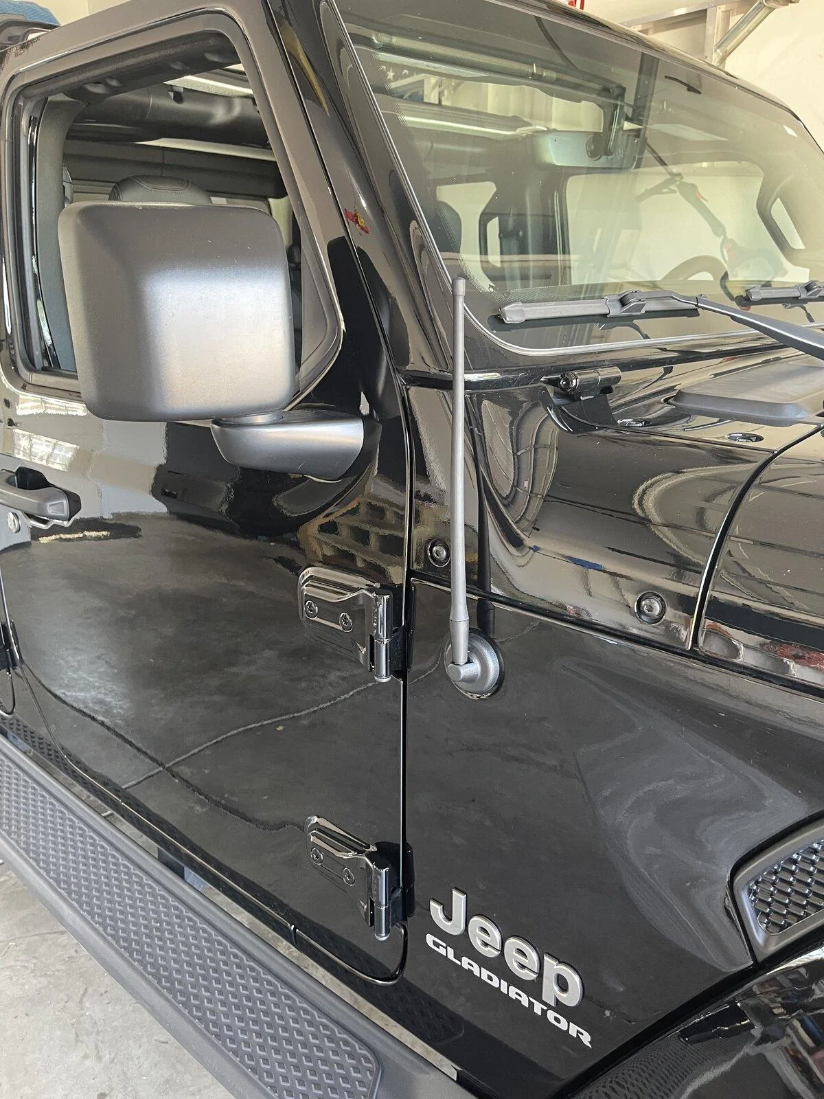

I got this stubby. The only time I have reception issues is when something is overhead. Like occasionally with overpasses, or going into or out of my garage, but only at the section under the metal door itself.
Jeep Gladiator Short Antennas JeepJune6

What length is that one out of curiosity? I think the one I ordered is 16”
