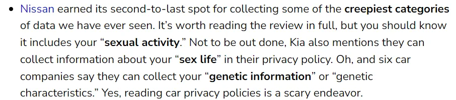

They have direct access, the others via requests and sharing. So to know instantly where you are, only those two would. Cops ask for location, however - or location history, that's different.
I'd really love to know how the heck this would even be possible (see below)->
Jeep Gladiator Has anyone disabled telematics / LTE and GPS antennas? 1694123453991
So they have sensors and collect your DNA and transport it via a transporter device.
And they have embedded cameras and microphones that can follow you when you exit the car (or get into the back seat?)?
That article mentions Google as if that's the fault of the auto maker - nope, that's your PHONE.
People bitch about their car or truck but they still carry that phone around, they still text, they still take and post photos, they still use Google anything - including maps and browsers, they use instacrap, tiktok, fakebook and post till their fingers bleed on those stupid social mediocre sites - then bitch about their Jeep??? Really?
They use Waze, they use their trail map apps, whatever - and then the car collects too much data.
Zuck knows more about you and your life than you do - they can even predict how you vote, your age, what you eat and more - with crazy accuracy, yet ya still use that. And instacrap influencers? Please......... don't whine about what your vehicle does if you use those places.
Now I wonder - what does mozilla do with all the info they collect about you. Most browsers have some history with them - check your browser type, might even say mozilla in it. How did they get so wealthy since their software has always been "free".

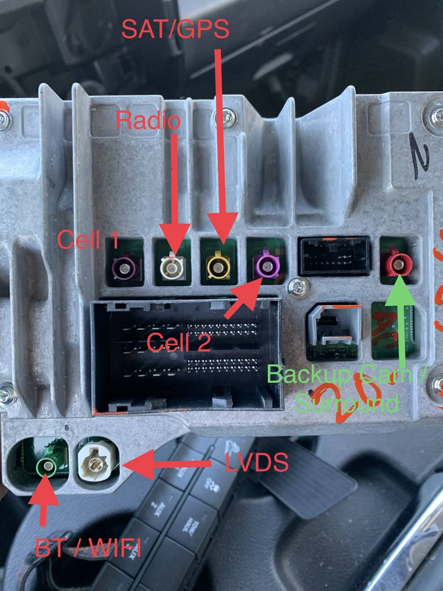

For those interested - disconnecting both the merlot and dark pink cellular connectors on the back of the radio will still allow limited connectivity to SXM Guardian/ATT. Albeit, very slow and limited without the antenna. So this is not fool proof.
For those thinking of exploring their rights to remove the data upload to the mothership through the opt-out process listed in the FCA privacy pages - good luck and be ready for the run around. No one knows what you are asking, and they aren't equipped to handle the request. I went through the process and requested a receipt via email to confirm the request was completed... I don't expect to see it. I also expect I may be contacting a lawyer to explore a class action against FCA Connected Services for their inability to comply or even feign taking action on their published privacy policy.
Jeep Gladiator Has anyone disabled telematics / LTE and GPS antennas? Uconnect connectors
