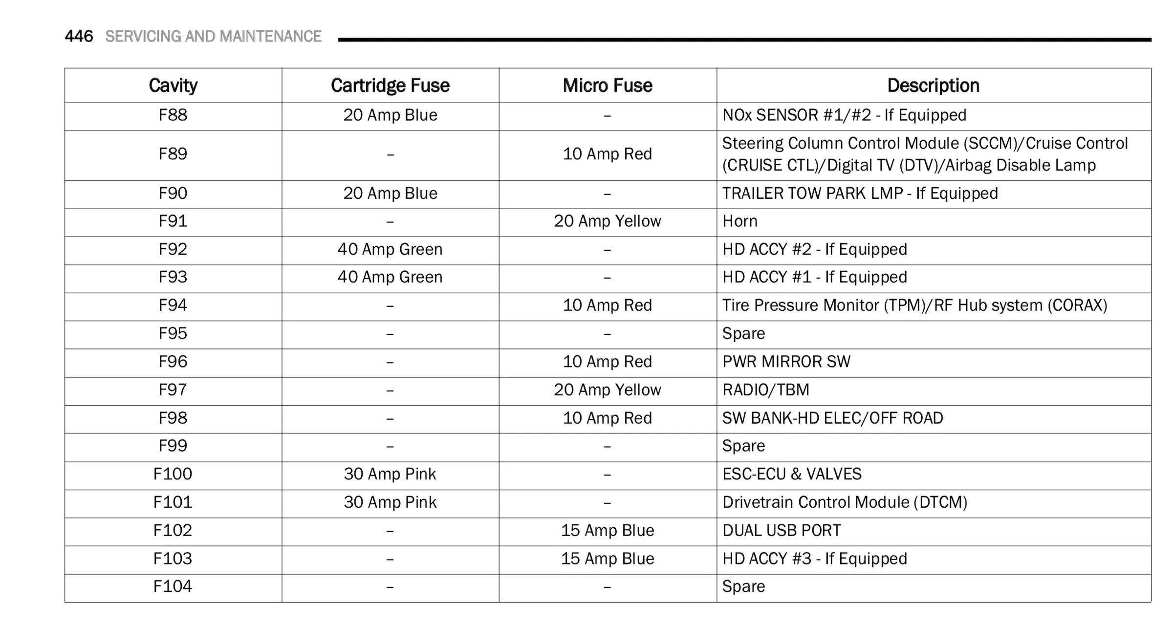

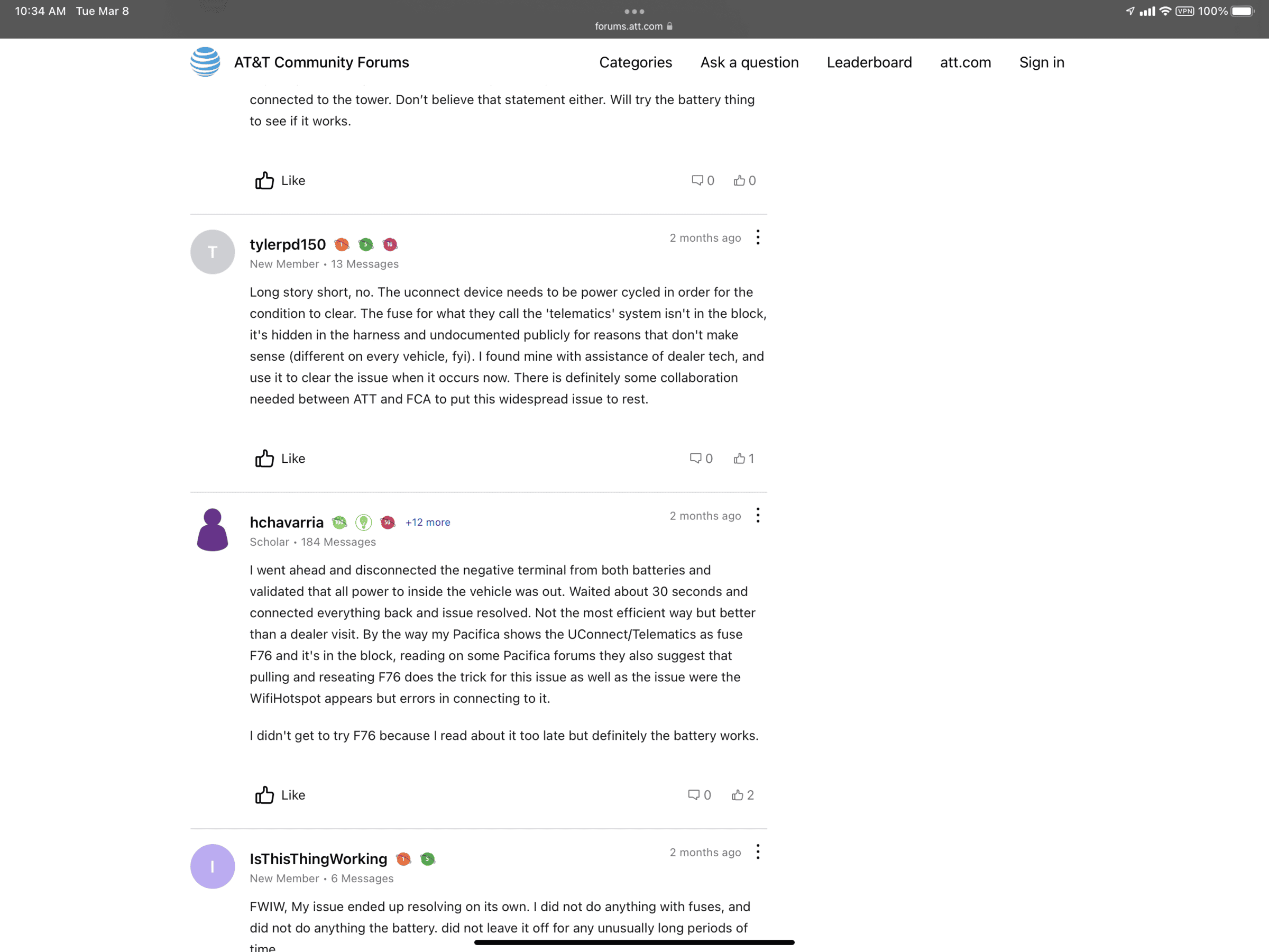

I’m having a different problem. I want my LTE antenna to provide the hotspot and there is an issue with Uconnect and AT&T service at this time. Stellantis knows it’s a Uconnect software issue but they haven’t resolved the problem yet.
I was reading on a different forum that in Stellantis vehicles that there is a fuse to the telematics system that is not in the main fuse Block location. It differs from vehicle to vehicle. Those that want to disable it might be able to figure out where it is. If you do, I want to know too. Seems the only fix right now for my problem is to intermittently pull it and put it back in to reset things.
I’m not good at reading electrical diagrams, or I’d figure it out myself.

Gotcha. I actually do want it to function. I use the hotspot. I just don’t have connectivity (can connect to the Wi-Fi hotspot but no data). I did just find a fuse to pull and try to reset (fuse 97). I’ll be giving that a shot.
What does 97 do? How is it labeled? Where is it located?
Thanks
97 is labeled “radio/tbm”. It’s a Yellow 20a. Fuse locations are listed on the underside of the fuse box cover.

And it doesn't shut down the actual radio. Just the tranciever?
You may have just found my holy grail. An easily defeatable. Easily reversable. Non destructive way to turn off telematics.
No, removing that fuse will disable the radio as well.
