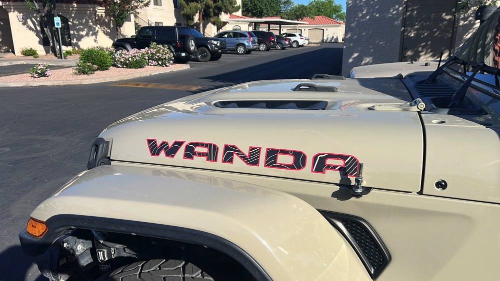

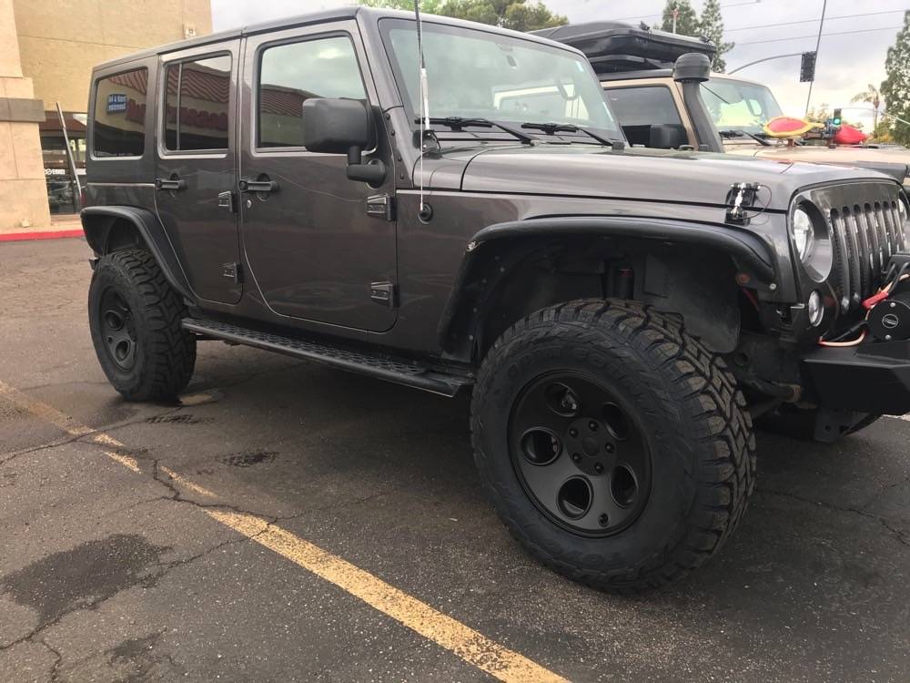

@Alpine Warthog
I am far from being an expert on radios, they are a "necessary evil" IMHO. I struggled finding a good place to mount an antenna on my Wranglers until someone (who supposedly knows about radios) explained to me that the antenna needs to sit on top of a large metal plane; which the fiberglass roof is not. He also explained that the tire carrier mounts for Wrangler are poor choices as well.
For my Wranglers, I bought a set of ditch light mounts and put one on each Wrangler (you can see on my wife's Wrangler in this shot):
Jeep Gladiator Can somebody help me understand Antennas? newwheel2
And for the Gladiator, I decided to try one of the hood gutter mounts (you can see just right behind the second "A" in WANDA):
Jeep Gladiator Can somebody help me understand Antennas? 02_NewBadging_1.JPG
I can't say this would fix your issue with any certainty, but it certainly solved my issues.

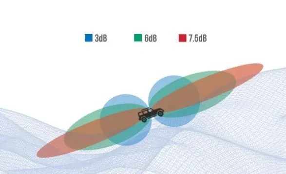

Sorry if I missed it in the replies but are you trying to reach others via GRMS repeaters? Or simplex. Technically that midland graphic is correct. The more gain an antenna has to more focused the beam. For instance, they could give you a 15db gain antenna and it would be great for flatland simplex but could hinder you when trying to hit a mountain top repeater. You can get no ground plane antennas that can be mounted on fiberglass and such but usually requires a tuned length of cable. The idea of mounting an antenna on fiberglass with a metal plate counterpoise (Ground plane) is a common solution and is actually what most Law Enforcement wranglers have done if they end up using the roof as a mounting point.

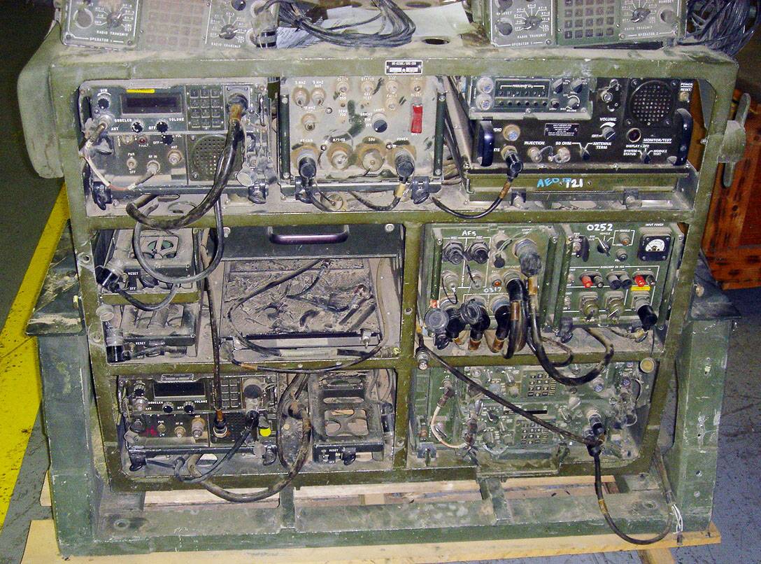

Looks like an old FAC setup for a HUMVEE using some PRC-113s, SINCGARS and a PRC-104 HF exciter in possibly a Harris adapter/mount. Where did all the crypto gear go? Anyway I believe your setup is probably working as expected for the radio and antenna you have based on the 1mi range you got to an FRS handheld. I also believe the problem is you are trying to contact other GMRS users who may be on a distant repeater and you are either too far away trying on simplex or they are tone squelched and simply cannot hear you without the proper tone.

Can somebody help me understand this graphic I found on Midland's site?
GMRS and most FM/commercial/public service radios use one of several tone coded squelch types that keep their radios quite unless you use the same tone as their group. Its similar to the 150Hz tone in some of your green radios above except there is about 200 or more to choose from in the GMRS/commercial radio world.
I'm about floored that there's anybody that recognized the good ol' GRC-206 (this one is a V3) Mine was mounted in a Hummer from 89 LOL.
We were just fielding the v5s when I left the career field. (In the pic the 55, 99 were still considered classified so they were yanked. )
