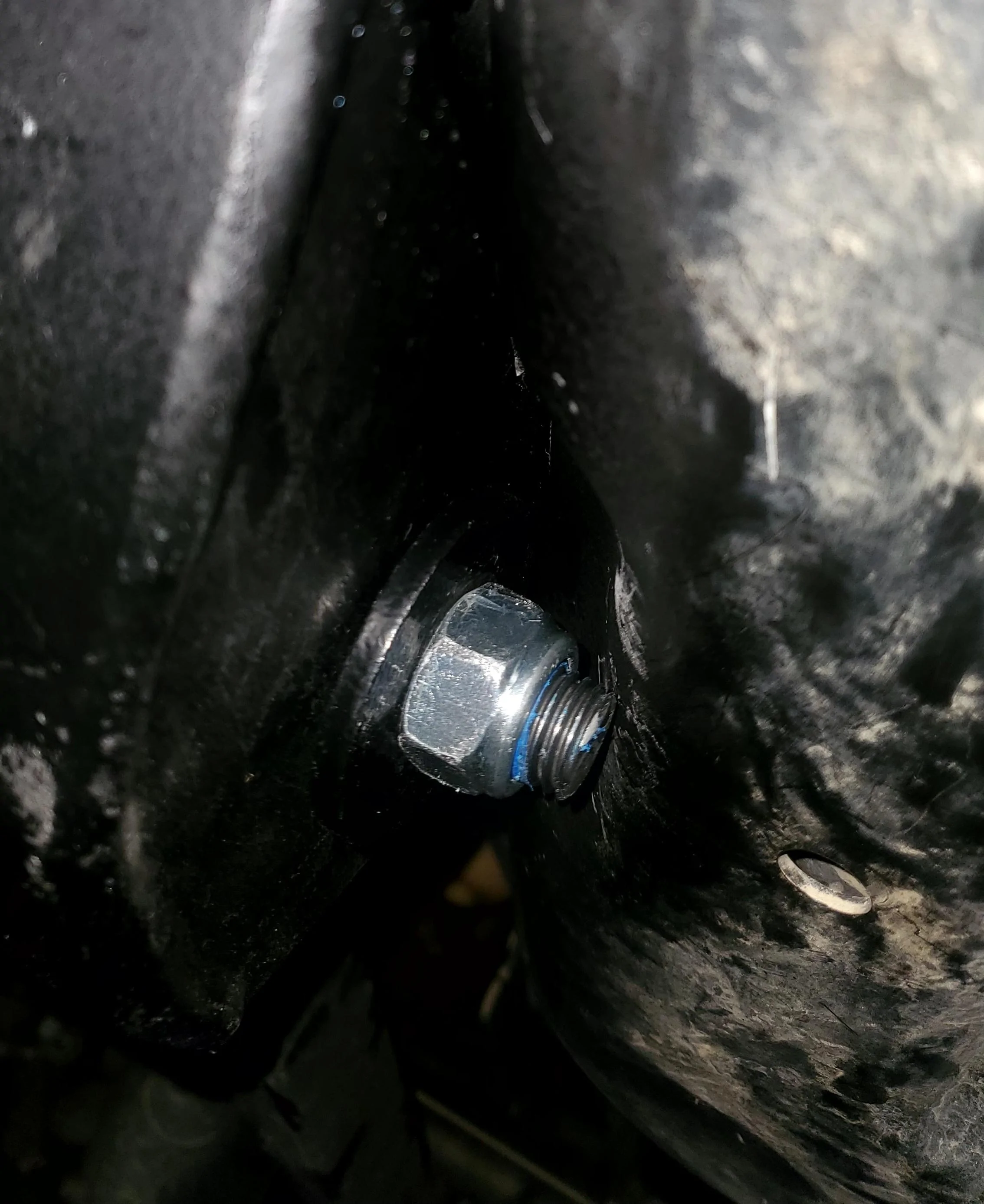

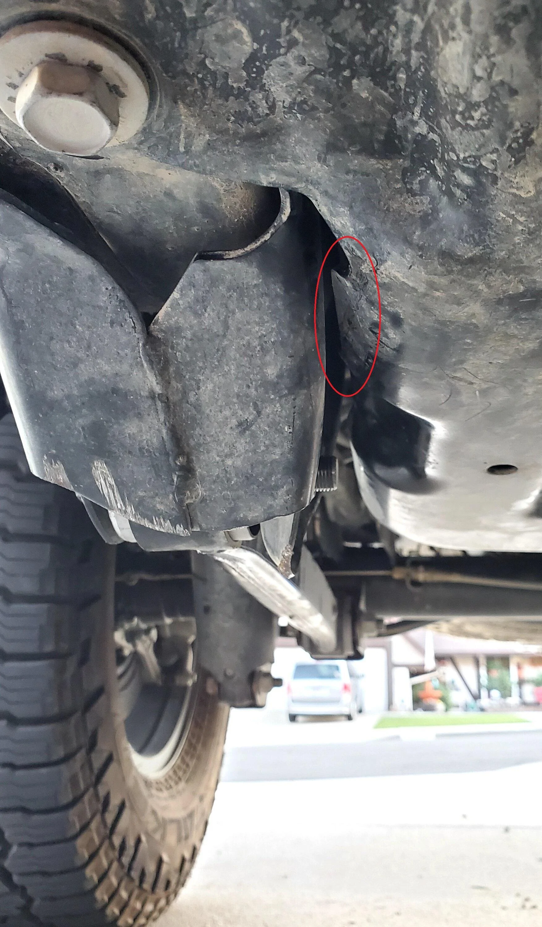

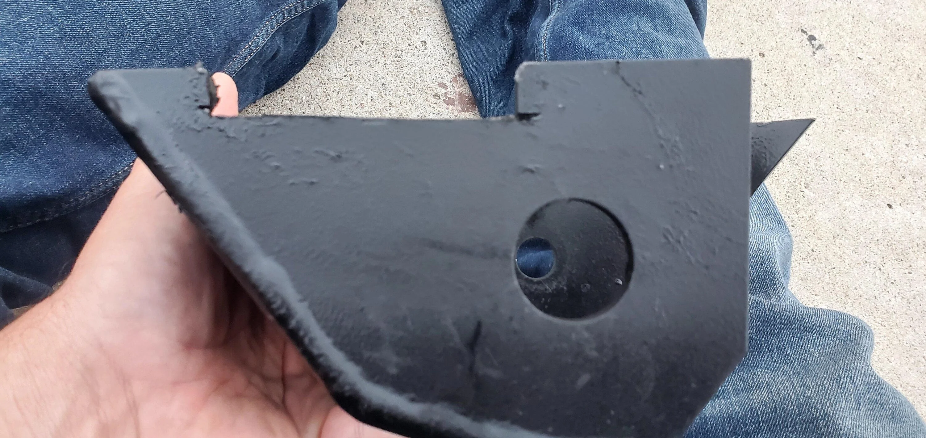

Passenger side rear LCA....frame side. Curious if my gas tank skid is closer to my LCA mount than most people. Rock Hard LCA skid does NOT mount. Fought with it for 2 hrs today. Even the bolt is too long....would need 5 washers to avoid contact with the skid. Sigh. The red circle is the interference area.

Could you remove the tank skid first and then install? I have those to install too.
You can't remove the tank skid as it is the "mount" for the tank. I tried loosening the bolts and shoving the tank more inboard - no luck. Gonna just grind/cut the skid down.
I'll get back to you when I try and put my skids on.
Thanks! I feel like I have the worst fuel skid ever tho....first guy to experience this. Talked to Rock Hard today. They've never seen that tab so close. They said no problem grinding their skid to clear...and to send them pics and they'll probably revise the part.

Thanks! I feel like I have the worst fuel skid ever tho....first guy to experience this. Talked to Rock Hard today. They've seen that tab so close.
I have a Rubicon, but I doubt it is different. I have a meeting, but I'll try and get under it tomorrow.

OK they're on. Lol.
