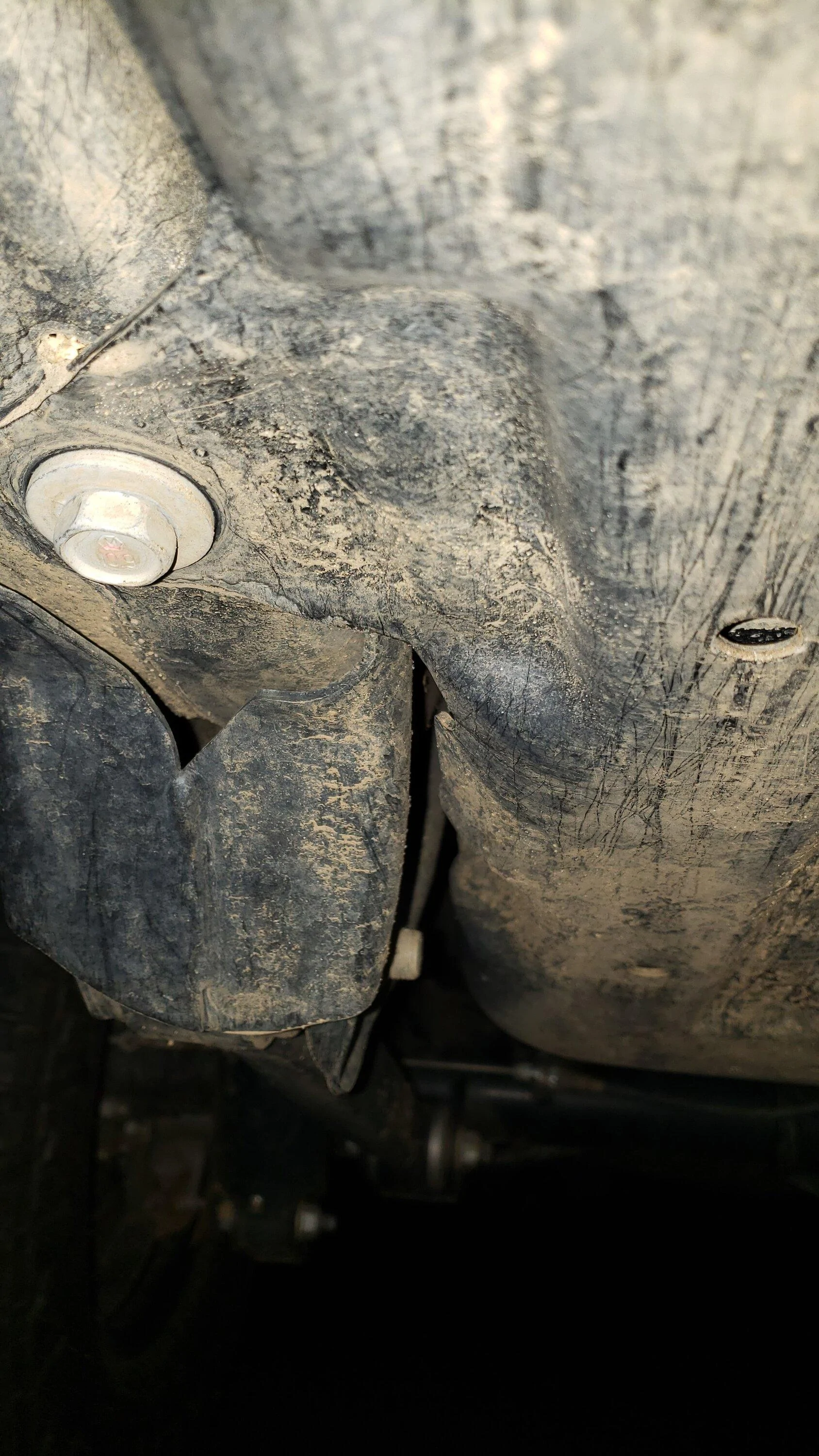

Passenger side rear LCA....frame side. Curious if my gas tank skid is closer to my LCA mount than most people. Rock Hard LCA skid does NOT mount. Fought with it for 2 hrs today. Even the bolt is too long....would need 5 washers to avoid contact with the skid. Sigh. The red circle is the interference area.

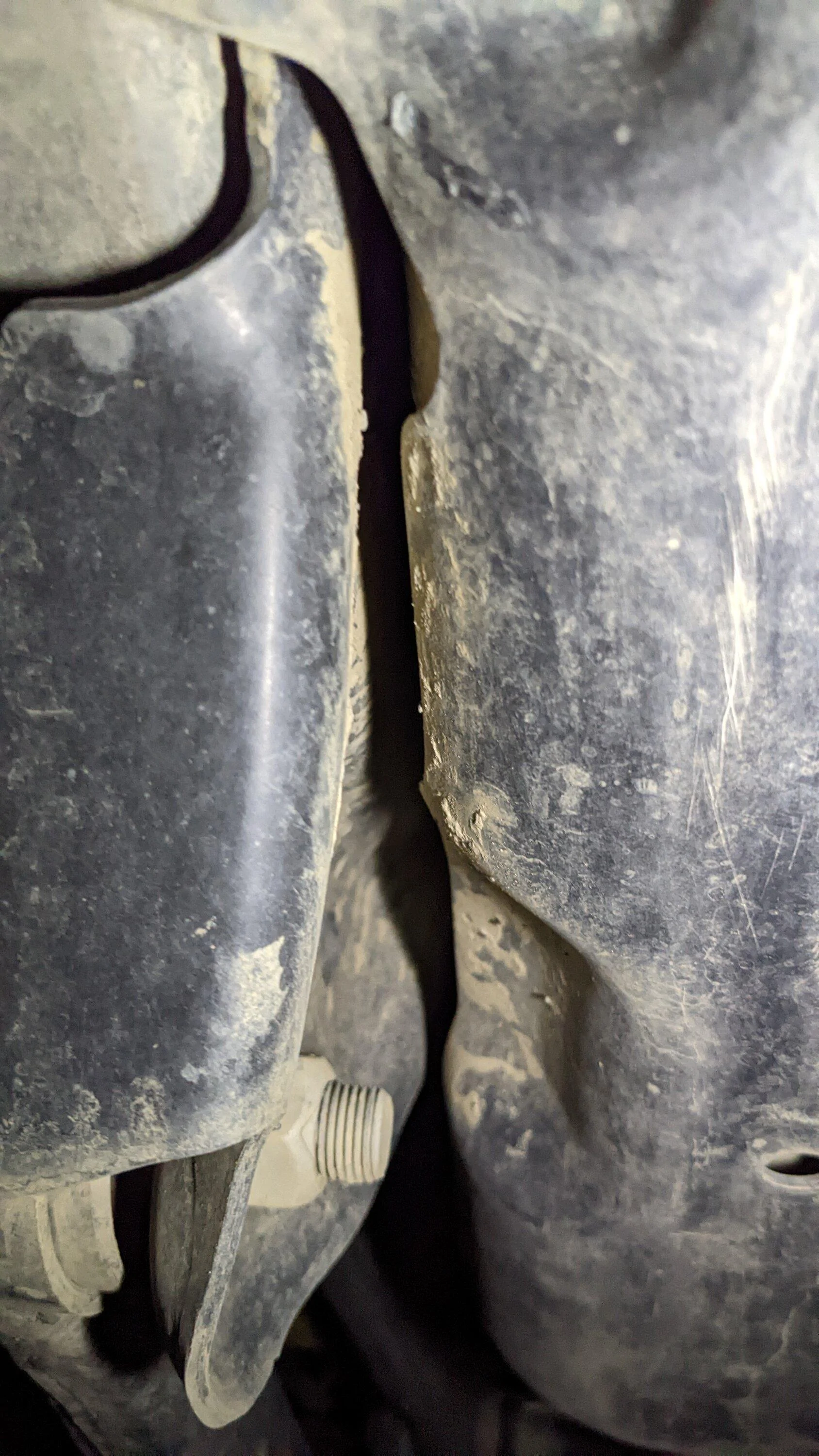

Jeep Gladiator Can someone please take a pic like this one? LCA_Passenger

Awesome thanks....def looks like you have more room....like your tab is bent up instead of out like mine.
I can see what you are talking about. It definitely looks like yours is more outward bent.

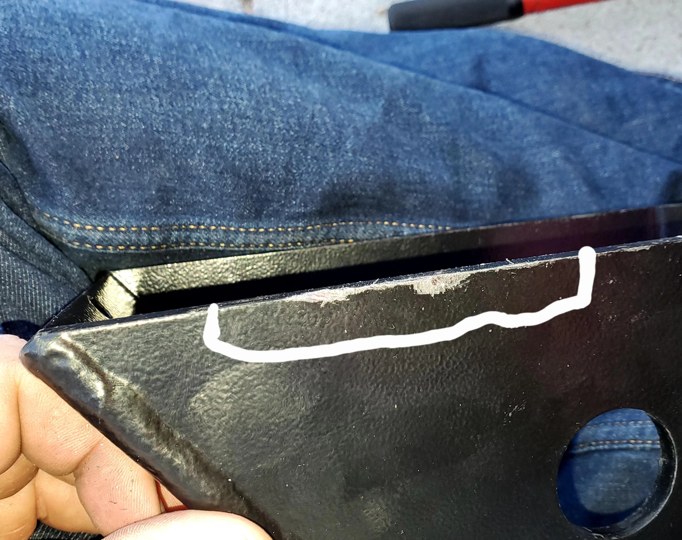

Couldn't move the fuel tank over. I'm just gonna cut the skid where outlined. The material there isn't needed at all.
