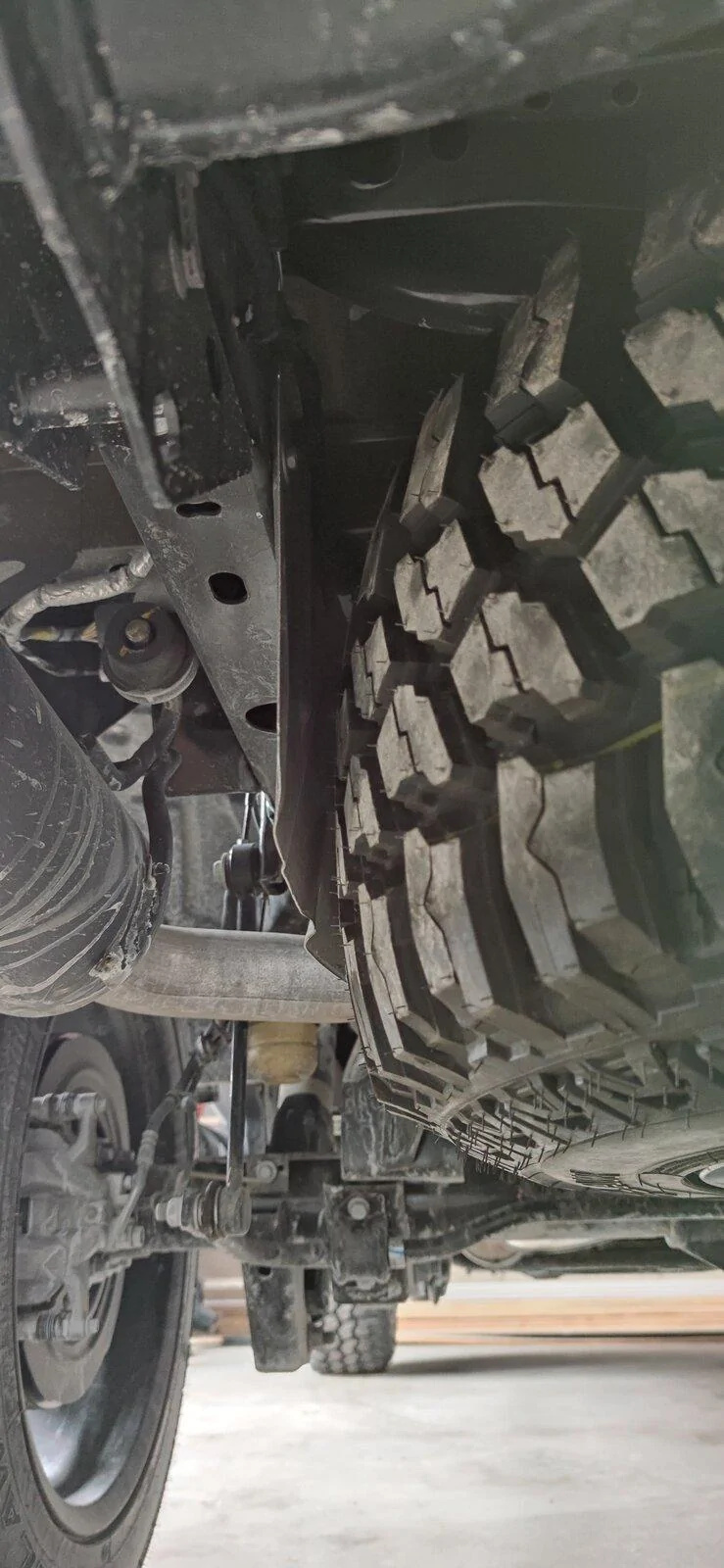

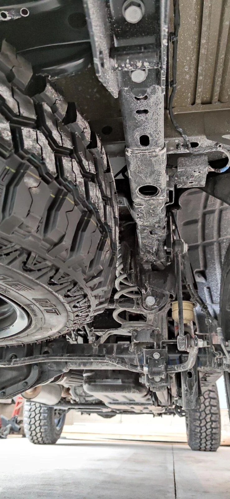

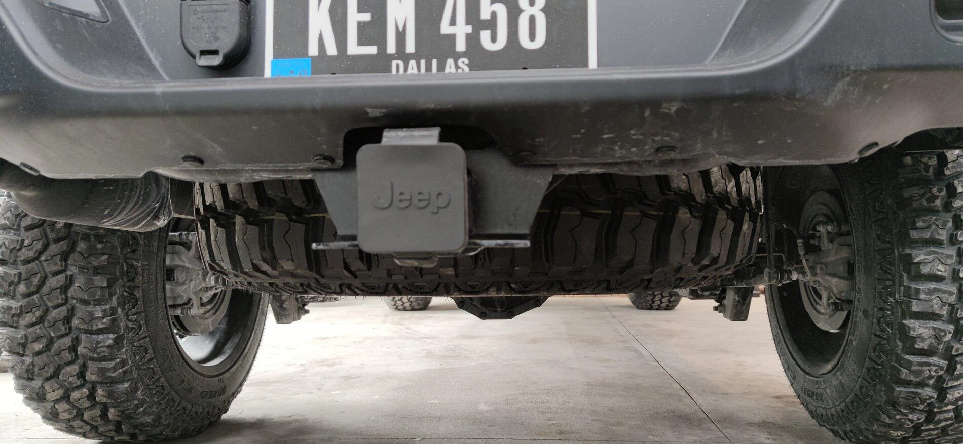

Here is my 35x12.5x20 with 12" wide rim . Fits just fine without any problems. I think 37 will fit as well. I could move the tire around for sure. I don't see why not.
Jeep Gladiator Can the spare tire housing accept an 18" wheel? IMG_20210212_140041
Jeep Gladiator Can the spare tire housing accept an 18" wheel? IMG_20210212_140034
Jeep Gladiator Can the spare tire housing accept an 18" wheel? IMG_20210212_140028
Jeep Gladiator Can the spare tire housing accept an 18" wheel? IMG_20210212_140020

The wheel size is irrelevant. It's the TIRE size that determines the fit.

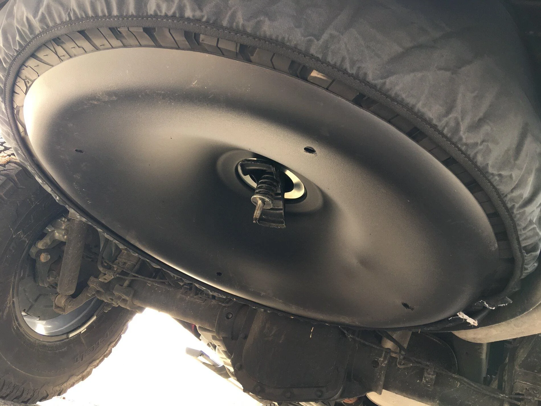

To me, that looks like a waste of money.
The spare is tucked up in under the bed, out of the sun and most of the weather, why would you need to cover it up?
I've not had a spare on a truck, that's up under the bed, go bad due to weathering. And the JT is far from my first truck.

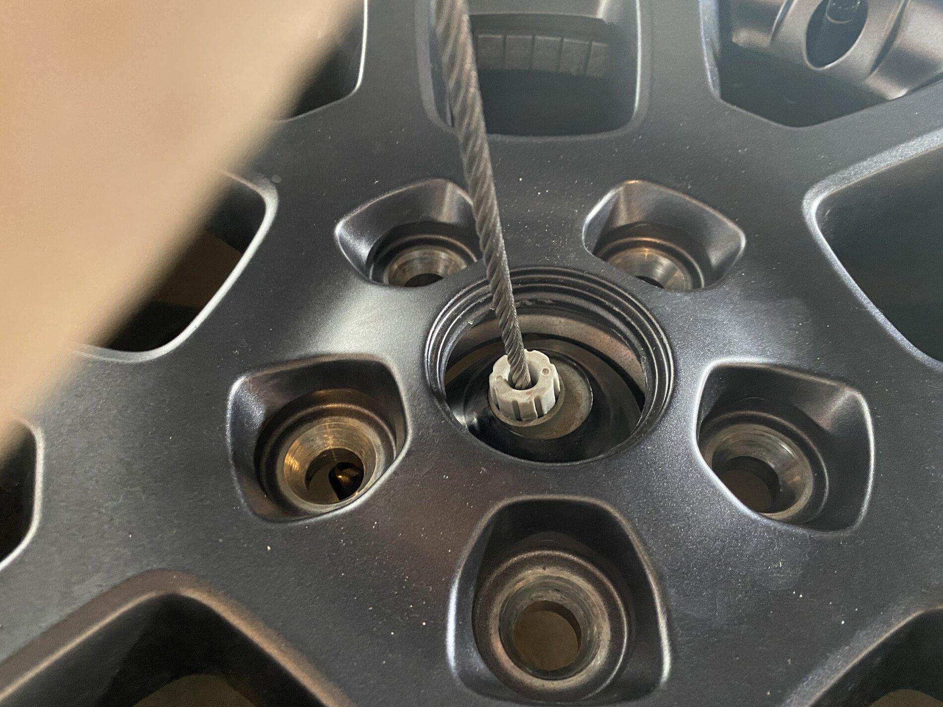

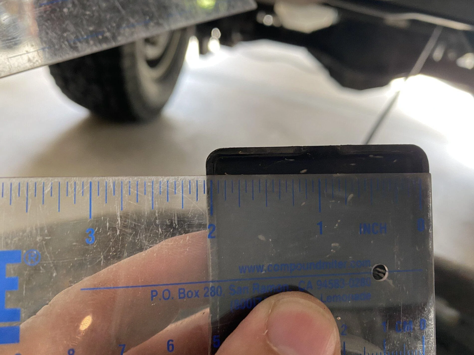

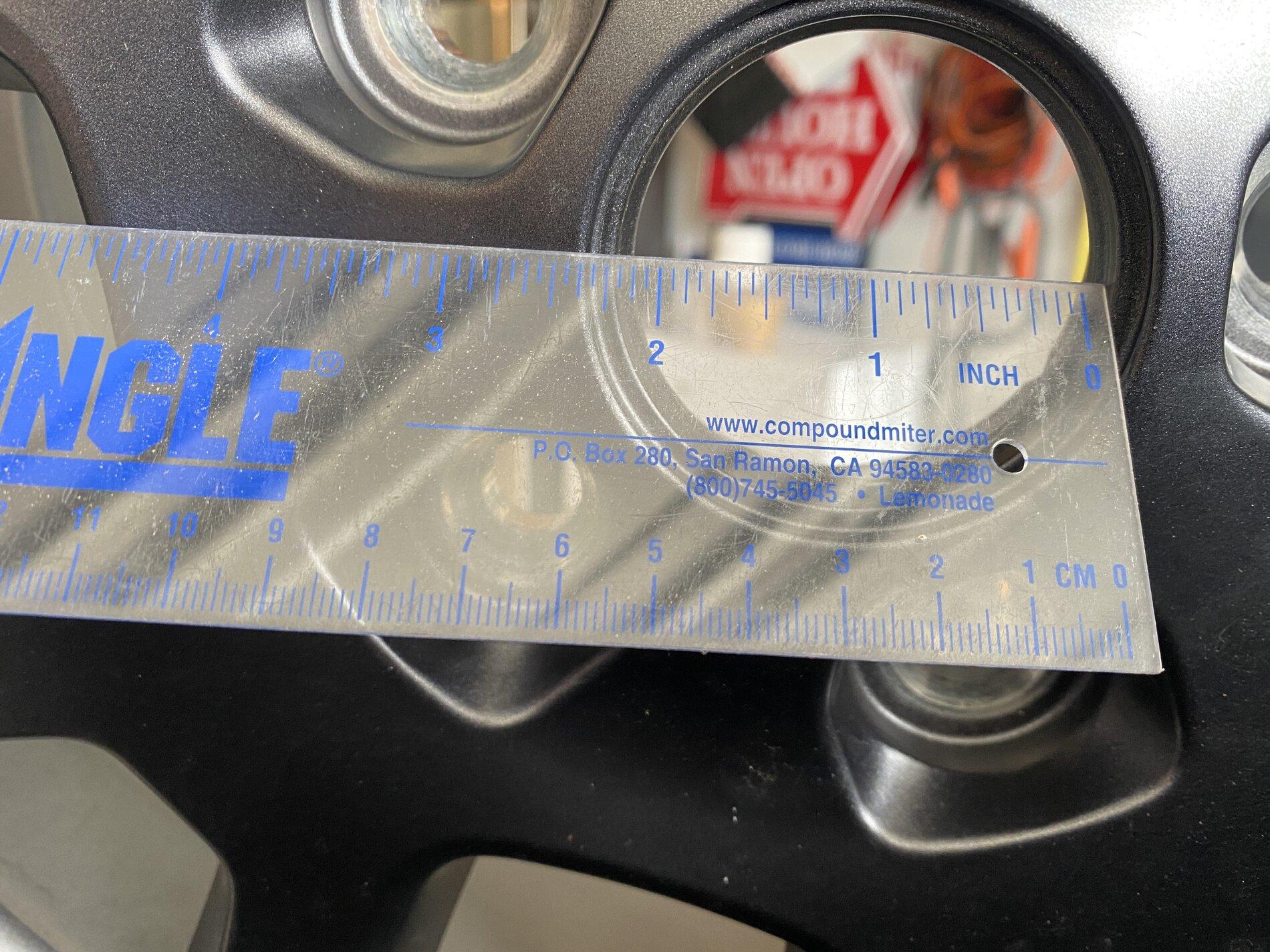

Here are my results: Dropped the spare - measured the center hole on the Overland rim used for the spare.
Measured the wing that has to go through the hole:
Jeep Gladiator Can the spare tire housing accept an 18" wheel? IMG_4585

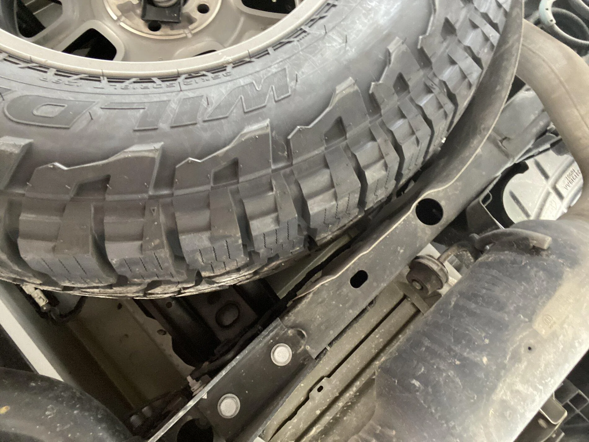

So the wing is smaller than the rim hole. Sounds good so far. Dropped the assembly through the hole (good side up) and after a bit of wiggling, success! The challenge wasn't the wing, it was the spring assembly on the spare cabling was putting pressure on the wing - so after using the mark 1 'bang it a few times with my hand' method it passed through.

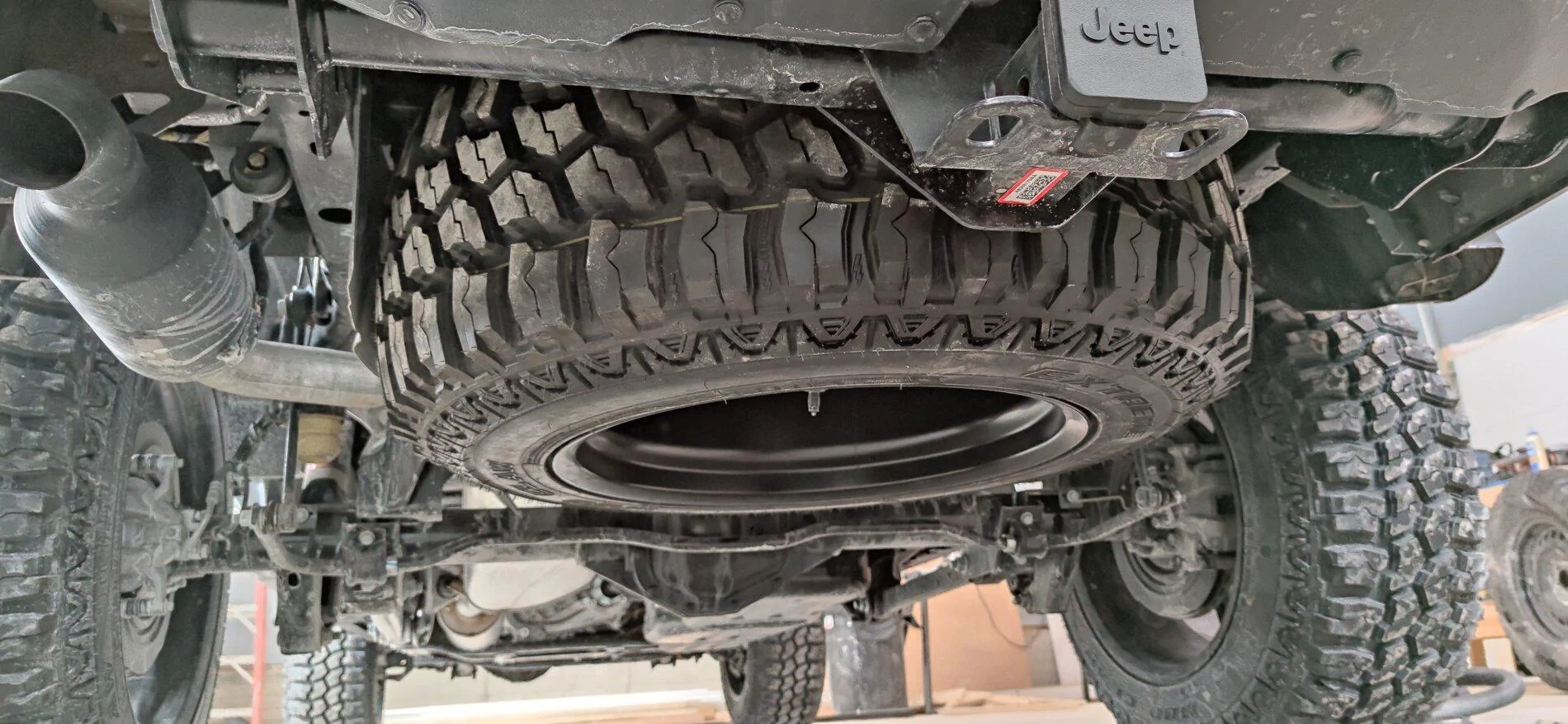

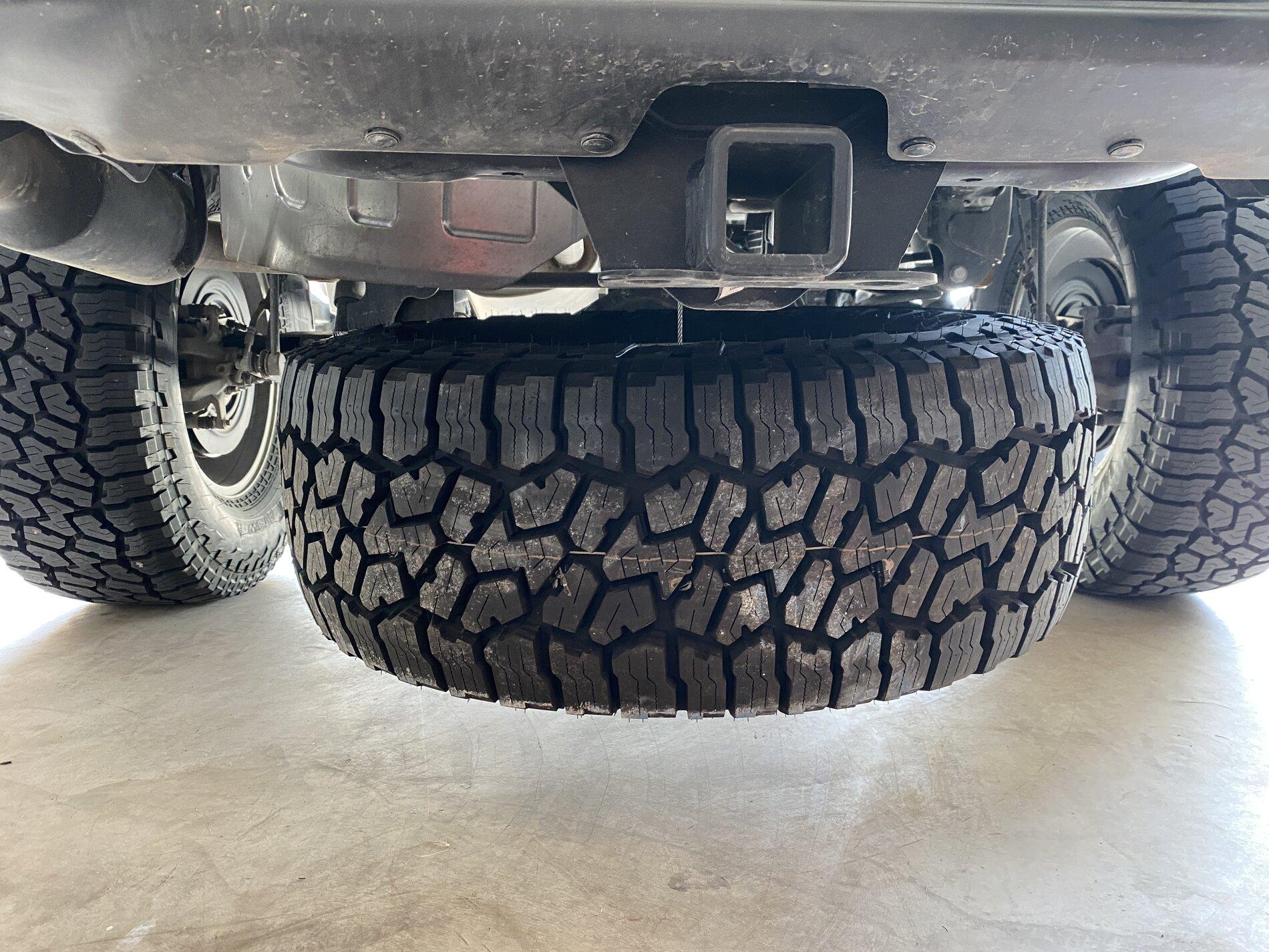

Cranked her back up and fit fine. And these 35's seem really big, but room to spare.
Jeep Gladiator Can the spare tire housing accept an 18" wheel? IMG_4589
Hope this helps out anyone with an 18inch OEM Overland wheel looking to go bigger on the tires! And thanks to respondents who got me off my butt and in the garage (It's always best to try it yourself!)
