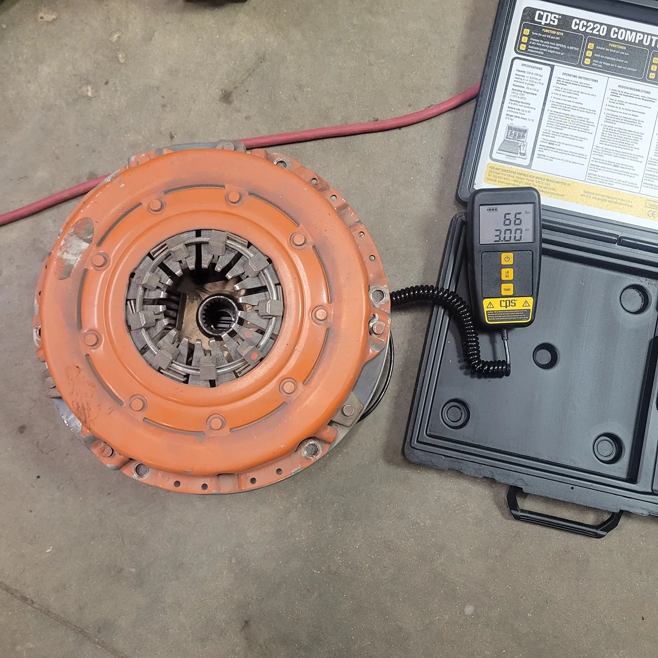

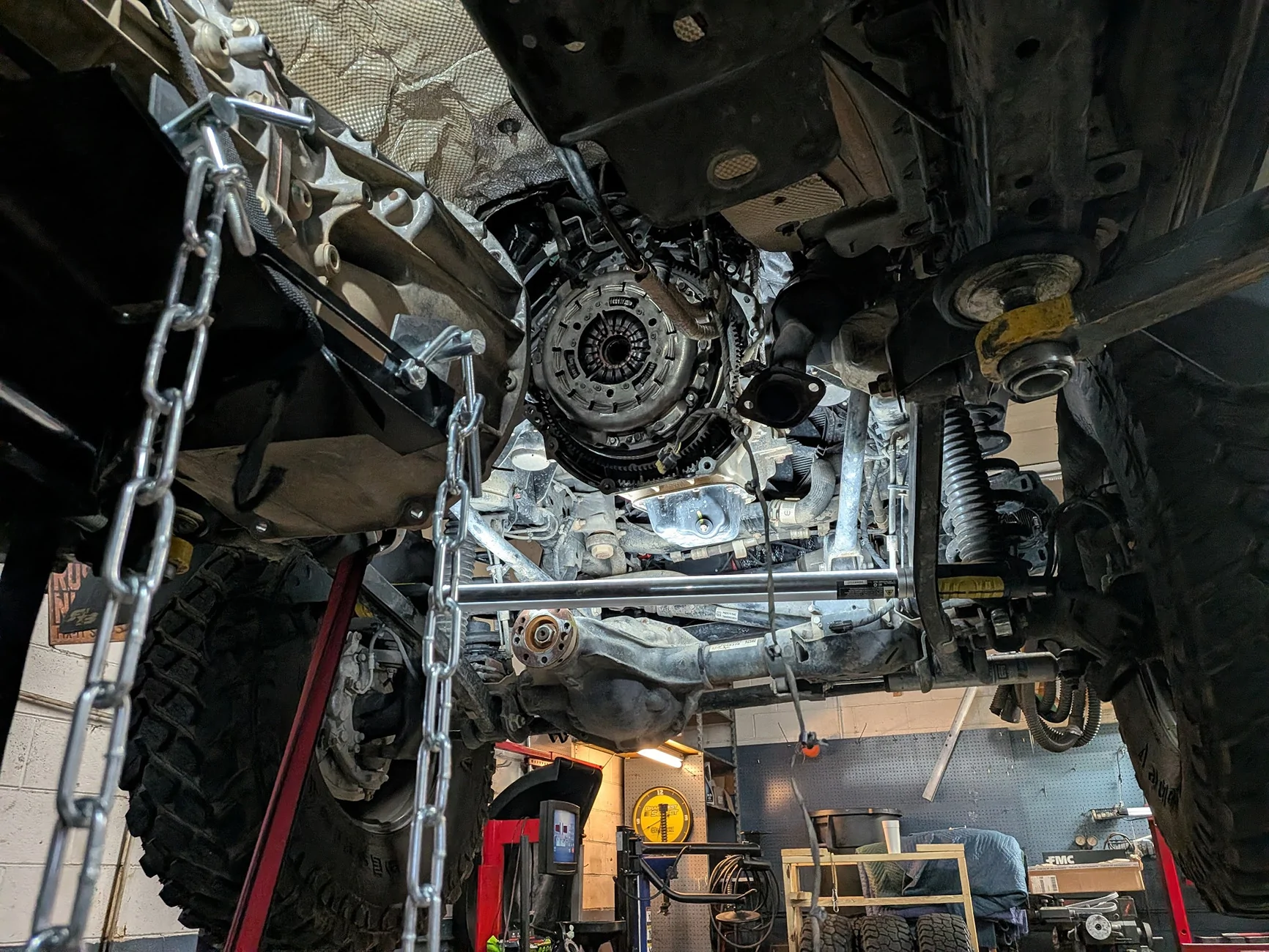

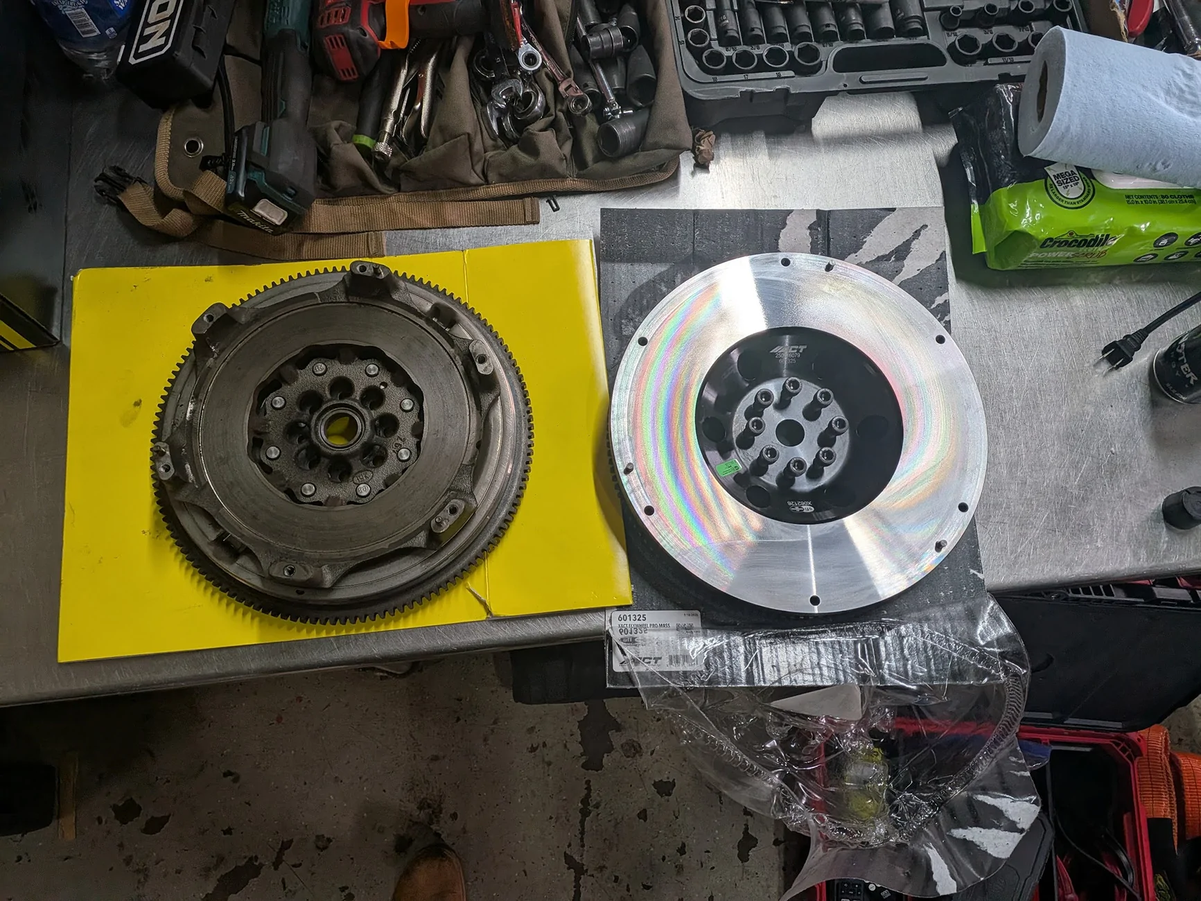

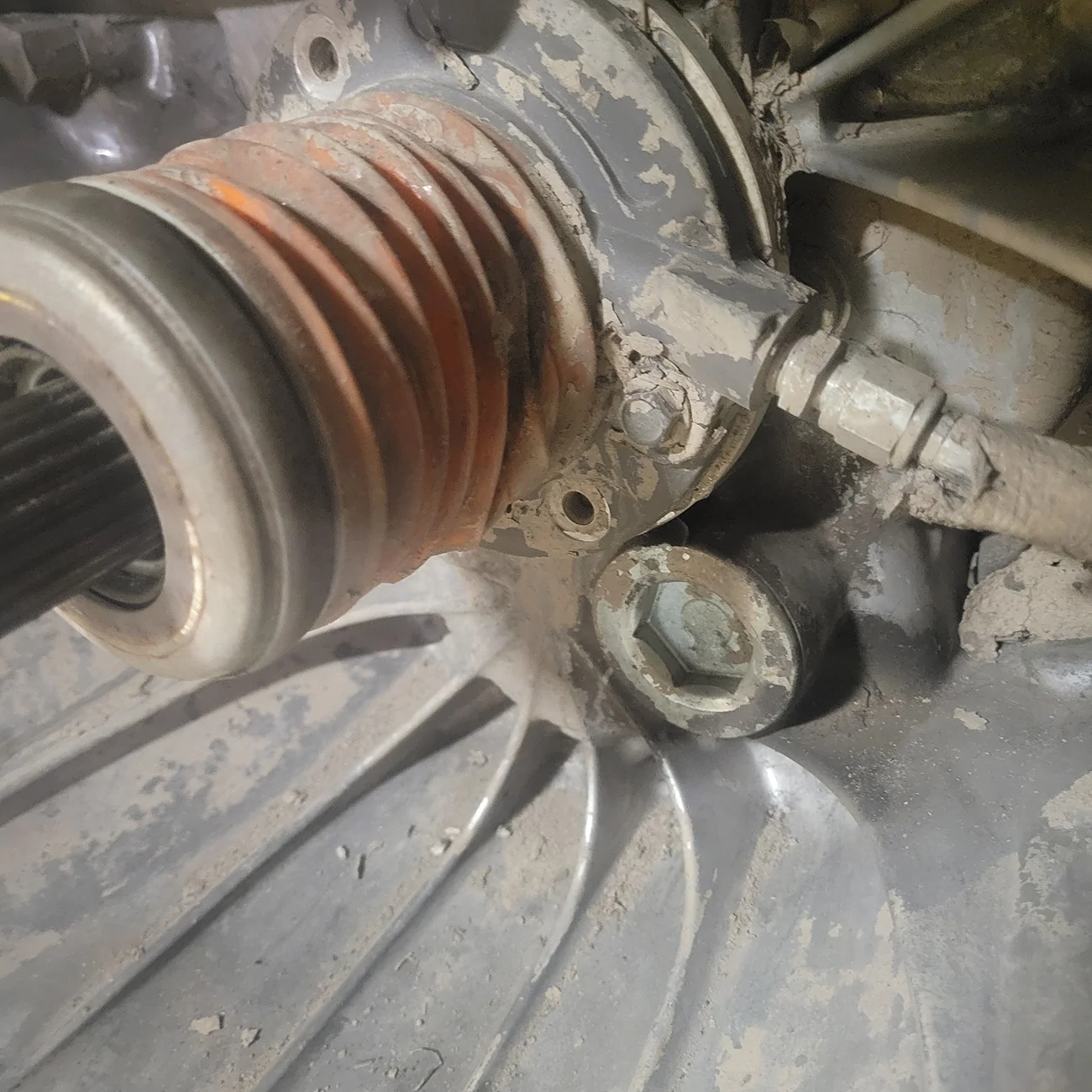

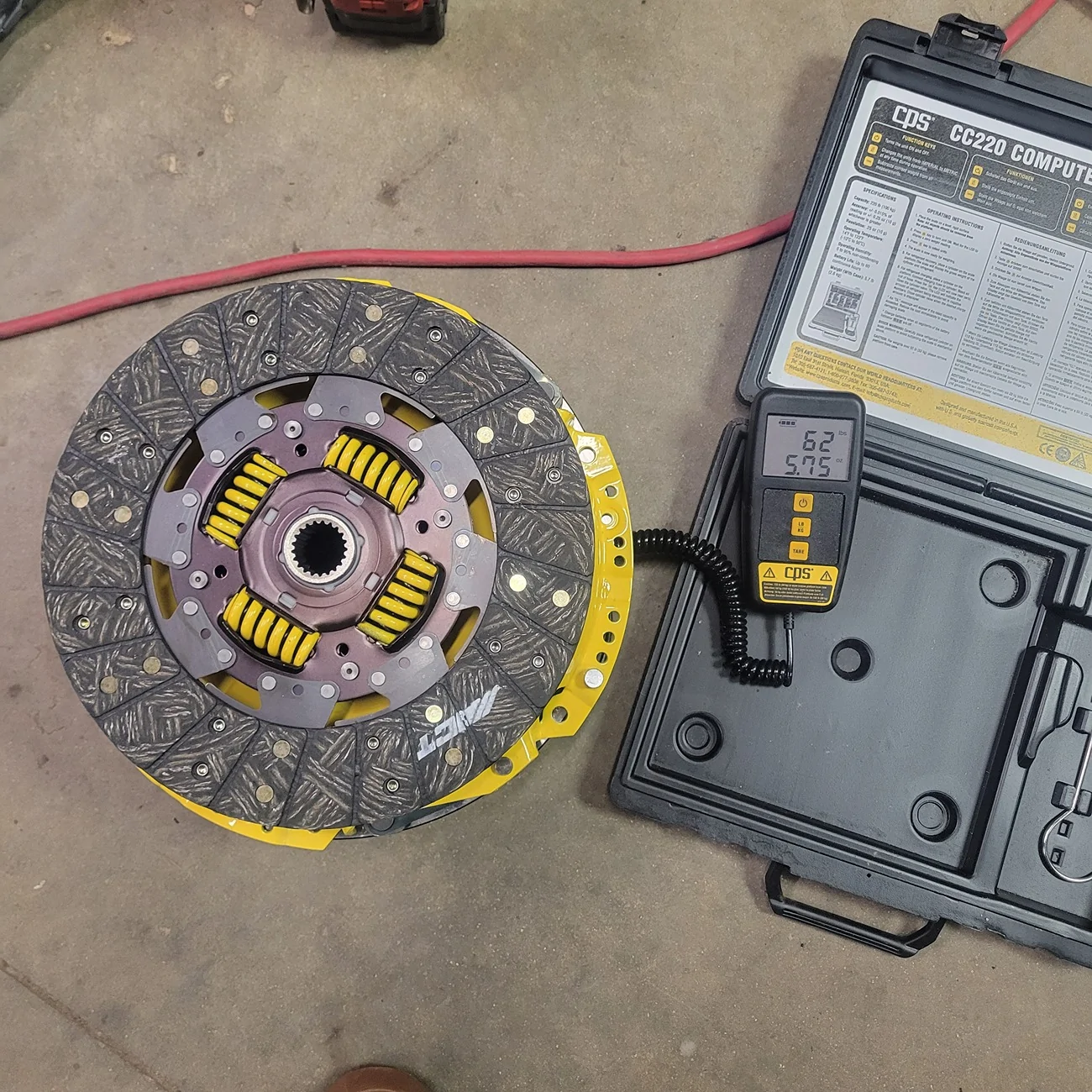

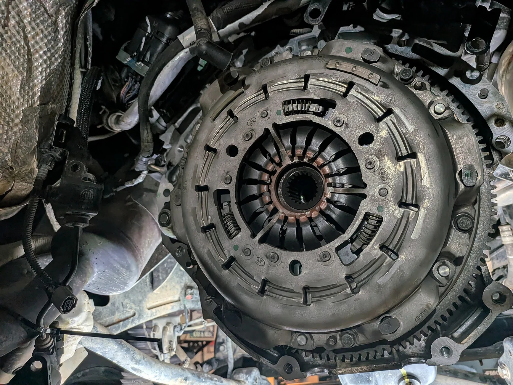

If anyone has been following my intermittent posts on the clutch issues with our 2022 heres the latest update. Got back from a weekend trip to Drumond island, about half way though the trip started having the same stuck shifter issues we had in Moab. Made it home and bled the clutch again, ended up dropping the trans for the third time. So the timeline goes as follows, Replaced stock clutch at 9k miles with centerforce kit, in fall 2022, went to EJS in 24 with 23k miles on the unit, had issues with not wanting to come out of gear, hard engagement. Contacted centerforce and decided to pull the trans and use their "updated" throwout bearing, basically a ford style bearing. Seemed to work ok until this latest trip. Jeeps now currently at 48k miles, when I removed the trans for inspection because theres no inspection covers.... I found the boot on the throwout bearing wadded up, and the pressure plate full of mud. Fairly confident that one could clean the clutch and use it, but if I have the trans out I'm not putting that clutch back in. ACT is in now, with the factory slave cylinder, and linkage. Also there are some new inspection/clean out holes for future use. Fingers crossed we get more than 20k out of the ACT. Centerforce kit will be listed in the for sale section once I get pictures up. Clutch engagement on the ACT is more like the JK, once its broke in we will see how the modulation feels compared to the centerforce.

The ACT combo is about 4lbs lighter if anyone is wondering. Also the packaging and fit and finish is far superior to the center force.

After running both now, I can say I had no issues with the pedal feel of the CF with both their external slave cylinder and the internal slave cylinder they just dont hold up to mild wheeling. At least not for me. The ACT so far I have 80 miles on it breaking it in, the feel is definitely a bit heavier, and there is a definite over center feel when you cycle the clutch pedal. Release is consistent and smooth, the only weak point I see so far is the plastic throw-out bearing still, which is what went on the first CF setup. The cable shifted trans is total trash imho enough so that if I had to do it over Id go auto, the only nice part of the stick is it adds an element of driver skill for me on the trails, that helps keep me entertained on the mediocre Midwest trails I have readily available.
