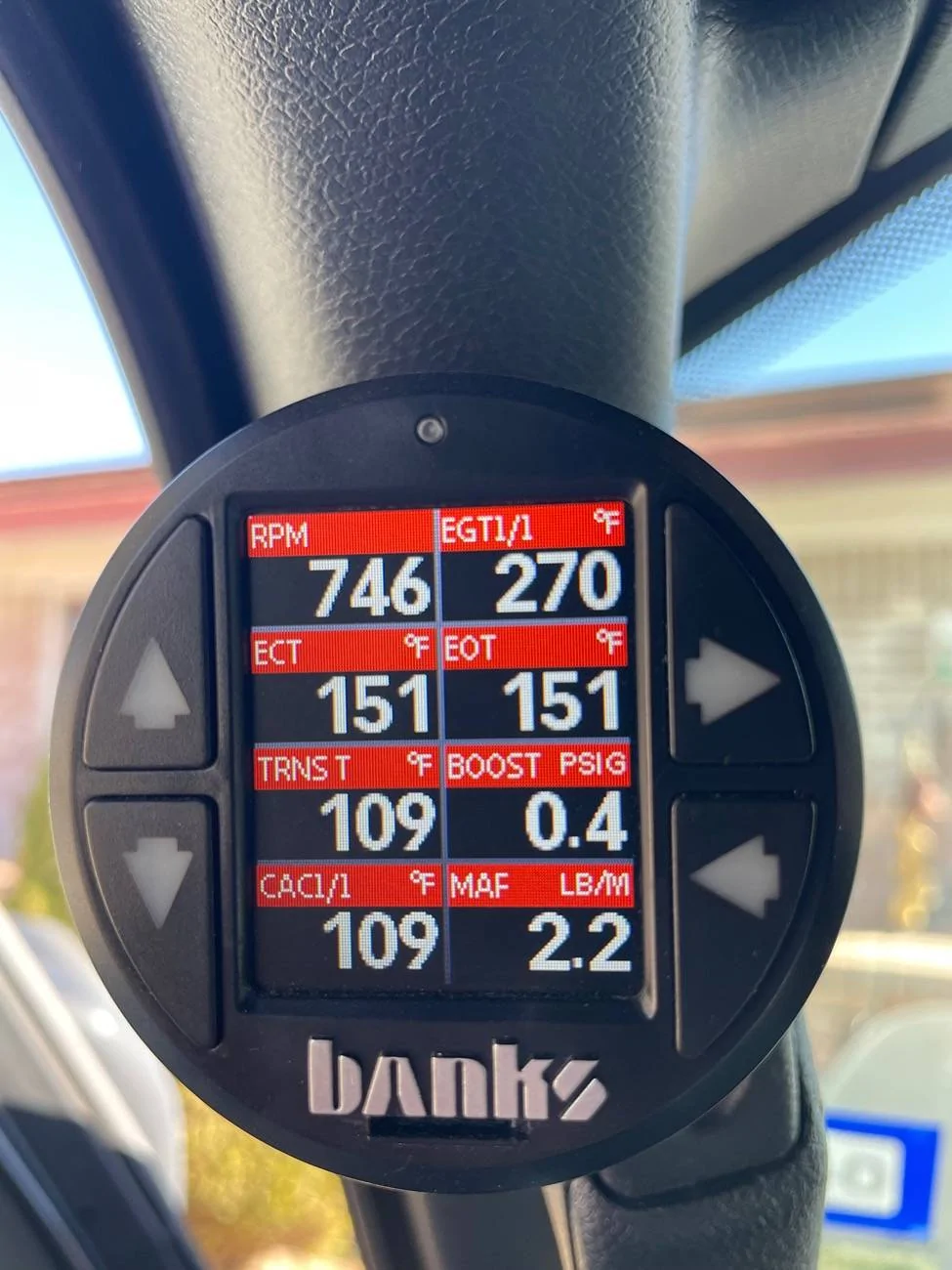

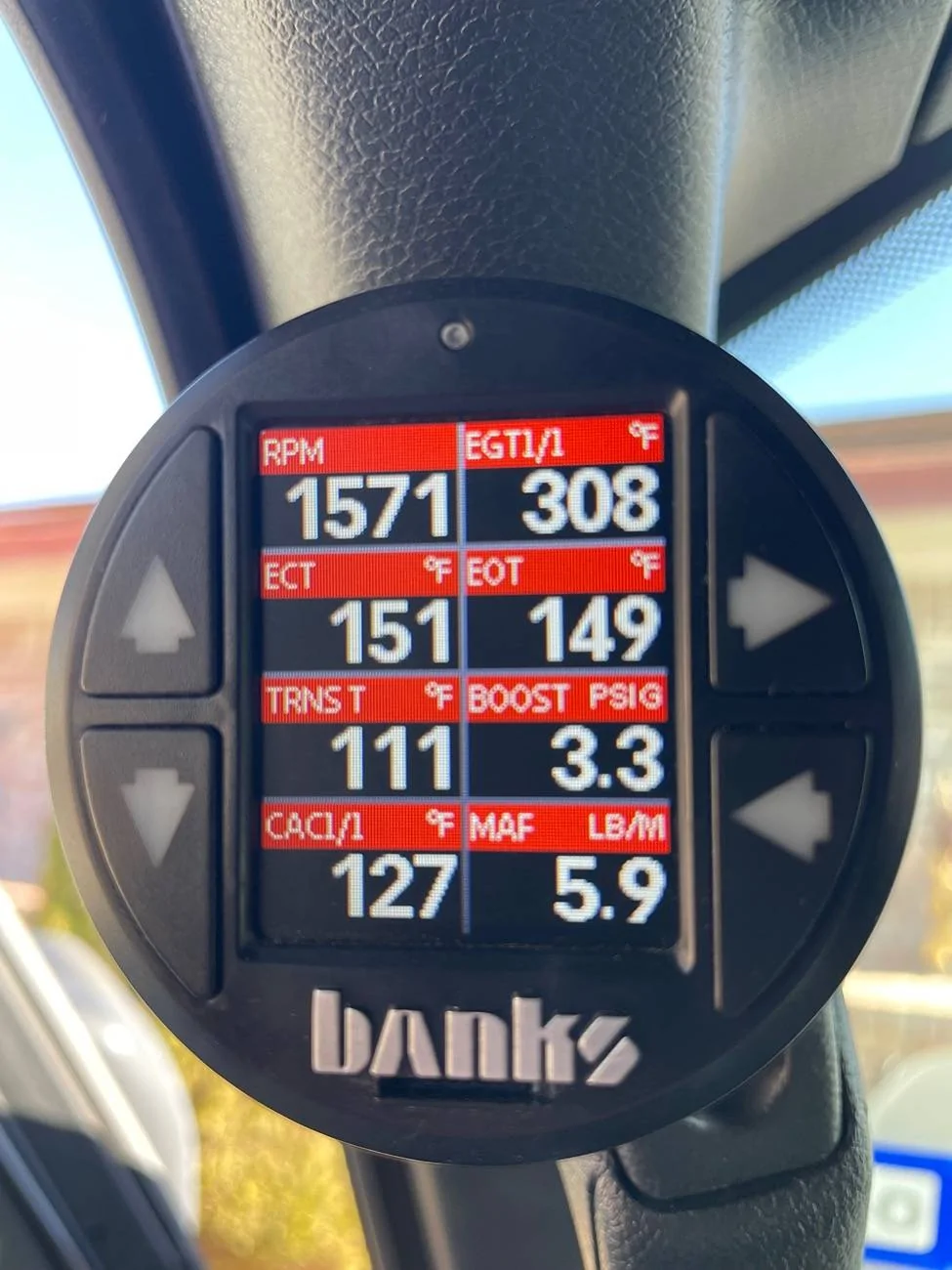

According to my iDash at 740 rpm it is 2.2 LB/M and at 1600 rpm it is 5.9 LB/M, idk how to change it to g/s 🤷‍♂️.

2.2 lb/min = 16.6 g/s
5.9 lb/min = 44.6 g/s
Your g/s readings are fairly close to mine given our rpm differences. I'm not convinced yet I have an MAF issue. Appreciate you playing along :)
