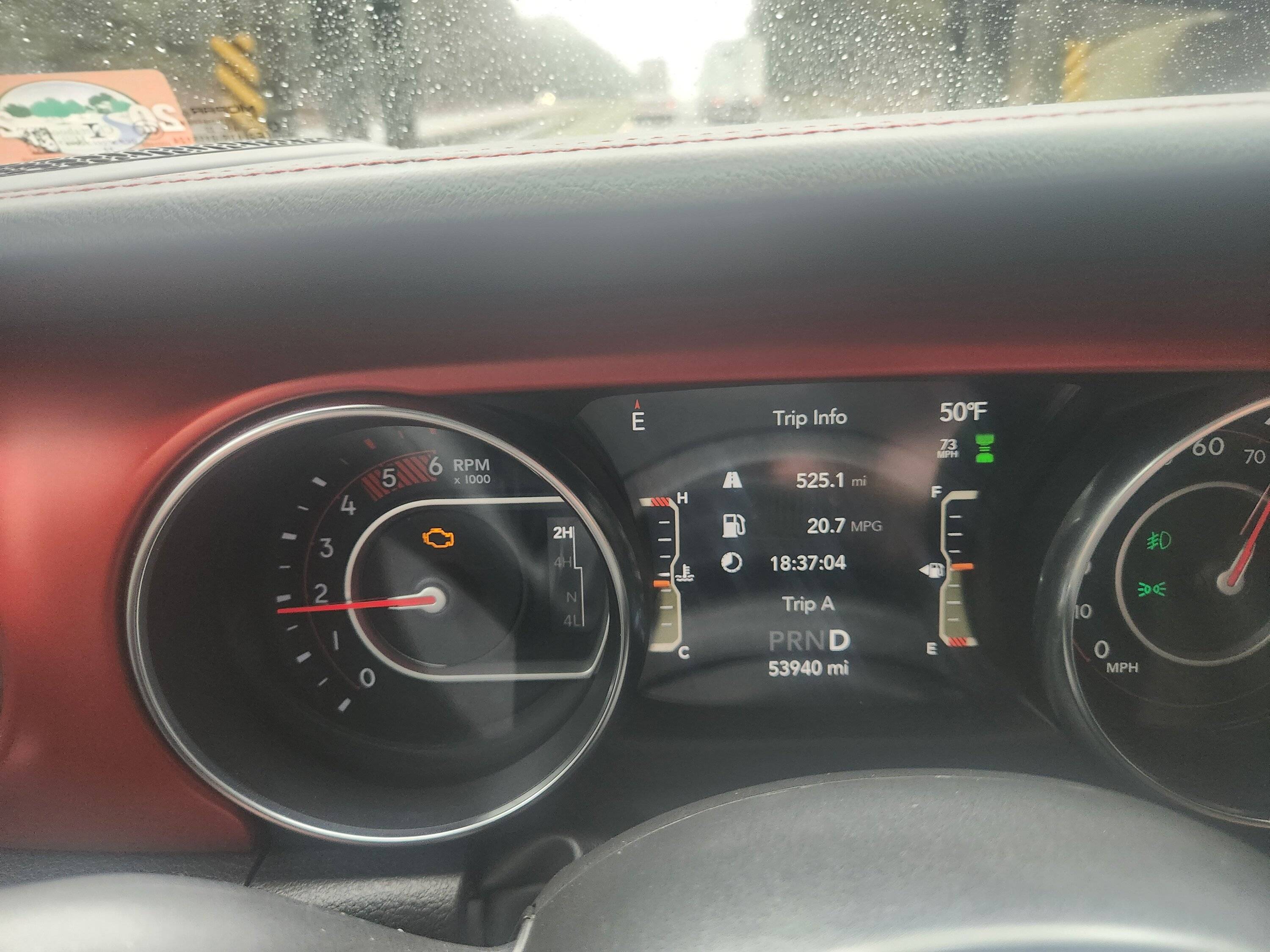

Several months ago I posted about my repeated problems with P026D on my Eco. The problem continues to this day despite 2 ECM replacements, a fuel pump replacement, several sensors being replaced, fuel flow at the injectors being tested (the code is for over fueling at the injectors), the body controller being updated, and the power distribution module (fuse box) being replaced. This all started around 50,000 miles and it now is at 60,000 miles. It has been to three dealerships, the first two were worthless, the third one I believe is trying hard to figure it out and they have not charged me a dime for all of this work that's been done. The first two dealerships claimed my problems were not under warranty.
It had been tripping around twenty miles after a reset but when I got it back a few weeks ago (after the majority of the work I listed was done) it made it to 520 miles, then 270 miles, then 20 miles, then 1200 miles. Now it's back to tripping every 18-22 miles.
I love the truck but I'm at my wits end. I'd jokingly say I'm going to put black tape over the light but when the light is on the remote start won't work.
Does anyone know of a place that could install a custom program on my ECM that would eliminate this problem? I know there were a few places capable before all of the emission delete crackdowns started but I am not familiar with any currently. Google comes up with a few suggestions but nothing I'm seeing as a custom program to solve nuisance codes.
P.S. the vehicle does not qualify for the Lemon Law in Georgia for several reasons.

It's finally fixed! Someone who knew how to properly diagnose the problem found erratic pressures at two injectors while driving. They swapped the injectors and the light has not returned.
