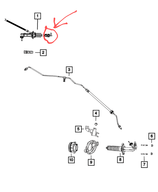

At least for yours, it’s gotta be the clip that goes onto the pedal off the master cylinder shaft. Sounds dumb, but use a zip tie, or tape, something. Maybe some foam with tape around it and hold that clip still. And see if the noise is gone. When I found one literally just hanging off before it came in, clutch was working by the lucky chance that the master cylinder shaft just ran into the pedal arm, wasent clip in at all, I knew these weren’t perfect back in 2018, I know they’ve changed since, and changed drastically in 2022s.
Pretty confident I'm following you but you are talking about making sure this piece is fully attached to the pedal using a zip tie or something to remove any play in the clip?
Yes that’s the clip
