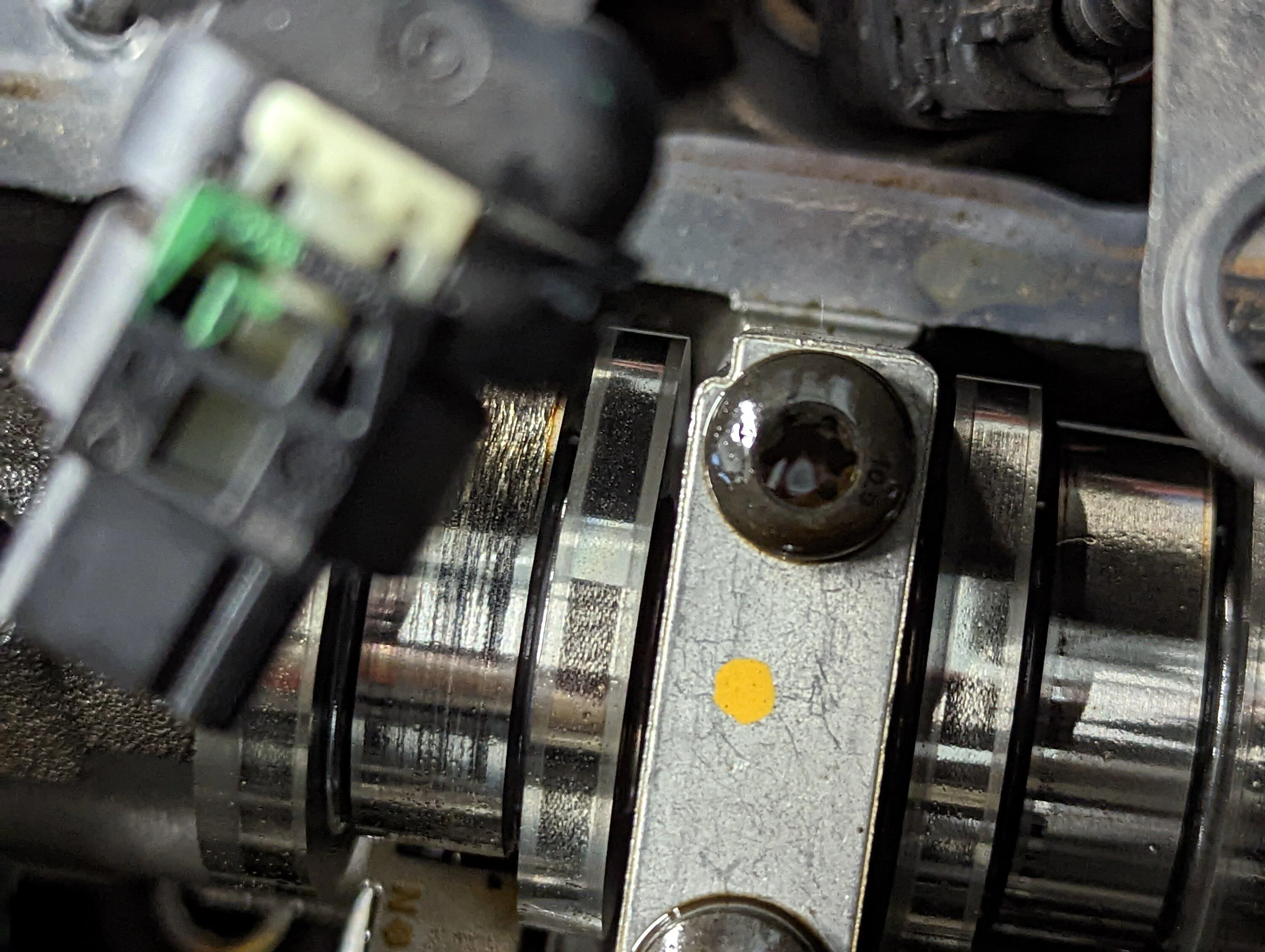

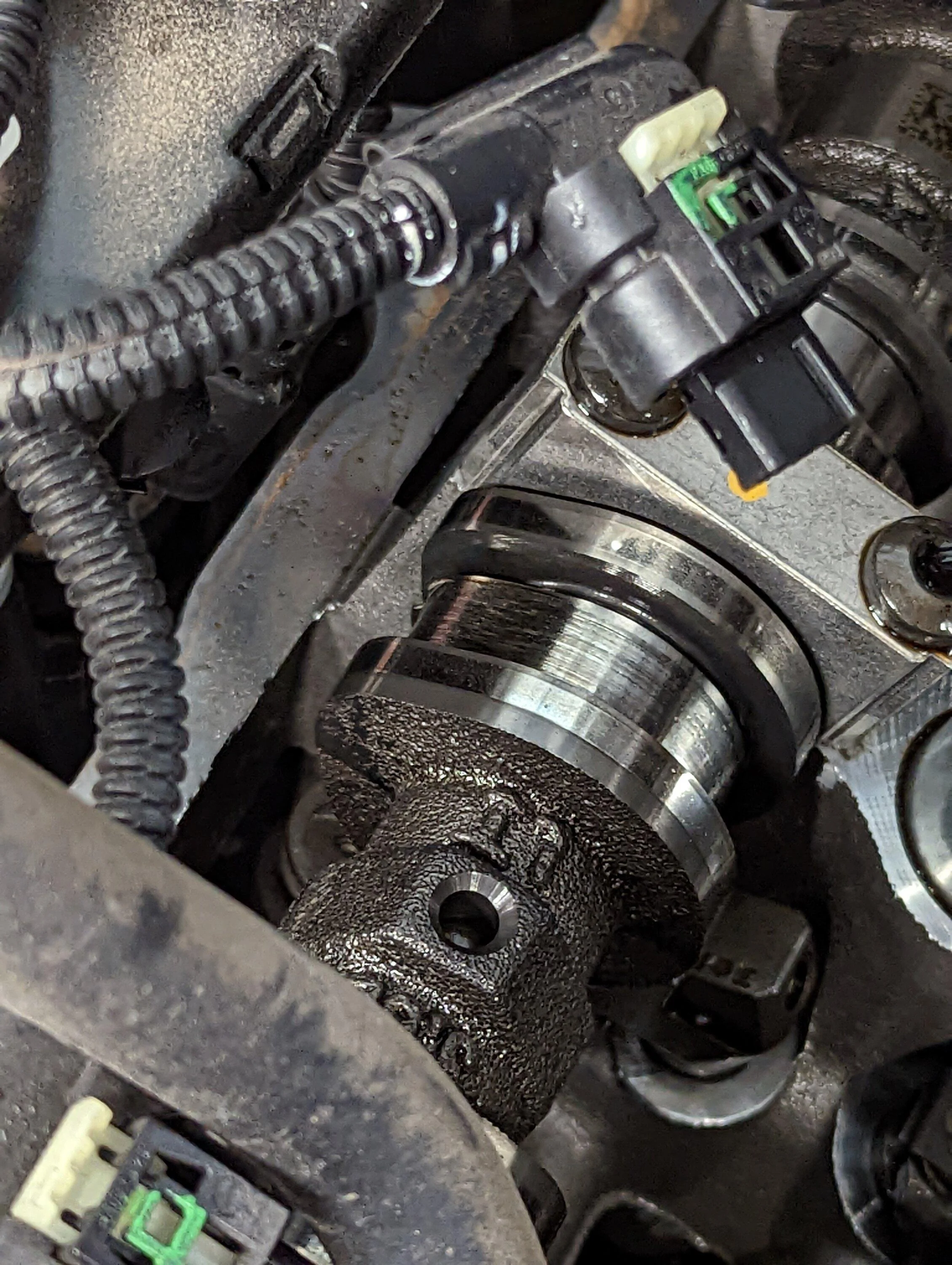

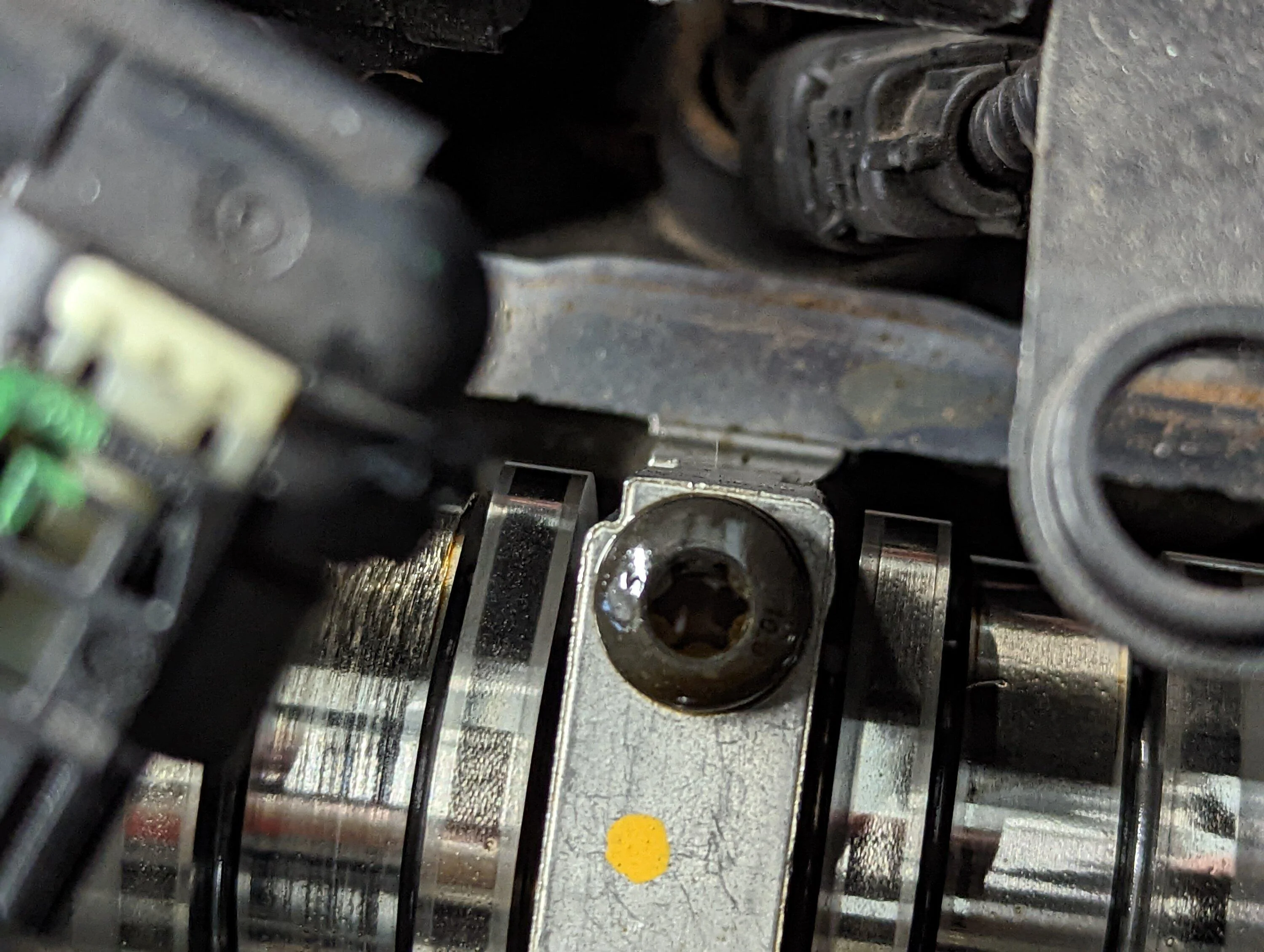

Update on my chatter noise. I had camshaft high lift lobe/follower wear. Both intake camshafts and all followers were replaced. I pick up my Jeep next Monday.
The noise I had was very similar to a few posted on this thread, so I think this may be the issue.

It was definitely the issue. High lift lobe on one follower was worn. Camshaft was still installed so I couldn't see the follower wear, but I'm sure it also has wear on the coating. Mechanic said he has seen many Pentastar Upgrade engines with this issue.
