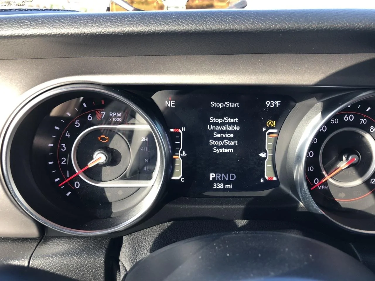

Okay got it home after 2 exhaust lifters were replaced on cylinder 2, but within 75 miles the check engine light is on again, flashing first with accompanied with start stop message saying it needs serviced. Also there is a misfire for sure still happening.
back to the dealership for round 2, now with 300 miles on the odometer.
