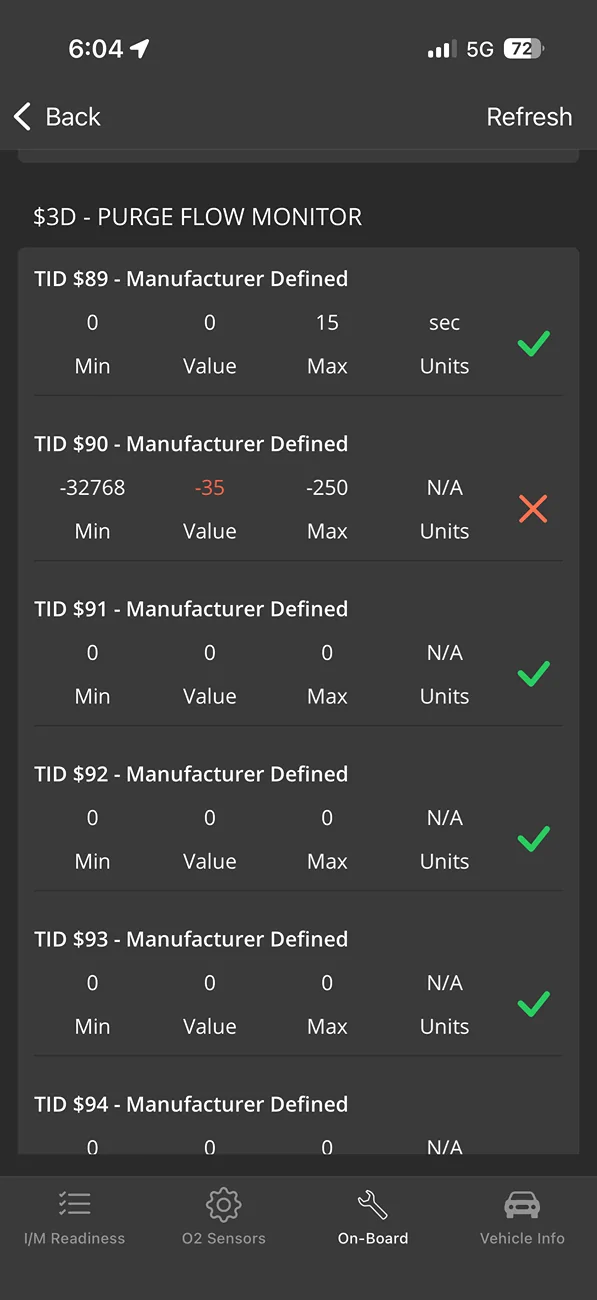

So I've seen a bit of information about this.
Of course a couple of months after my basic warranty is done my CEL comes on after a trip of "check fuel cap" warnings.
Of course I've checked the fuel caps, I even replaced the fuel cap now.
"oh you should get the OEM one", seems like a PITA to find ATM, I don't mind trying again, but I honestly don't think that's the problem.
My BlueDriver OBD adapter wouldn't pair with my phone anymore, I haven't needed it in so long I didn't know it stopped working.
Just got my OBDLink MX+, wanted to make sure that was actually the code it was throwing P0456.
I checked the purge valve located above the engine, which is really convenient.
One side had a little bit of of push to it I noticed.
This part seems like it'd be easy to replace, I don't see any obvious cracks in the hoses or plastic, but without a smoke test it would be hard to tell.
I tried to reset the codes incase my new cap and purge valve squeezing where enough, but they didn't seem to clear. It says permanent codes. Are those the type that you need to drive X amount of miles before they go away?
I really don't want a repair bill already for a 2022 vehicle, so any tips would be appreciated.
TIA.

You can't clear the permanent code. It will pass a self test and clear on it's own. You can only clear a pending or active code. Clearing an active code should extinguish the check engine light. If you don't see a check engine light but you still see a pending code, keep troubleshooting.

That negative value looks like the purge valve sensor is dead. One’s in the mail.

An update, the "Genuine Mopar" purge valve from Amazon (was same price as rock auto and free shipping... I know, I know... The original has a horse and says continental, the "genuine" has a =V= symbol) did seem to make the active and pending codes clearable.
CEL gone.
There's still permanent codes and the "check gas cap" warnings keep coming up.
I have a long drive into the office tomorrow.
Fingers crossed that clears it all out.
At least I can remote start in the morning. phwew.
Just got done clearing the ice off, need to cover it with tarp or something next time, the bed rack with softopper underneath is no fun, plus the windshield sprayers were painfully iced over.

It was the purge valve that let me clear the CEL. The check fuel cap light is still on and the permanent codes are still on. I don’t know how long it can take to clear.
