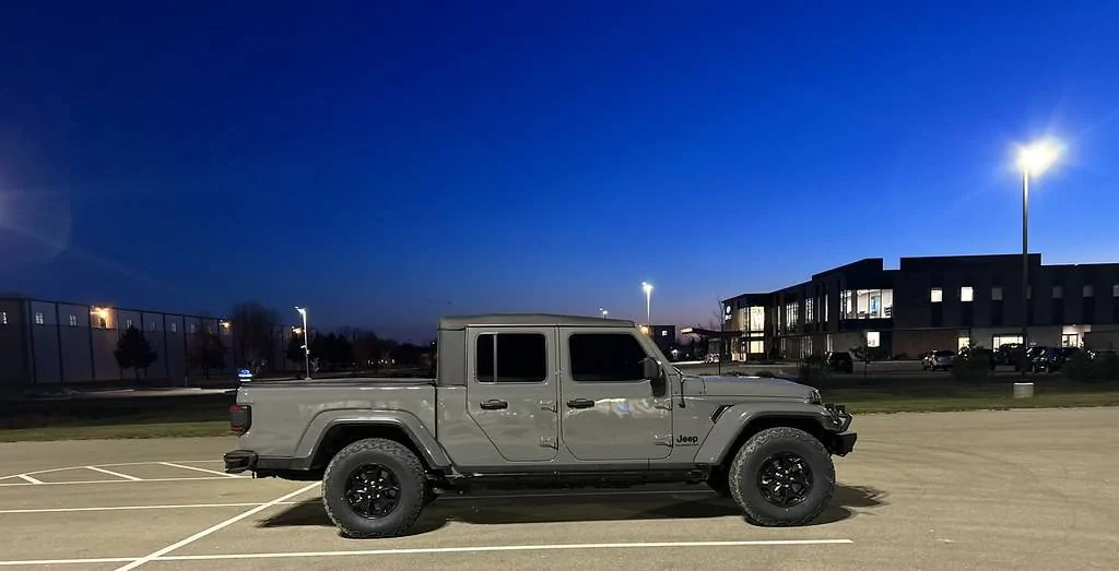

And here's the truck just because I like looking at it:
