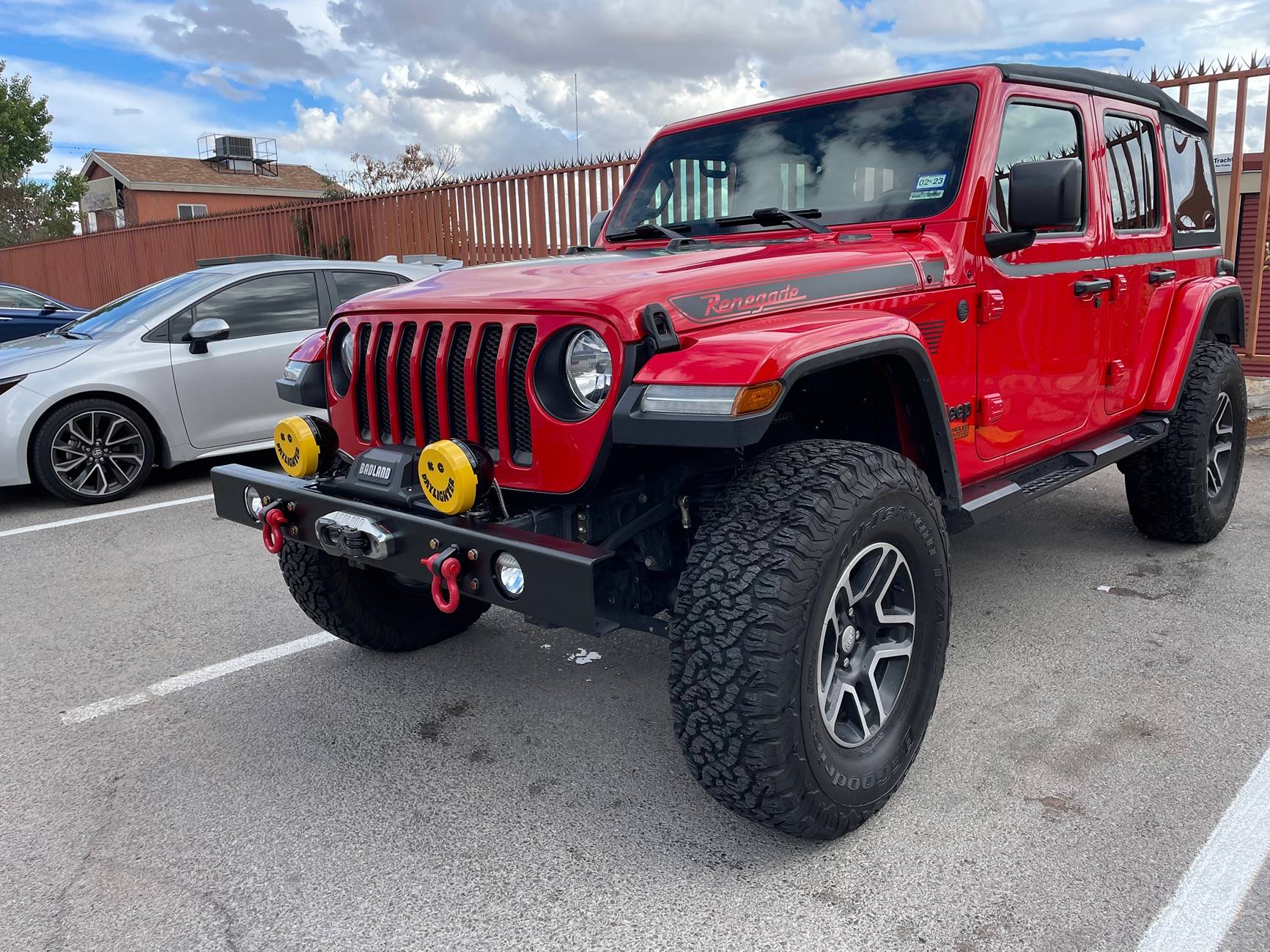

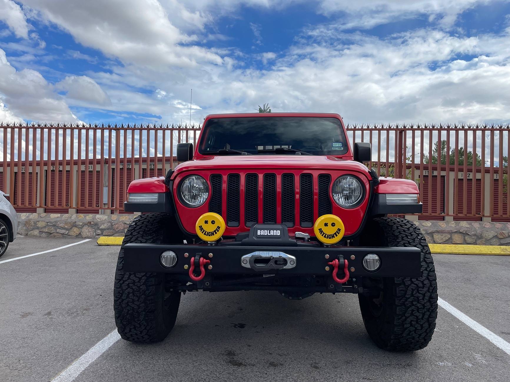

I made the bumpers, both front and rear, out of a piece of 6x6 1/4 wall square tube. Split it down the middle and drilled/cut holes for mounting bolts and fog lights. Welded in the d ring mounts.
If I did it again I would probably use 3/16 wall as it is heavy.
