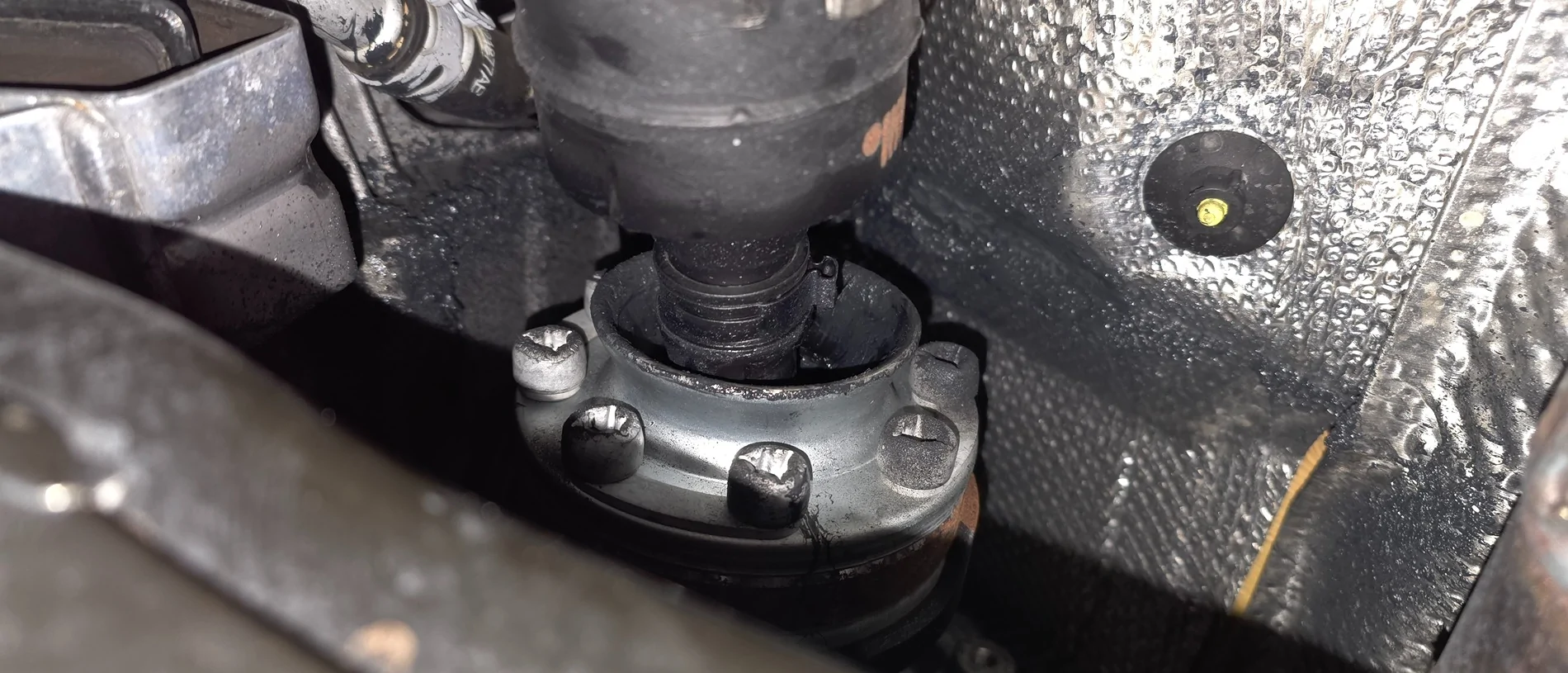

So, after about 7,000 miles (mostly on road) it happened…torn boot on front driveshaft. Clayton, what drive shaft do you recommend?

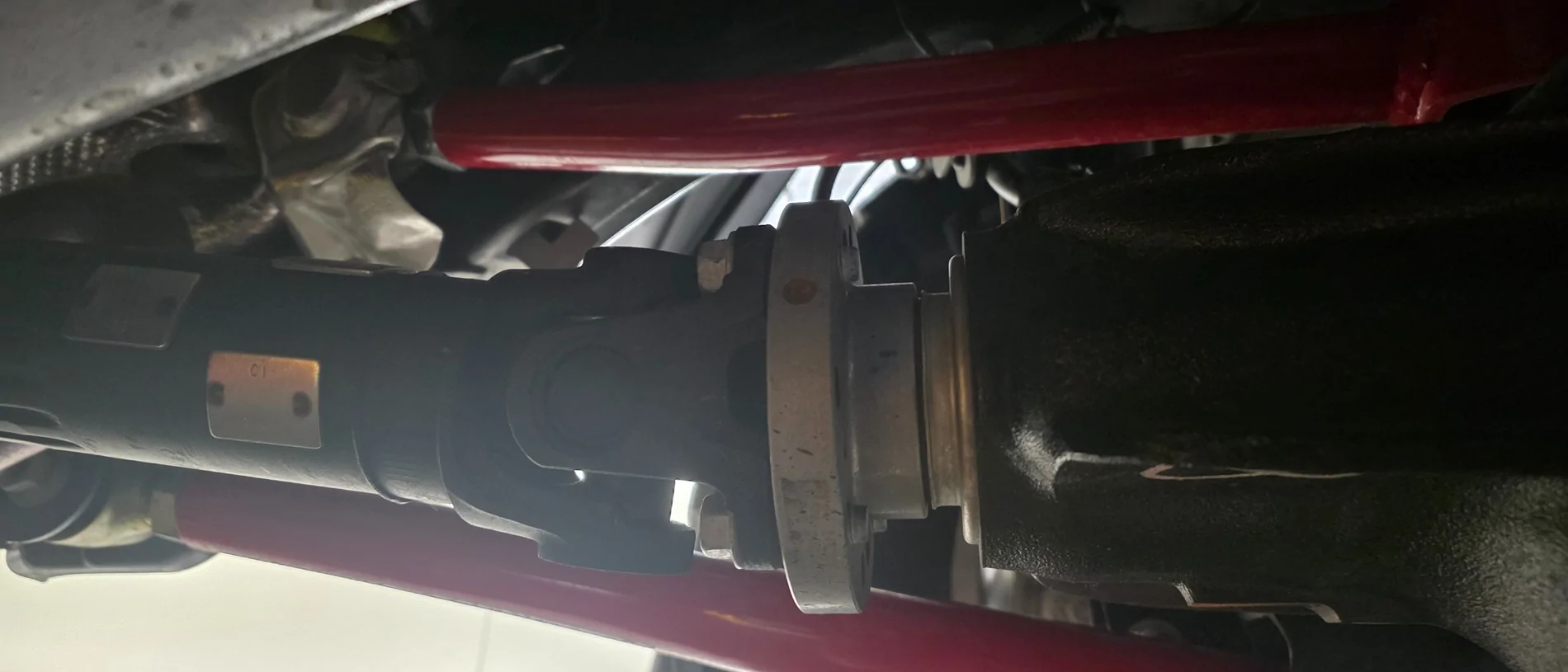

After reading your post, I went out and crawled under my Jeep. I've had a 3.5" lift on for 12k miles. I'm not really sure what I'm looking at. The end of the driveshaft that goes into the front differential doesn't have a boot. It's just a u-joint that looks fine. The end that goes into the transfer case looks a little greasy. Is that the end that has the boot? Does the grease around that area mean my boot is torn too?
That’s what mine looked like, if you look more closely, I’ll bet your boot is torn.
