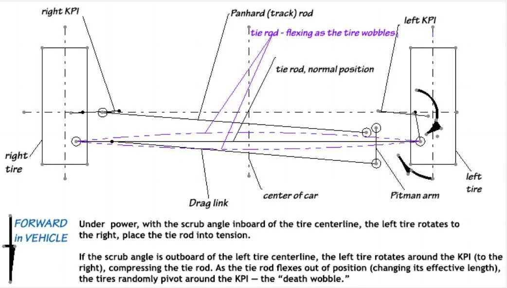

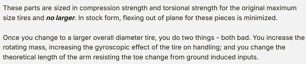

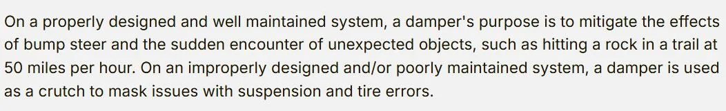

Whaddya think - road force balancing for the larger tires?
Feels right to me......
Really depends... I think just a tech that understands and takes the time to do it right. MT's may not road-force at all, and I don't think anyone will attempt anything over 35 on a road-force.
