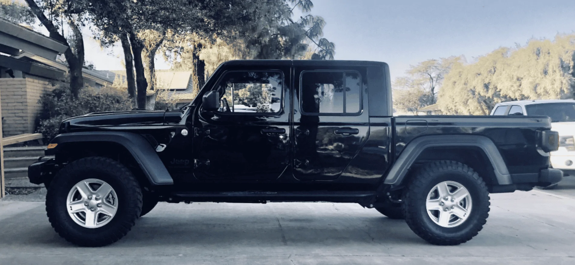

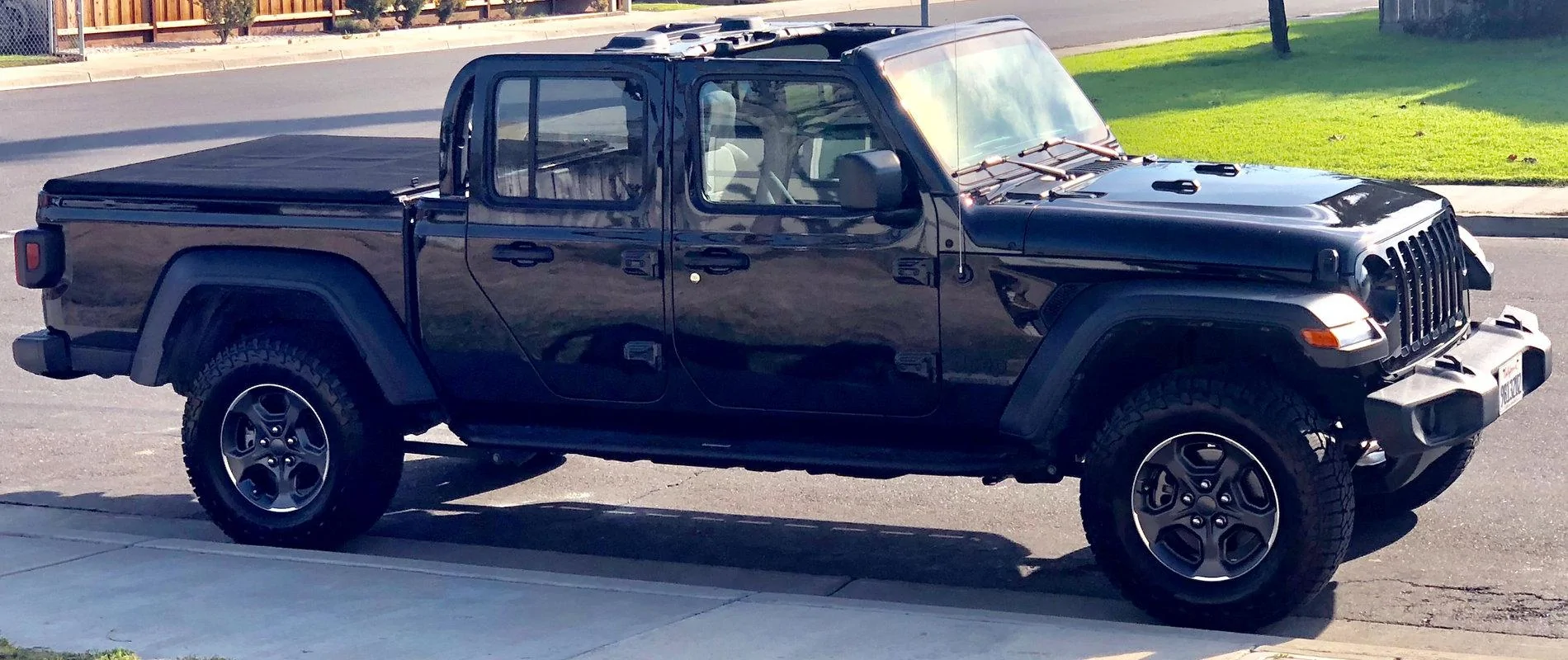

Sport S Max Tow with 2” leveling - 35” MTs on stock sport wheels and 33” ATs on Black rubicon wheels
