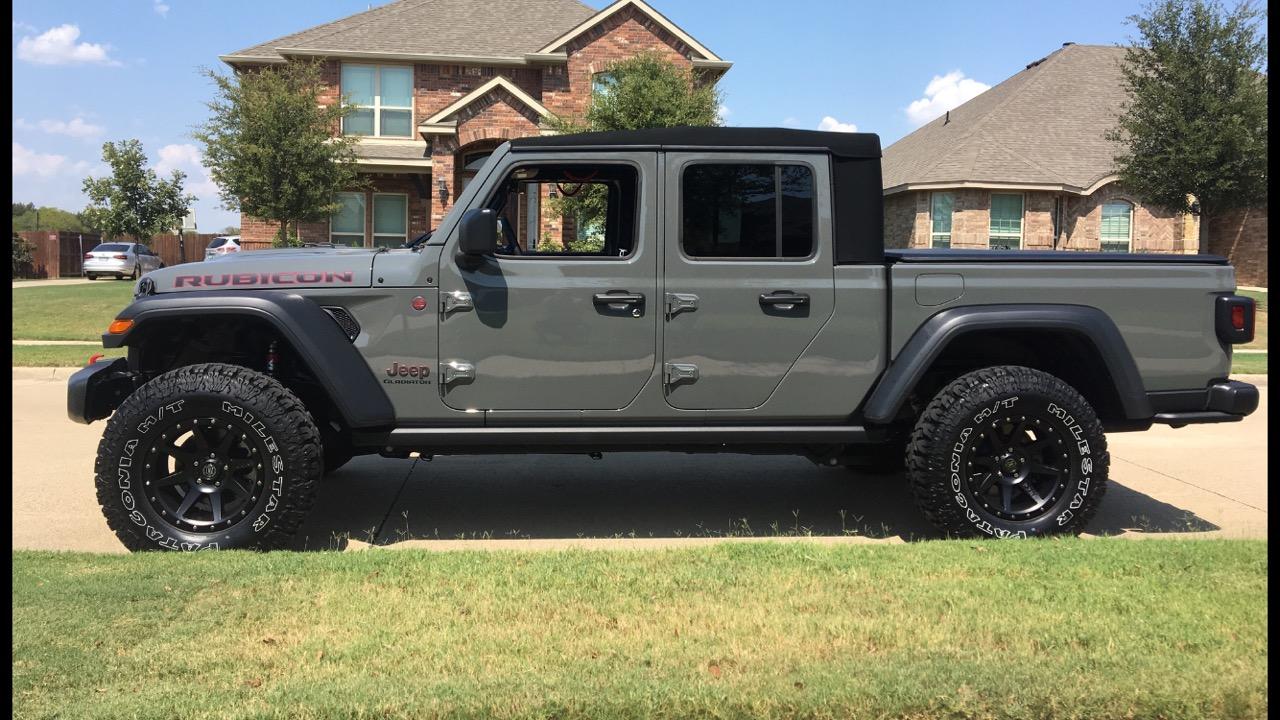

I installed the Daystar spacer on the front this weekend. I think it looks awesome! Ride is the same as factory.
Only thing I notice is I'm pulling slightly to the right now. Need to adjust something maybe? Steering wheel is perfectly straight.
Realize this is an old post, but was interested in knowing if you solved the issue.
Just out of curiousity, did you tighten everything in the air, or on the ground? As the fittings should only be a little more than hand tight until lowered and load is placed to set suspension. The other issue could be the front axle being off center now (to the driver side) as the stock track bar is not adjustable and therefore the more the raise is there the more offset it will become. You might also notice a slight bow in the driver side spring (outward) that is a tell tale of this scenario.
