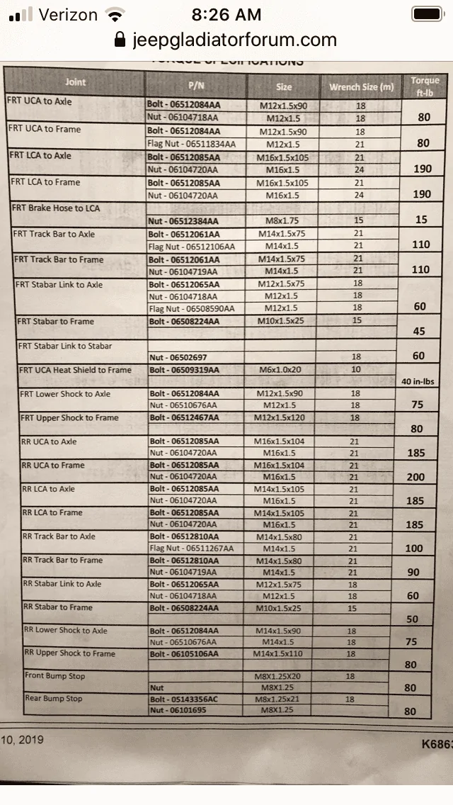

Just install the Daystar leveling kit 2" and I wondered where can I find the torque specs for all the nuts and bolts
Be aware that the split metal sleeves in the Daystar sway bar links may not withstand proper torque. Solid metal sleeves are available from Lowe’s for $2.50 each.
Jeep Gladiator Daystar leveling kit 47AA74D4-F7F1-404A-B568-A8732EDDC108

Thank you so much
