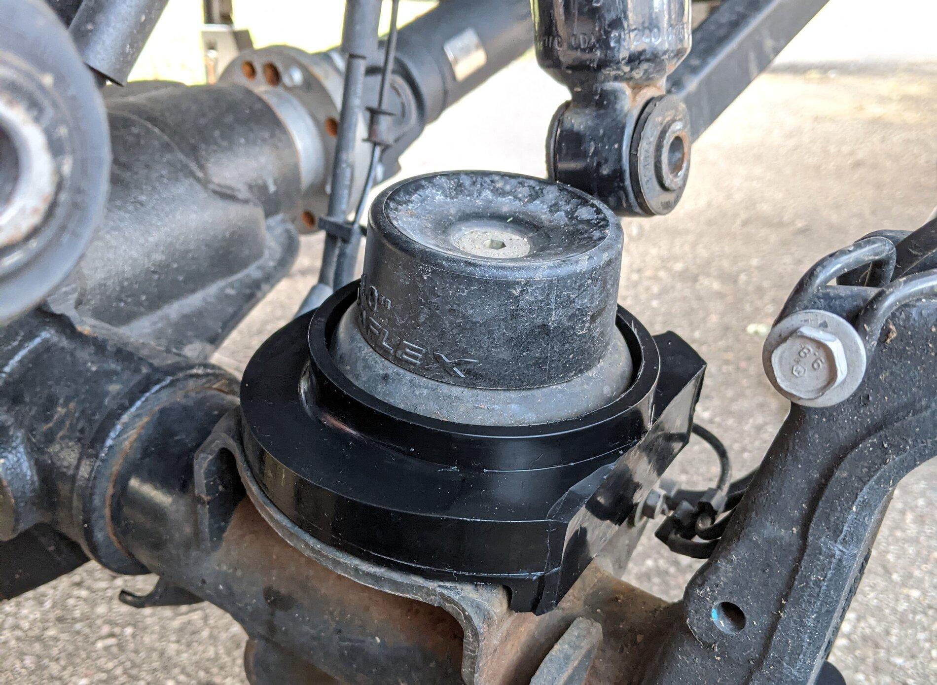

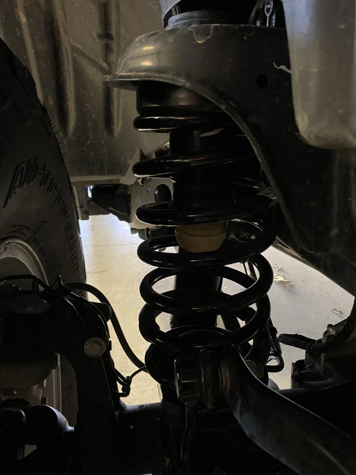

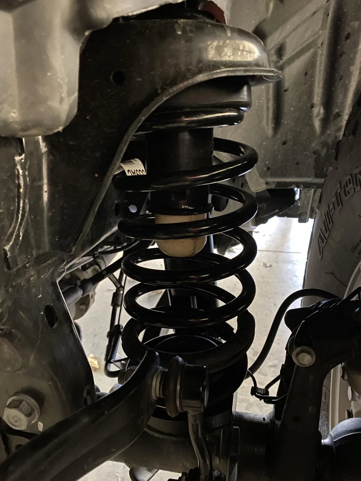

Just an update for everyone following. I put on my factory wheels and tires for the winter, and used it as an opportunity to install the Daystar bow correction kit, and it seems to have eliminated 80-90% of the bowing. Feels good to have figured it out. Added some pictures as well
Curious as to how this turned out for you? What captured my attention is in your 4th pic down from your original post, you don't have the factory isolater installed underneath the daystar spacer, but you may have just removed it all together? Which might give cause to your bowing spring. But hopefully the correction kit helped. 1.5" of extra spring compression with a spacer lift is about maxed out anyway. Just curious as to the end result.
The Daystar kit doesn't require you to use the factory isolators and it wouldn't be possible anyways because the Daystar spacers have tabs on the top of them to align into the factory holes. They replace the factory isolators.
The bow correction kit fixed the problem for me. The problem had to be in the factory bottom perch. The factory angle just didn't work with the spacer kit for some reason. It's definitely odd.
In the end, in wouldn't recommend the Daystar kit. The material they use for spacers is not strong enough and after just a couple of months of having them installed, they already showed signs of warping/bulging.

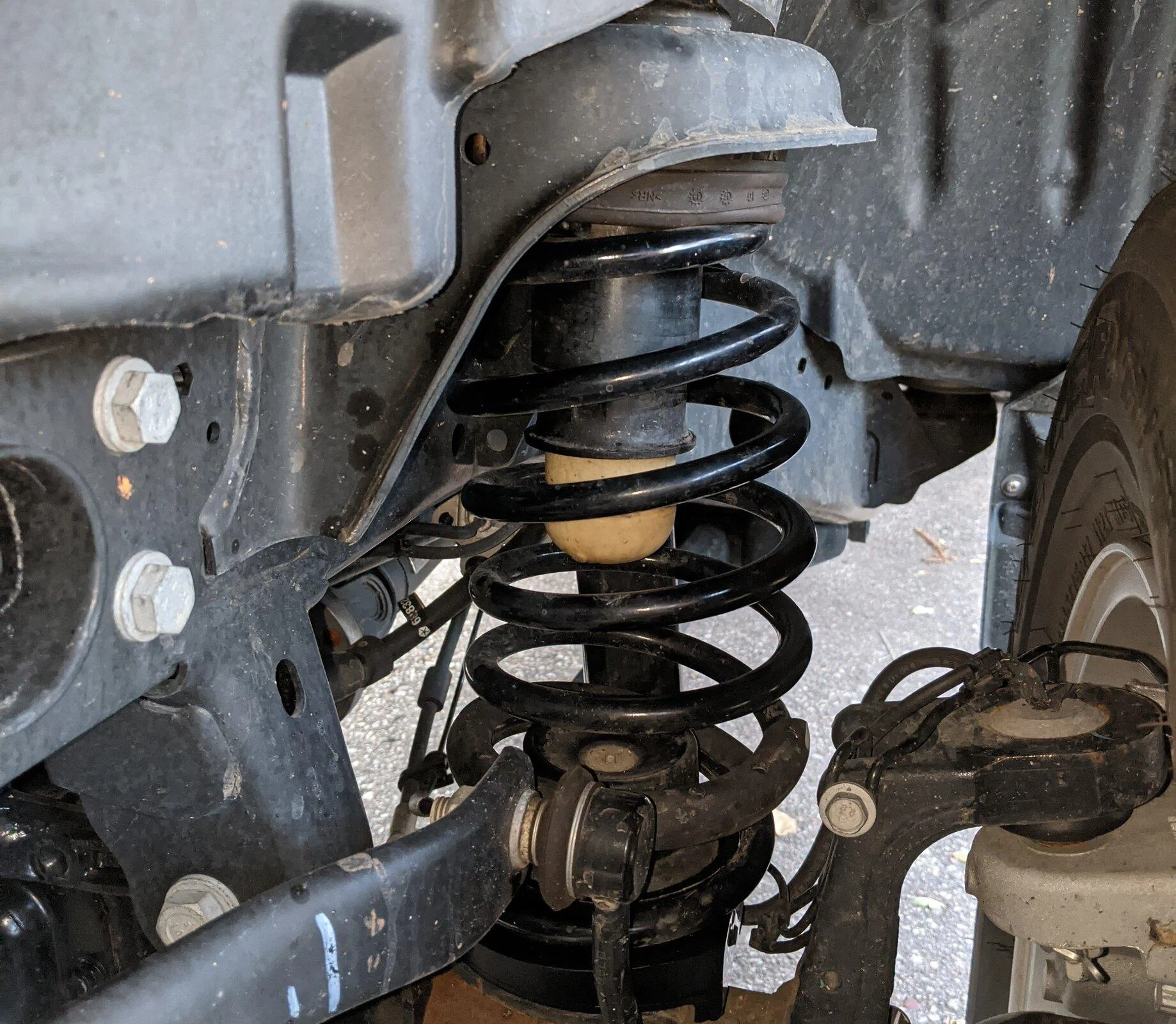

I just installed the 1.5 alloy (which is the same as the daystar) on top of some rubicon springs on my sport S. The truck sits good and level on both sides but just looked a little ago and my passenger side looks great. The driver side not as great.
I’m surprised more people don’t talk about this.
Now I’m wonder if I need to fix mine.
