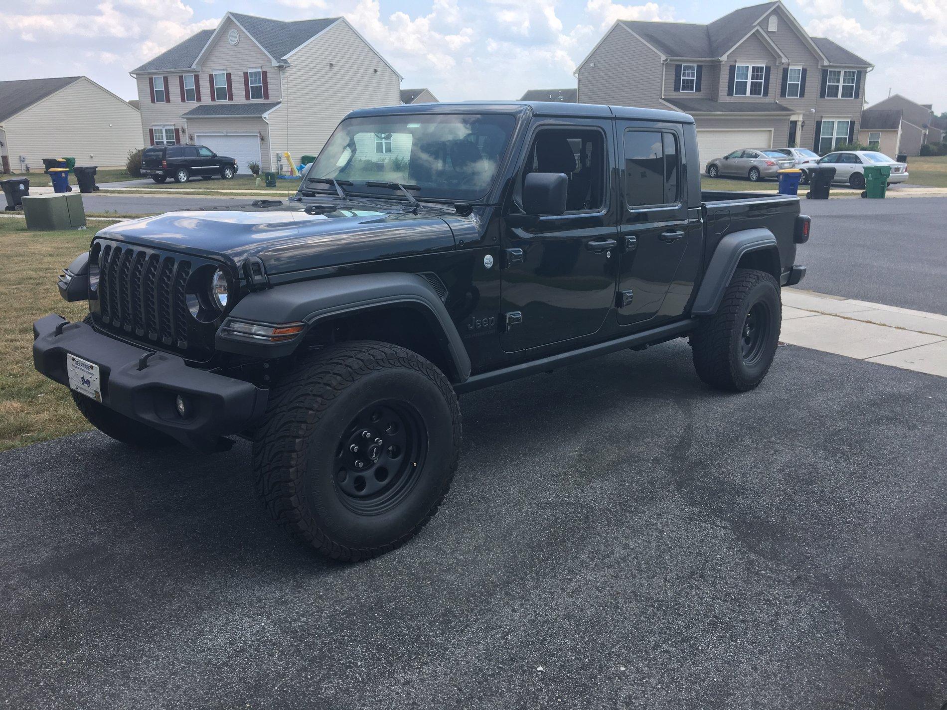

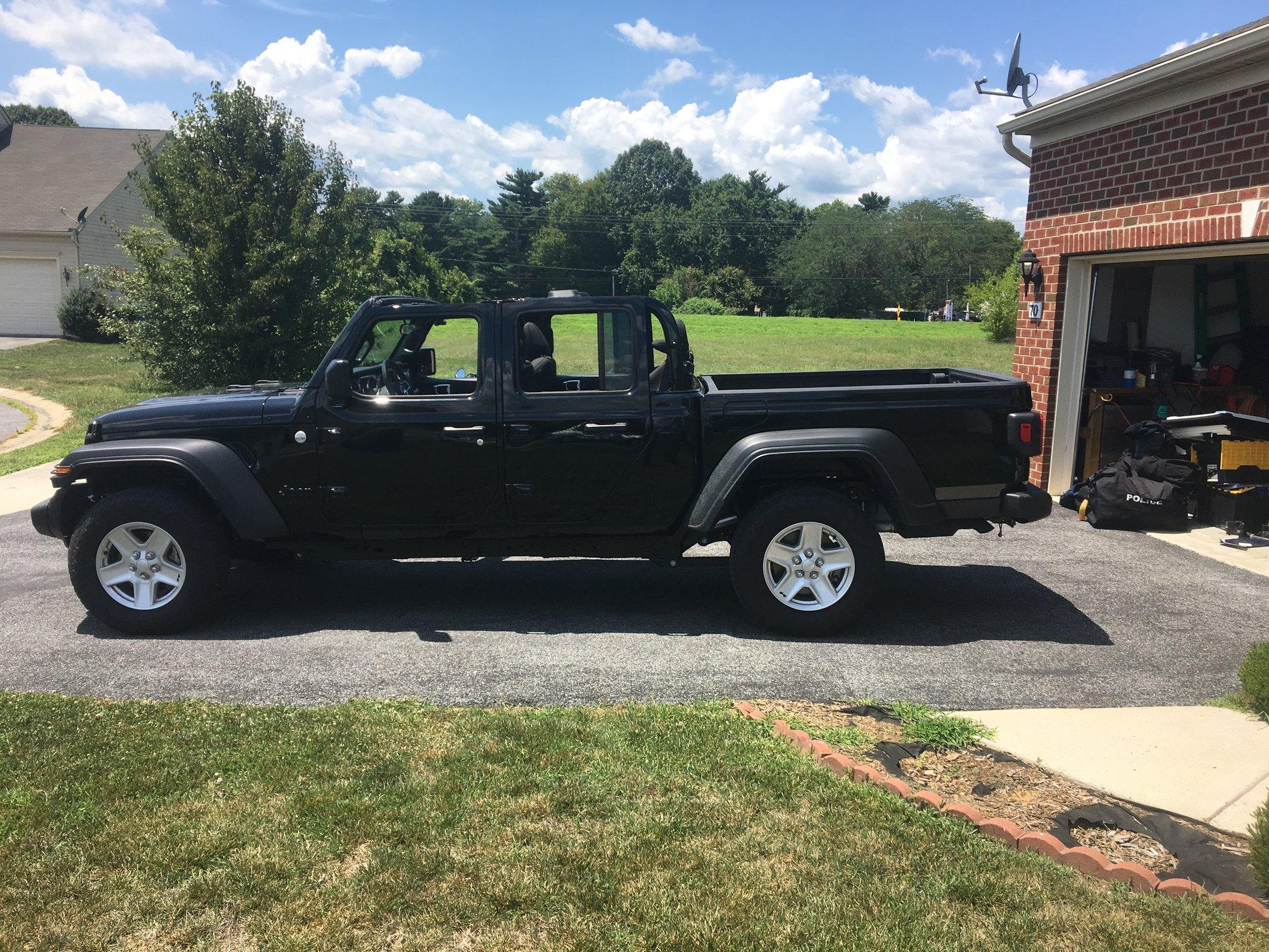

Here are my before and after pics.
I hope others folks have the same positive experience as I have.

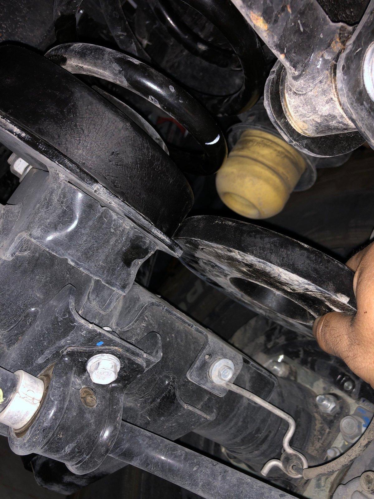

The original kit came with a .75" spacer for the rear. However, a few days ago Daystar sent a 1.5" spacer for the rear. The new spacer is installed and makes the Gladiator sit correctly. To me the .75" spacer in the rear wasn't enough.

The rear spacer is actually 1.5", measured to verify. (edited original post correcting the size)

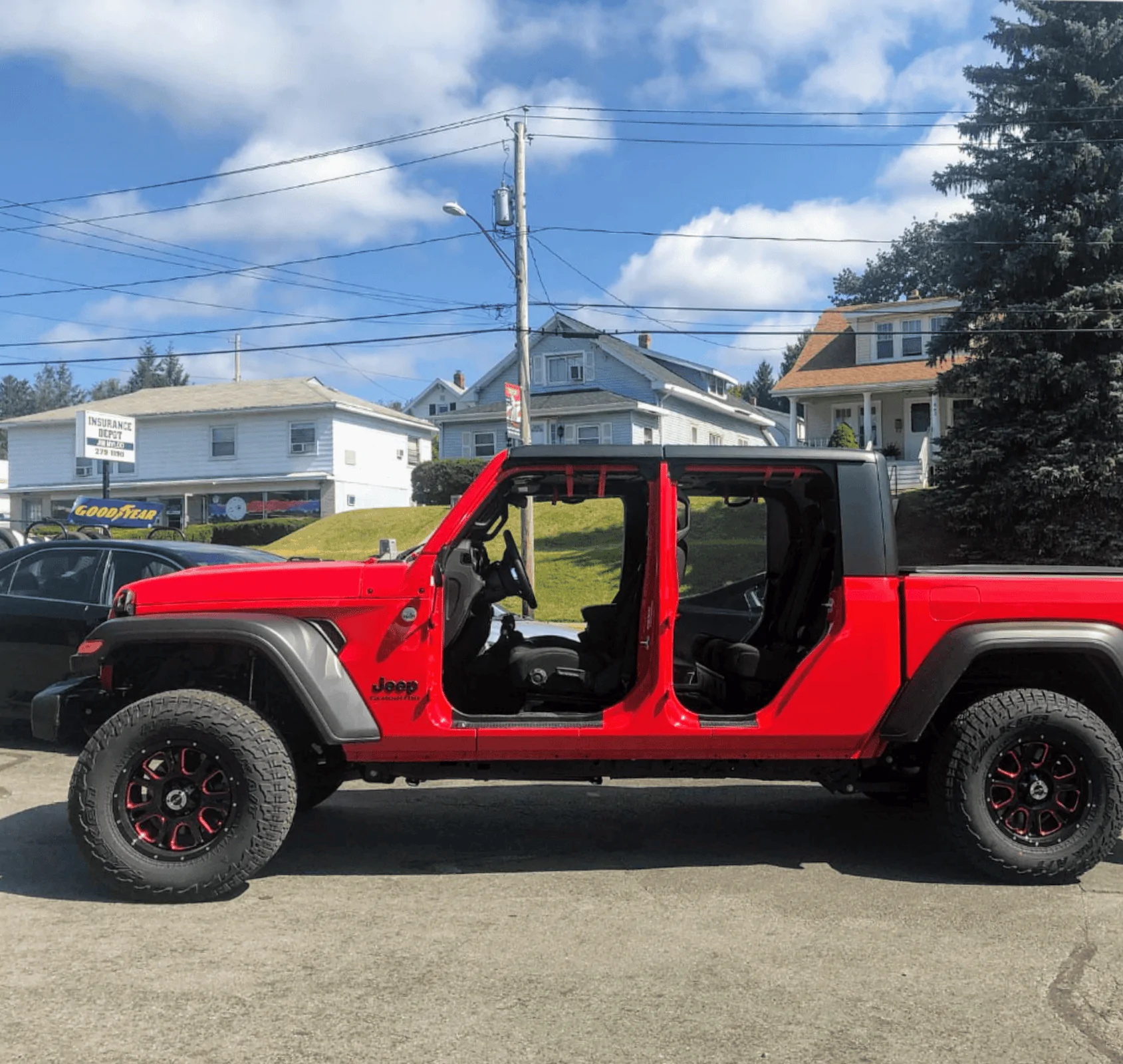

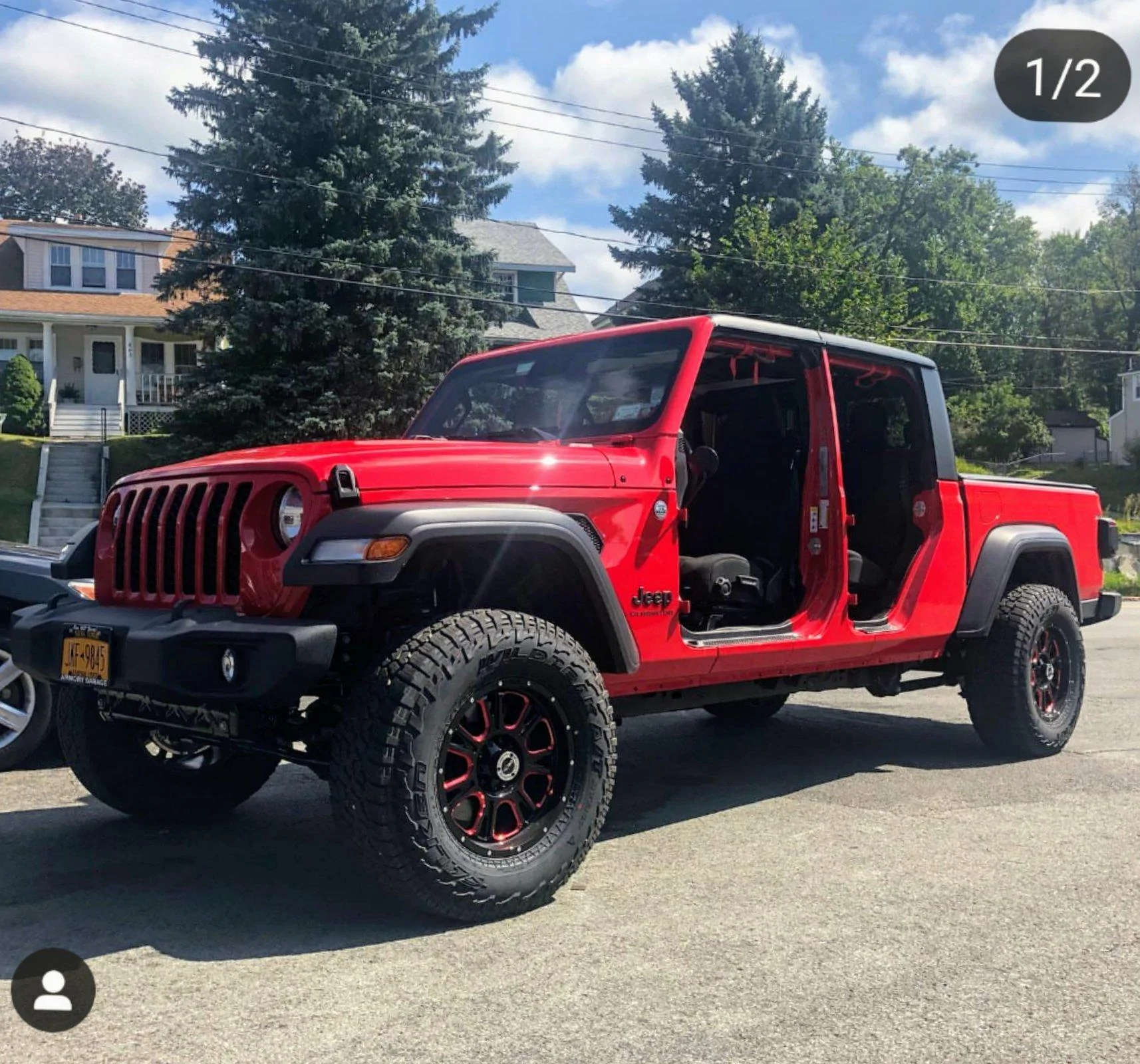

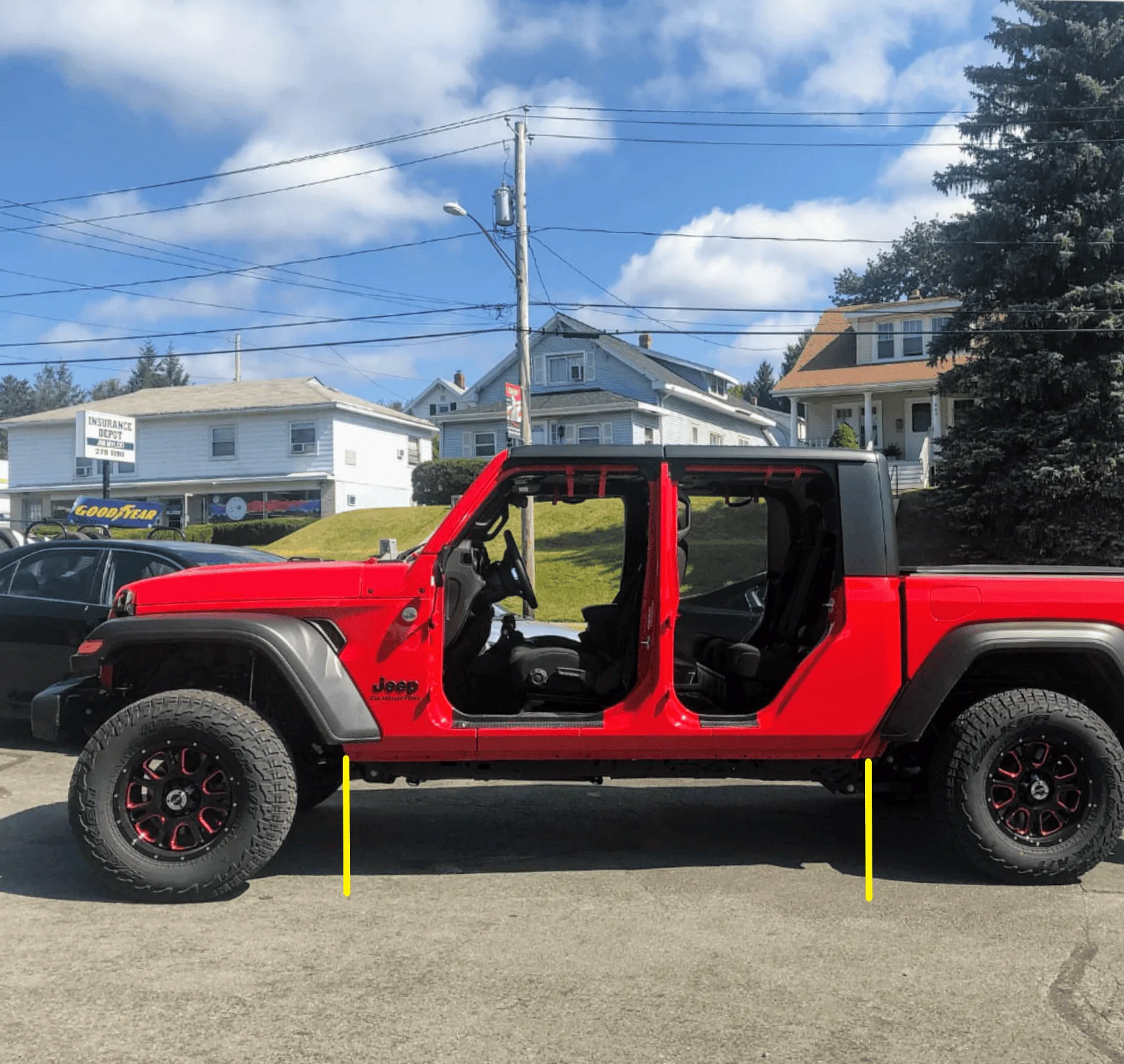

2.5" rough country level on 33s and 17" wheels. I never actually measured it, but it looks as if it has a bit of that Cali lean if I park on level surface, but I love that look. Might not actually be nose up though. The hood is just higher than the back, as are the fenders. Might all be an illusion. This is my daily driver so I wanted no part of going any bigger than 33s.

I think the only reliable place to measure is the bottom of the pinch seems. From the factory, the wheel arches are not the same height relative to the truck, so you can't measure from them. I've highlighted it in your picture.
