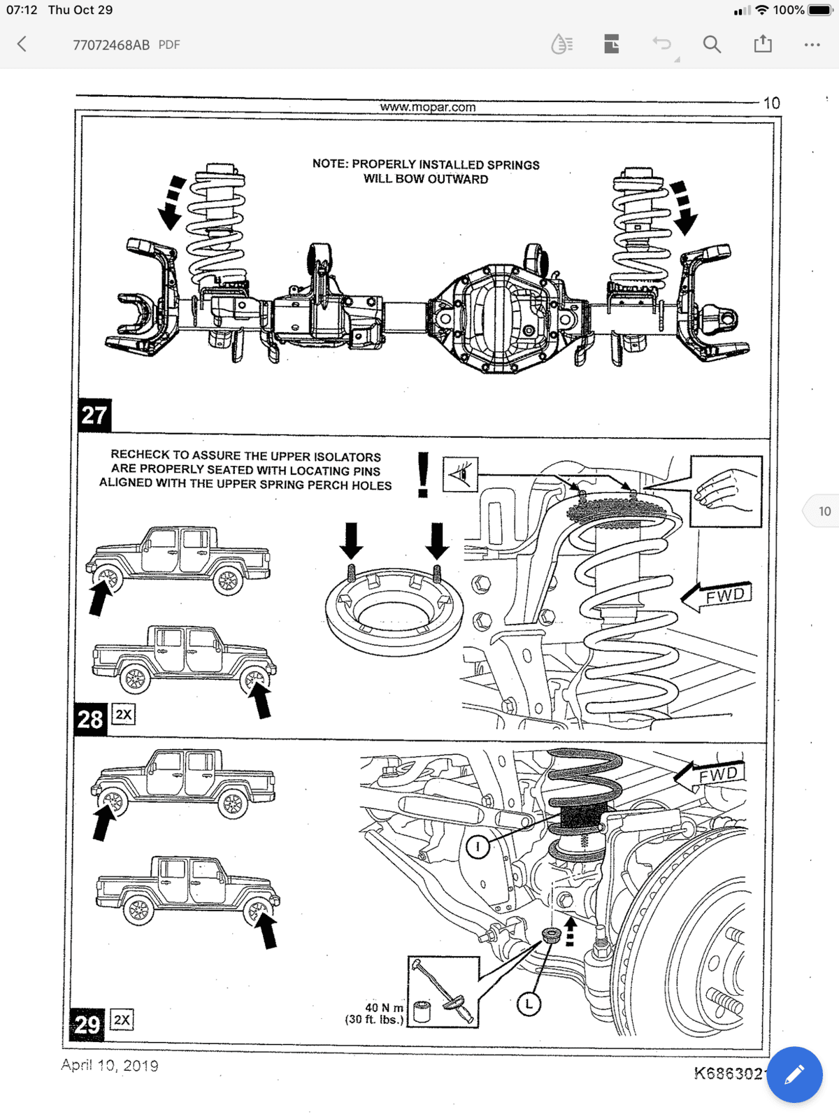

Here is the Mopar service manual for installing the 2“ lift.
Read the top note.

If you’re stacking the spacer on top of the factory isolator you are doing it wrong.
Hmm. Does that hold true to just the 3/4” Daystar leveling kit?
The instructions say to “add the spacer, noting the alignment of the factory spacer”.
There are no “Locating pins” on the new 3/4” spacer.
