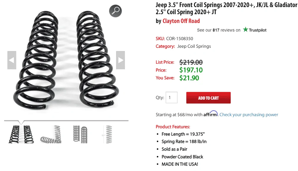

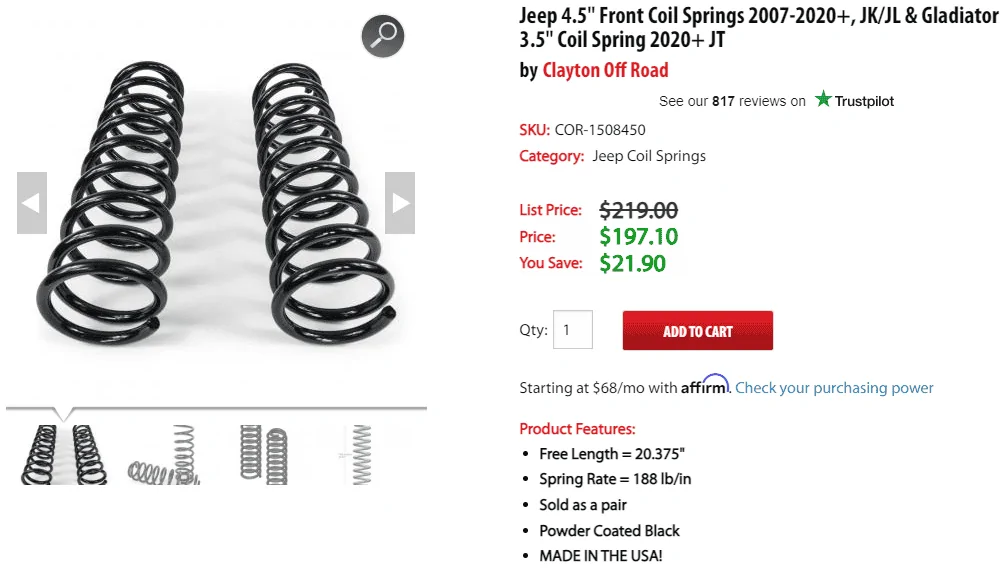

Ok, so the 1.5"/2.5" is the 1.5" JT front spring.
I don't think it's bad practice to use the same spring for different applications. OME has always done this and their springs have a pretty good reputation.
I'm seeing the 3.5" spring has a 1" longer free length than the 2.5" and they have the same 188 lbs/in rate.
Jeep Gladiator Clayton Springs On Bricks/Cobblestones Clayton JT 3.5 coil
Jeep Gladiator Clayton Springs On Bricks/Cobblestones Clayton JT 2.5 coil
