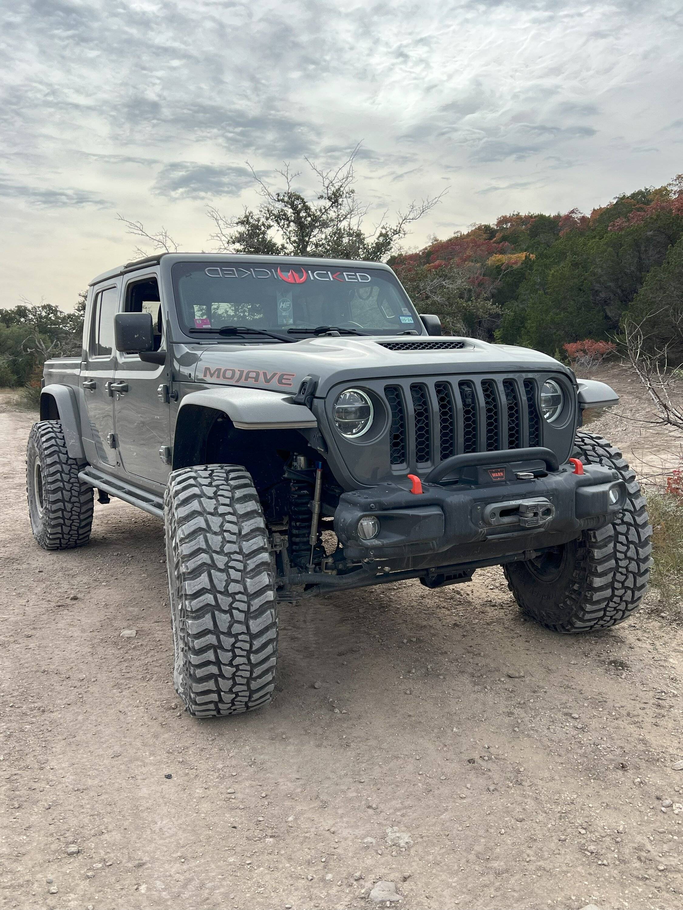

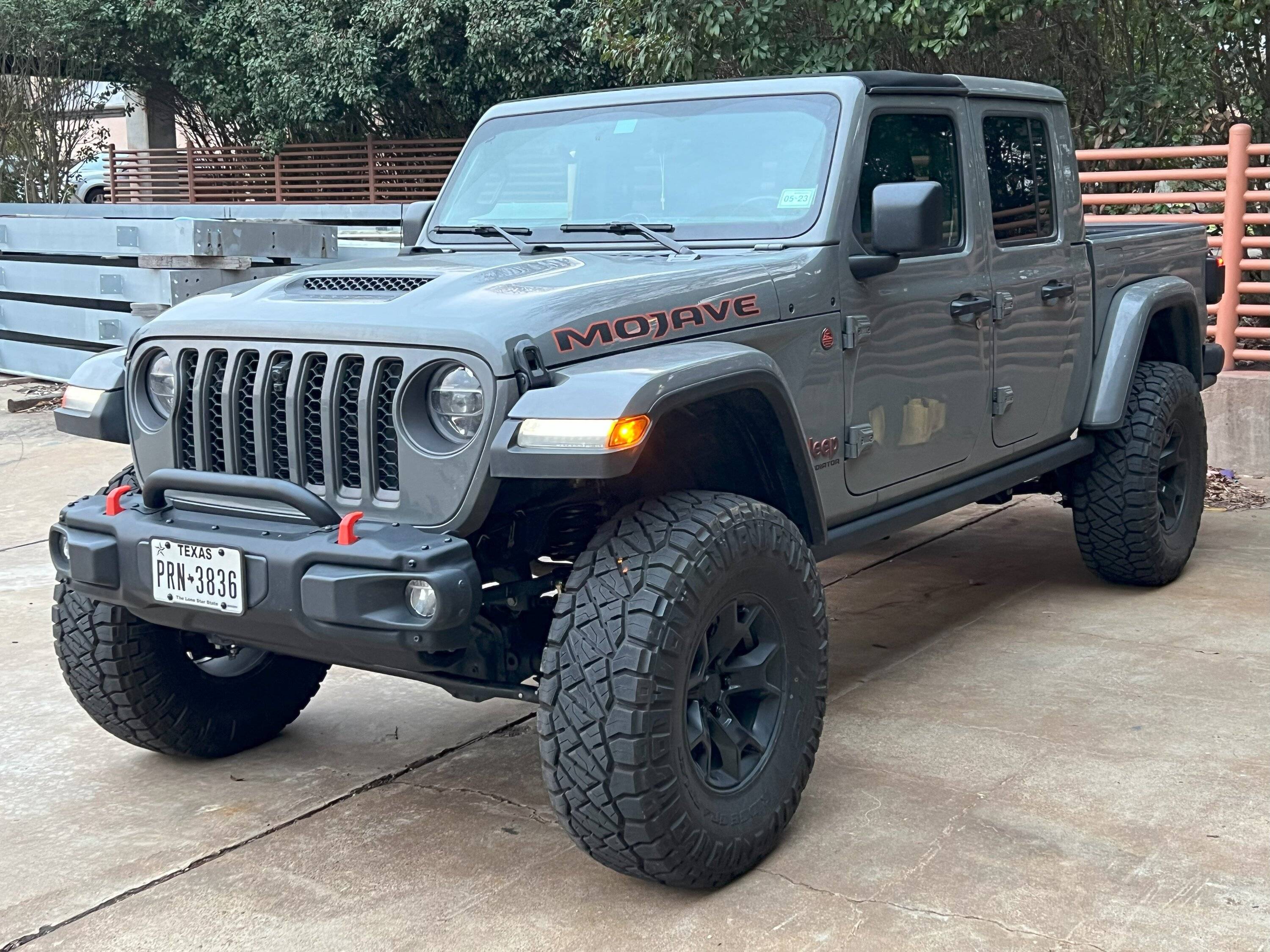

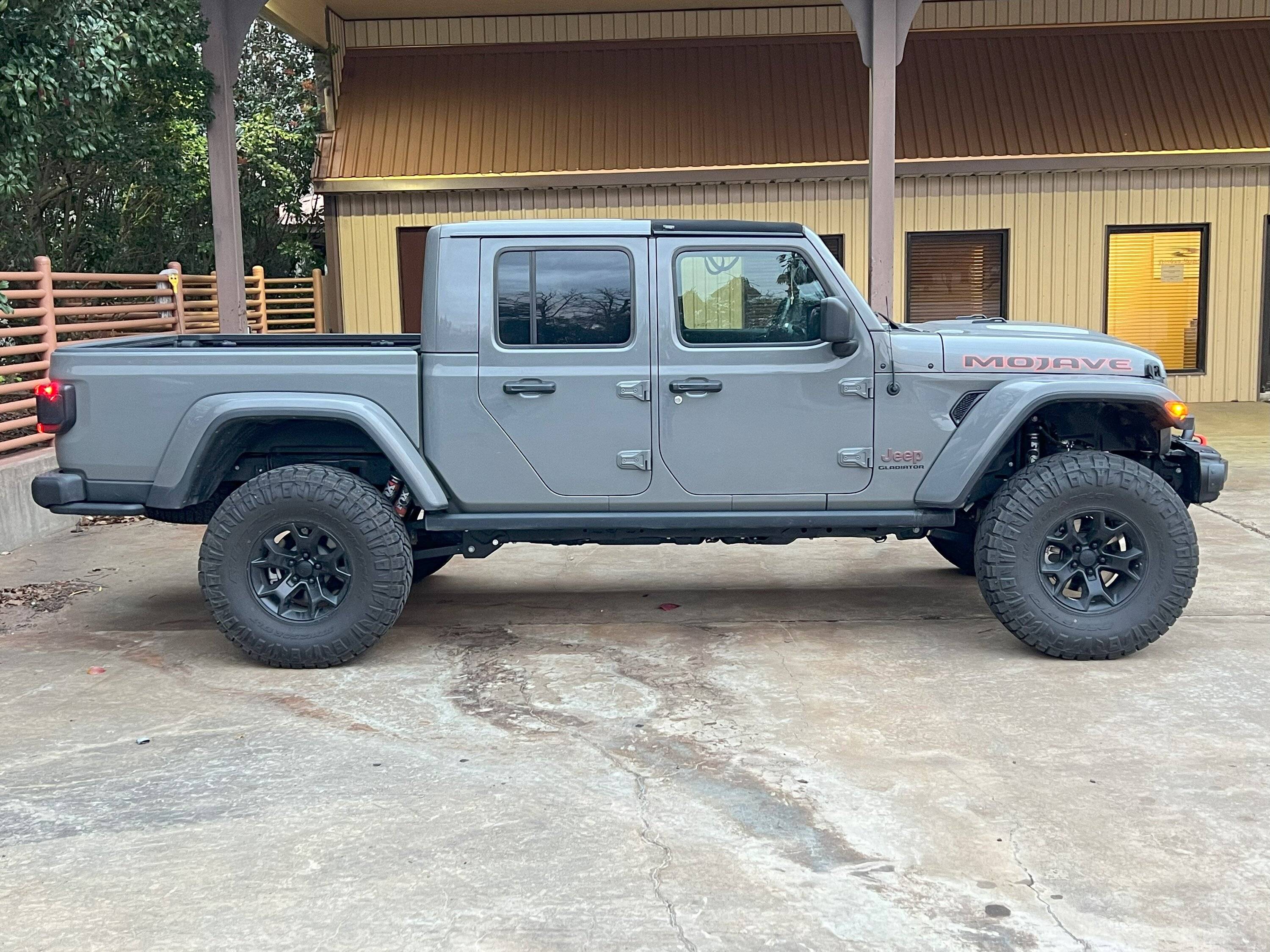

Picture of mine with a clayton 2.5" lift, steel bumper w/out winch, sitting on 37" Nitto's
Same lift with winch and 40" Mickey Thompson tires
Love this set up. With the Clayton, did you keep the factory fox shocks and add shock extensions?
Did you keep the Fox shocks, with extensions??
