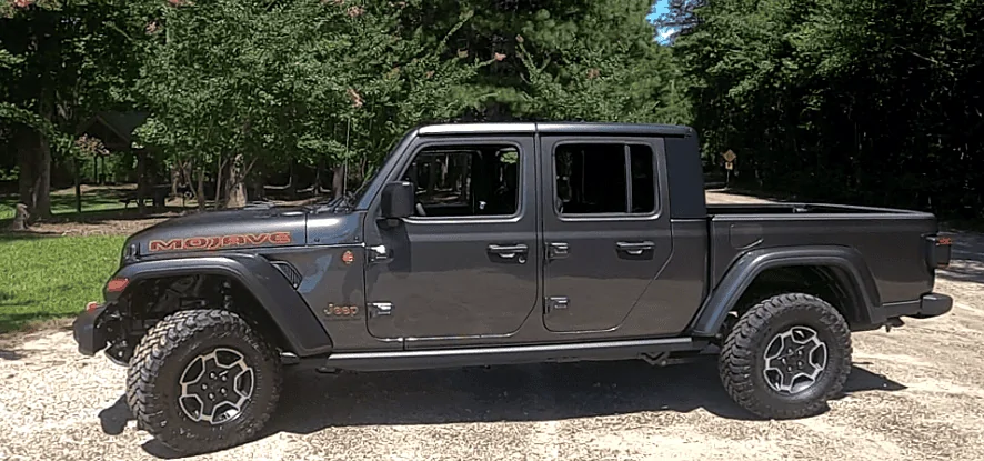

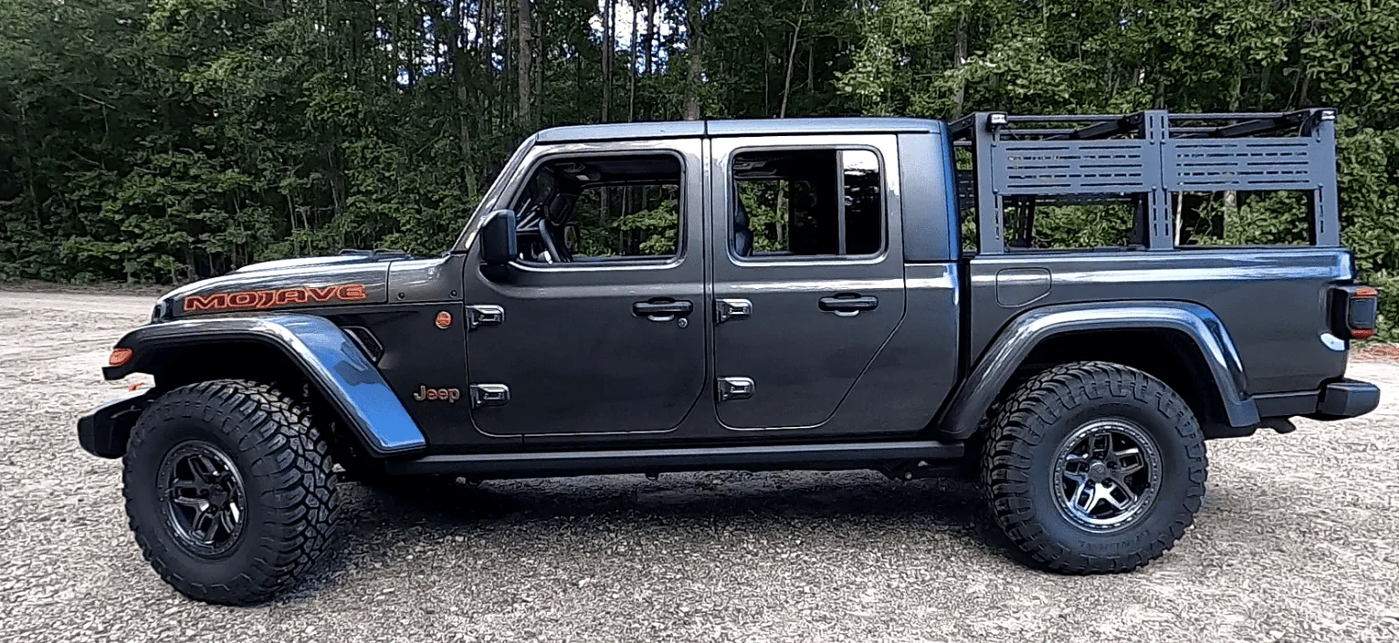

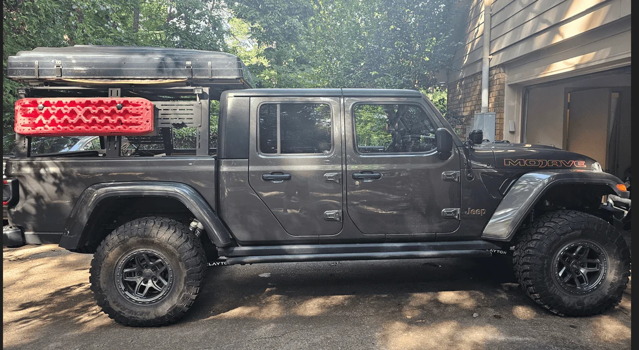

Had my 2.5" Overland+ and Falcon SP2 3.3 shocks installed and just got the truck home yesterday. Very pleased so far. Here are a set of pics of my Mojave over time.
Stock

Added 35" tires and bed rack

After 2.5" Overland+ Lift
Jeep Gladiator Clayton Off Road JT Suspension Systems 1717506502735-d1
I gained 3.875" lift in the front and 2.875" in the rear. We'll see how it settles out.
I was hitting front bump stops pretty regularly on a dip I travel thru regularly. Can't wait to see how that is improved now.
Update 6/11/24: I really like this upgrade a lot. It no longer hits bump stops going thru big dips in road. Took it to N GA mountains this past weekend. When we hit dirt/gravel it was still on setting 2.6 with tires at street pressures. It road quite well. The next morning I put it on setting 1 for the days travels thru the forest. Sooo much better than stock. Not near as much rocking side to side when hitting offset pot holes in the road. Very impressed with the ride. On the way home we were on Hwy 60 thru Suches, GA which is a very curvy drive. With it back on setting 2.6 it felt very planted during left/right/left transitions. VERY happy with this Clayton/Falcon combo.

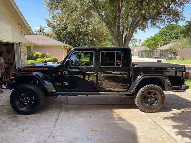

AEV 2" with 35's......want more flex, so going to Clayton 2.5 soon. Not sure if I can maintain the factory shocks with their 2" extensions or bite the bullet and upgrade em?? Would like 37's too, one day.

Just did the Clayton 2.5" and used Metalcloaks extensions which are at 3" for the shocks. It appears to be doing pretty well. If I get a chance I will take some pick of the suspension loaded and at droop.
Since you want more flex, you should get longer shocks.
