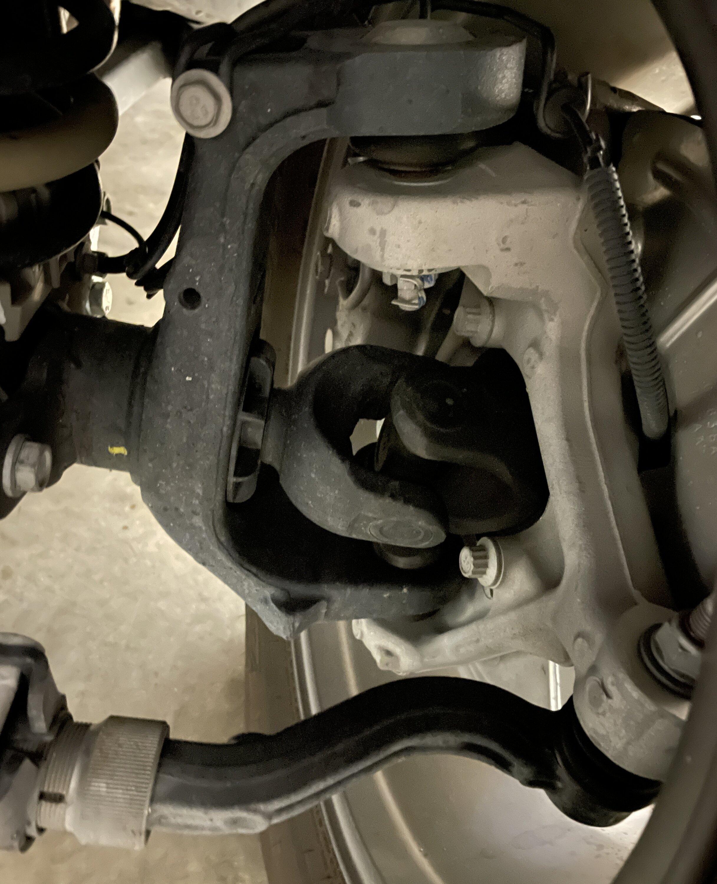

Does anyone else have a clicky - clackey noise from front wheel area when slowly moving and turning like in a parking lot? Drives fine. No issues. It’s just annoying at this point.
I think it might be the brake hardware or maybe the u joints but want to consult the community.

That sounds like a CVJ. Does yours have CVJs on the front axle or U joints?

No noise would be normal. You might double check the axle nut torque.....100ftlb. I frequently find those loose and they really make noise when in 4wd turning.

There is a TSB out for checking the lower ball joint nut torque for a low speed turning clicking noise.
