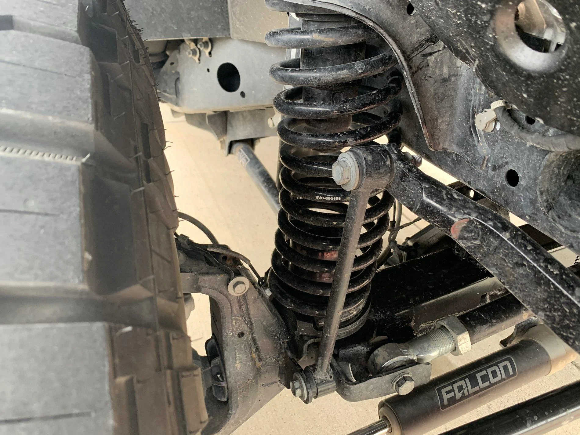

Still looks inward bowed in that pic just like in this pic.
If RK is not seeing this on their lifts then it has to be the end coil wind on the EVO springs causing this. (These have the Daystar pads that came with the EVO kit)
Can RK confirm this is not an issue with their springs? If so I will buy a set to put this issue behind.

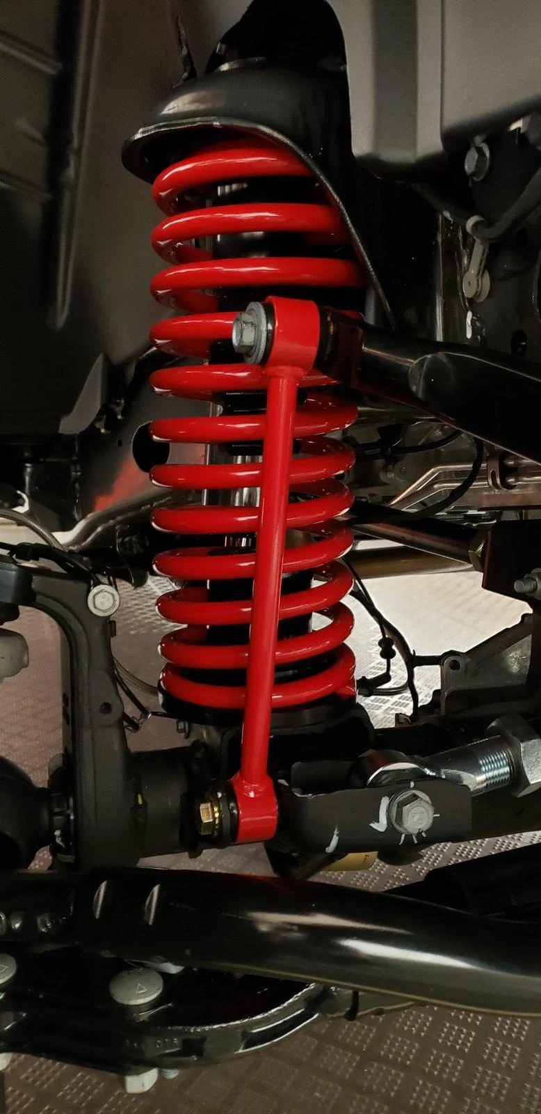

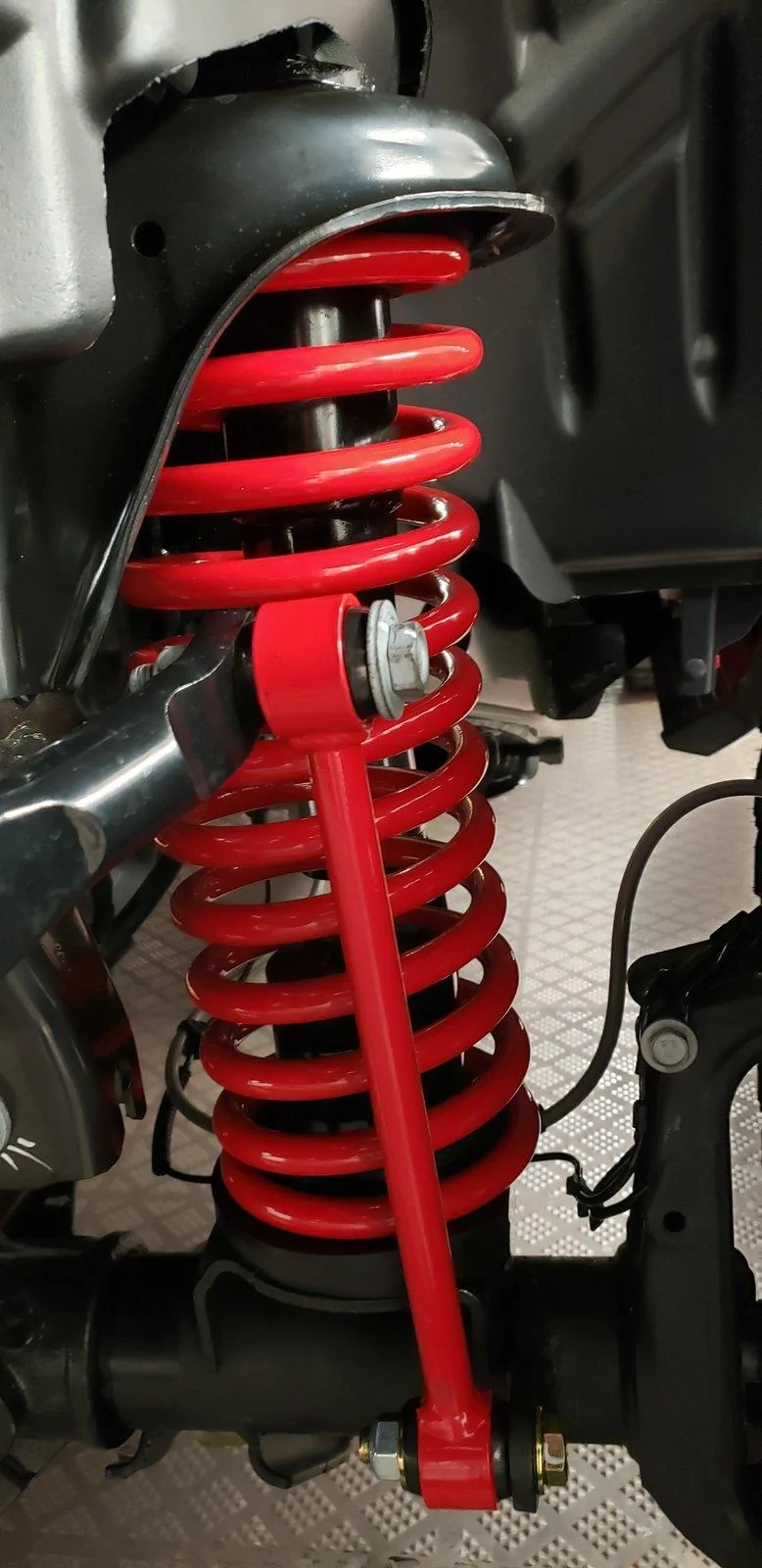

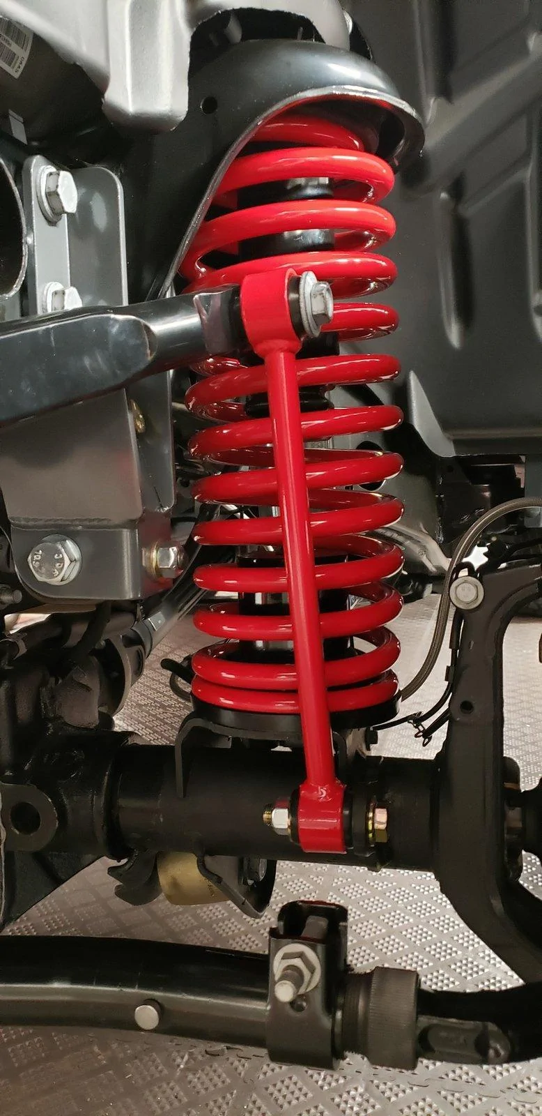

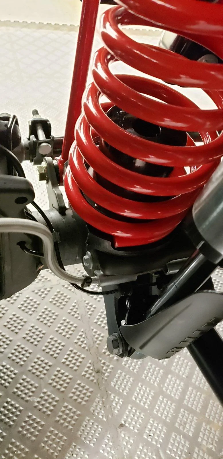

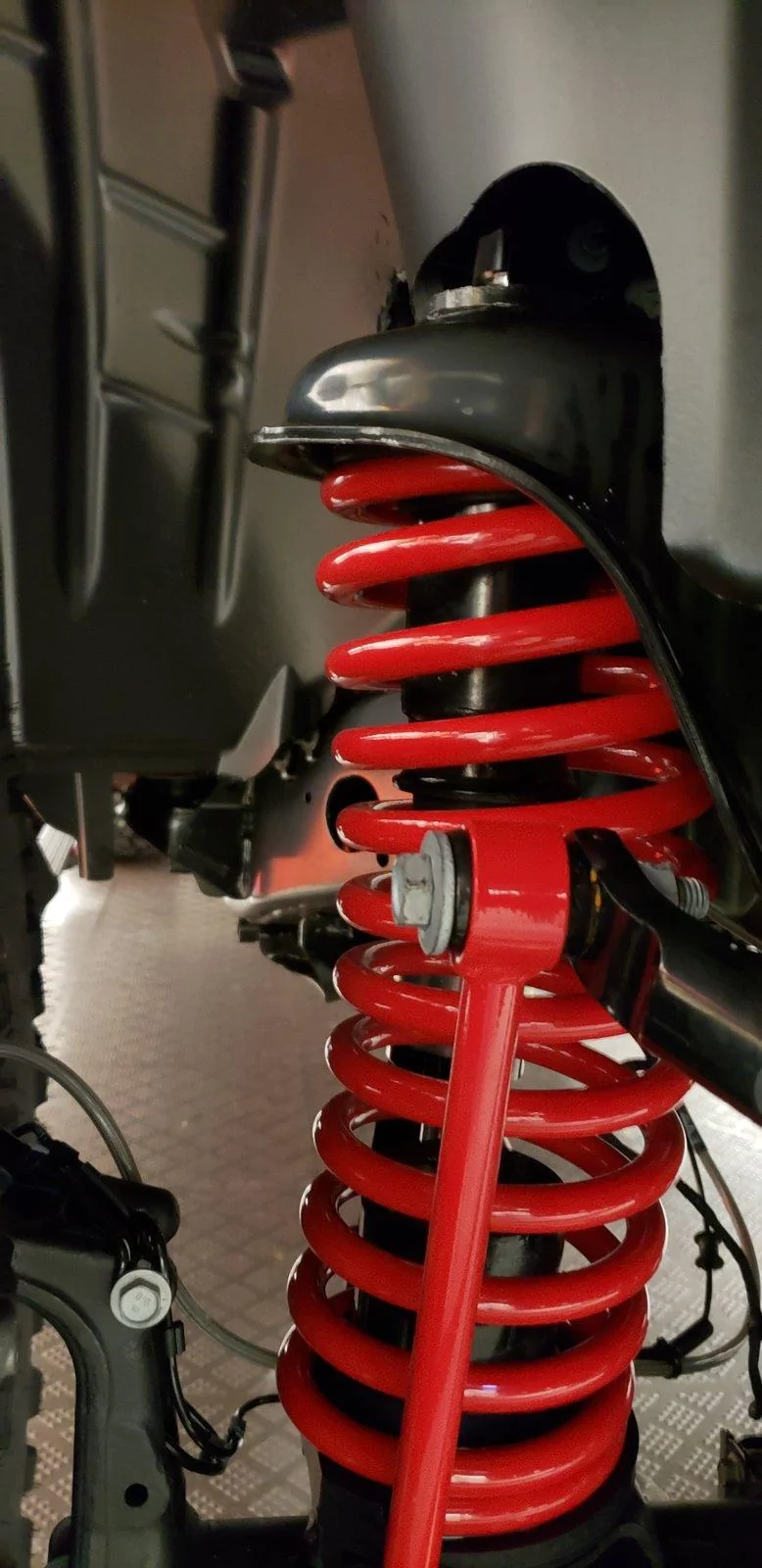

Well, I finally found a way to fix my EVO spring bow.
After spending over $5k for a Stage 4 Enforcer Plus with King shocks, I engaged in numerous phone calls with EVO resulting in them telling me to get a full alignment to fix the issue (as expected, it was perfect; waste of more $$$), maybe rotate the upper isolators to compensate for the bow (WHAT? that's a poor bandaid), and... I should NOT have used the Daystar Isolators that THEY supplied (WTH? OK, the stock units made an insignificant difference...)
So, I might have an appreciation for good engineering and the conversations were not really going anywhere so the search for some good springs commenced and was very successful.
I found the 4" Synergy springs which measured within an 1/8" of the EVOs and spring rates were very close. Another expense to have an acid etch (NO GRIT BLAST) and new powder coat but they looked great. Not to mention labor but it did add more frustration.
Flat grind on the bottom of the springs and flat isolators seemed to be an obvious cure. It was...
The first two pics are the EVOs installed perfectly with the supplied Daystar isolators.
The second set, the Synergy's.
Pretty obvious result.
Height was perfect and ride is excellent.
Live and learn.
